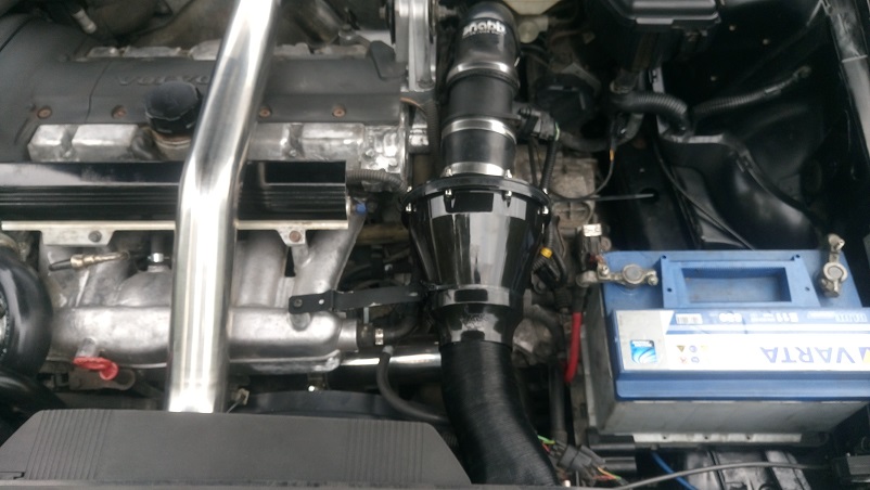

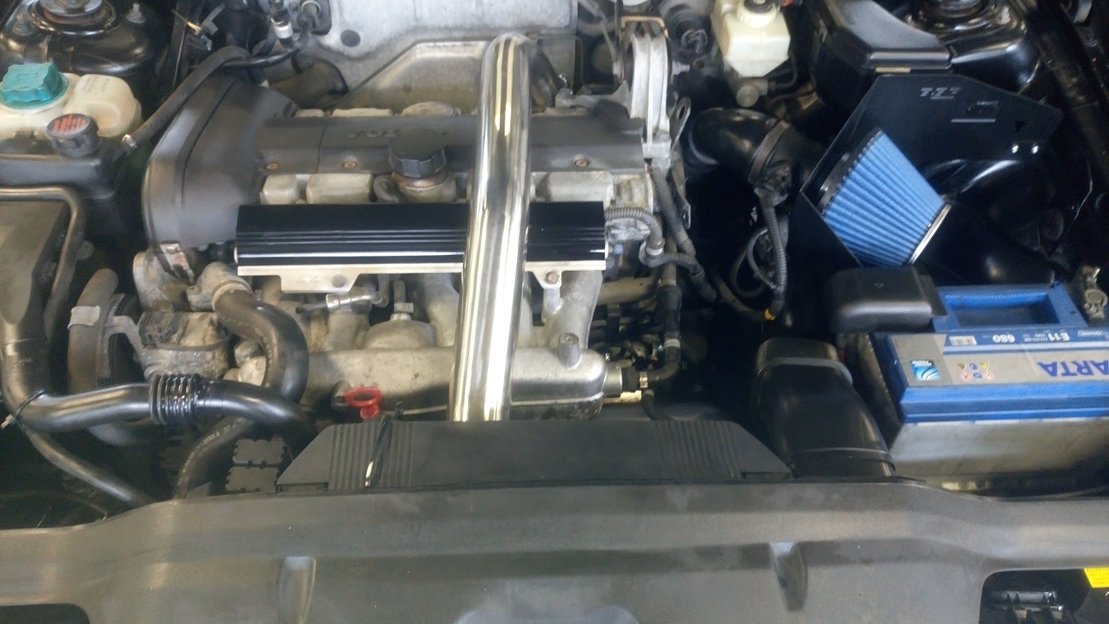

With the new intercooler I also redirected the airflow to a shorter over the engine as you can see on the picture
and the airfilter have a heatshield.

OK, you have a RIP kit in it (Reverse Intercooler Piping). A logical add-on when you're doing an intercooler.
A heat shield on the intake is not the same as piping cold air from outside the engine bay. It'll still suck in hot air, the shield only protects the filter itself from radiant heat. You might be able to adapt the stock tube to it, though. You're interested in the piece that went from the grille to the airbox.
Higher octane does not necessarily mean better for the engine, except that in some brands, the top grade product has better cleaners and other additives in it. What's important is using at least the minimum octane required by the engine - check your owner's manual, in the U.S. it's 90 for a Volvo turbo. Using a higher grade than specified is just throwing your money away.
