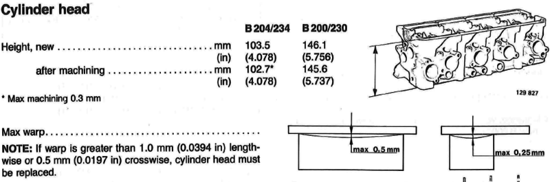

New: 146.1 mmlifeofgold wrote:...minimum cylinder head height to measure the amount of material that has been removed
Min (after machining) 145.6 mm
TP 30927/1 Section 2 (21) Reconditioning Engine B200, B230 740/760 1985-19..

use a 100mm/4 inch long or thereabouts and measure for it not being more than 0.003 inches in that short span. If it is then it will need to be bolted down flat so cam bearings are in line and machined no more than 0.020 inch (0.50 mm) to get flat surface.
These (and many many others) will "bow" when removed from engine and machining the bow flat is not what you want. You are after a head that will seal against block by eliminating any localized warpage from overheat. Usually the localized warp is between head bolt holes under exhaust port and between cylinders in the span between head bolt holes.
