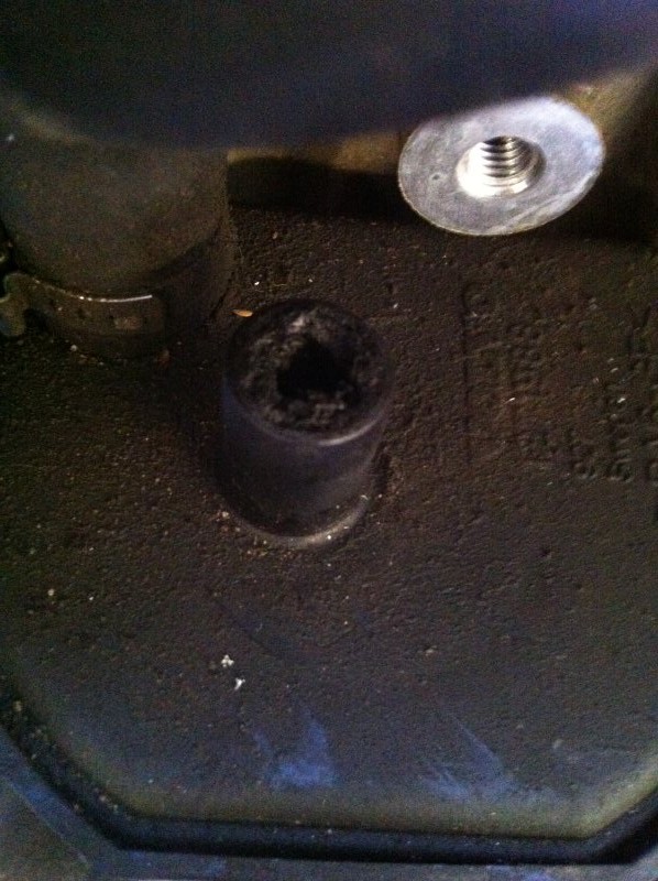

PCV valve - Usually one end goes to the intake manifold to get vacuum, the other end goes to valve cover to access crankcase gases.PeteB wrote:Are there diagrams online somewhere explaining the difference between a PCV and oil trap system?
Oil trap system - Usually one end does not go to the intake manifold, but to the intake box or hose instead, there is no vacuum there. The one end goes to a box that drips oil back to the engine block.
Lots of short drive, not using synthetic oil, not changing oil regularly, not servicing PCV system regularly, old worn out engine, etc.PeteB wrote:I'm not sure exactly what the cause is of the problem.
PeteB wrote: Has anyone thought of blowing the lines out with compressed air, would that push the sludge into
the oil pan or ????
Replace the parts, don't clean.
From two different cars.
I found with the older engines, even with new PCV parts, it is not enough. The stock PCV pipe from the separator to the intake is severely undersized for an older engine. Also, the hole at the heating element at the PTC valve is tiny, like smaller than 1/4 inch tiny. Both will restrict the flow of the crankcase gases.
To address those issues, here is what I do. Get the below parts.
A 3ft 5/8 oil compatible hose. Do not use silicone hose, as it will "sweat" oil. Do not use heatercore hose, it is not rated for oil, it will become soft and you'll have to replace it sooner. This is what I use. Buy 3, as it is sold by the foot.
10 An Push Lok Loc Lock Hose Oil Coolant 5 8? Black 250 P s I Industrial Hose | eBay
One 3/4 elbows from your local hardware store. (5/8 will be the wrong size!)
A 3 feet 3/16 vacuum hose to replace the small hose from the intake manifold to the PTC valve. I prefer silicone hose for this.
Optional, get 6 of this. I like their clamps.
https://www.ipdusa.com/products/4768/10 ... 12mm-width
Optional, wireloom to protect the hose.
Take a unibit and drill out the PTC valve holes to as big as you feel comfortable. I think I drilled mine out to about 1/2 inch.
Remove the intake manifold and replace that stock PCV hose, I cut a short hose and then use a 90 degree elbow, than a long hose to the PTC valve. Replace the vacuum hose to the intake manifold to the PTC valve with the new one. Then reinstall the intake manifold.
All the crankcase gas have to go thru that tiny PTC hole!!!
Installed on car
