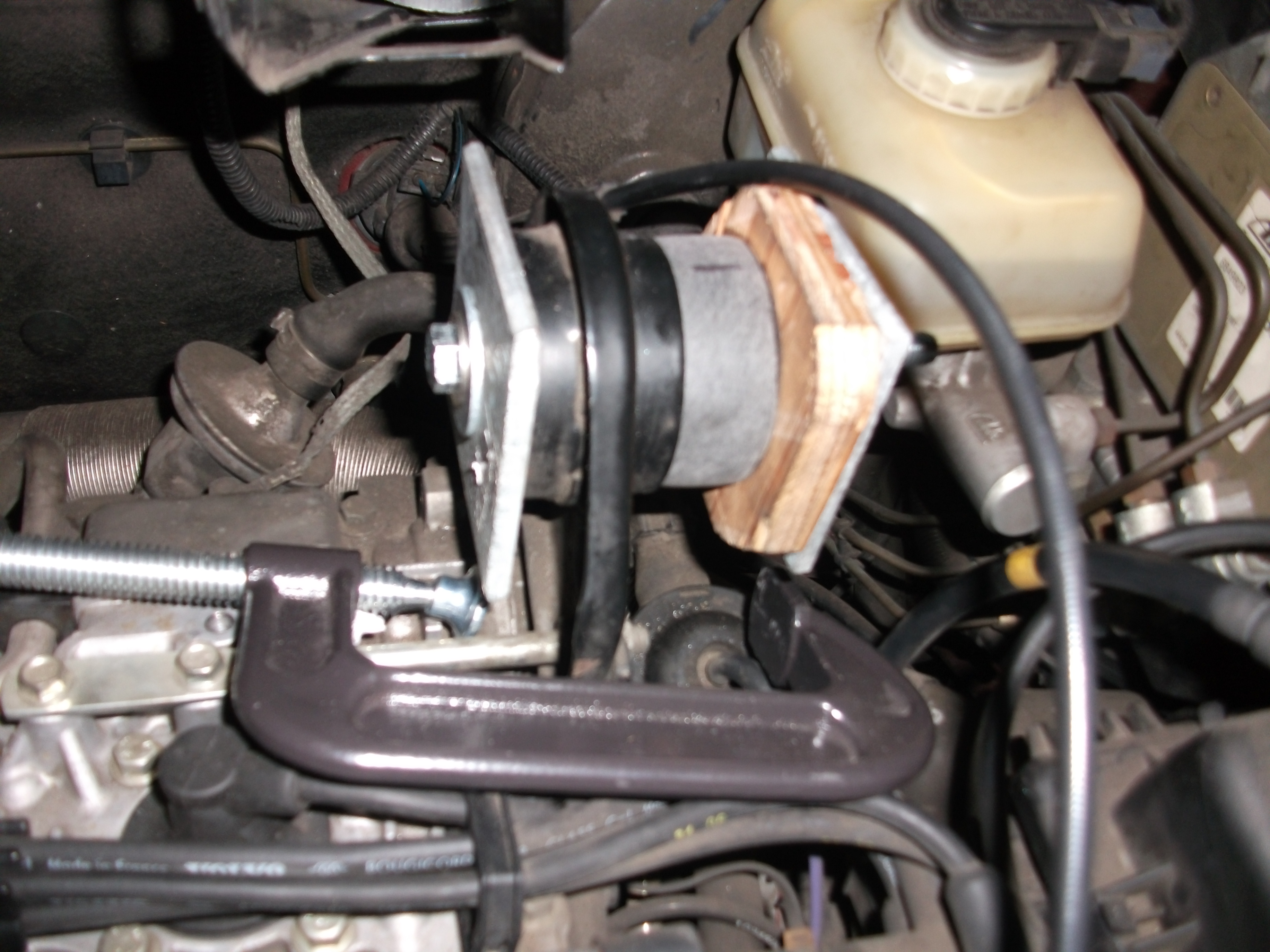

Anyway, once I could confirm that fact, then it became easier for me. I just sanded it down to reduce OD about 1.5-2mm, and afterwards the thing did go in, although still not without considerable effort. I know that effort is the price to pay for a snugly fit mount, so no complaint there. This is my setup in case anyone is curious:

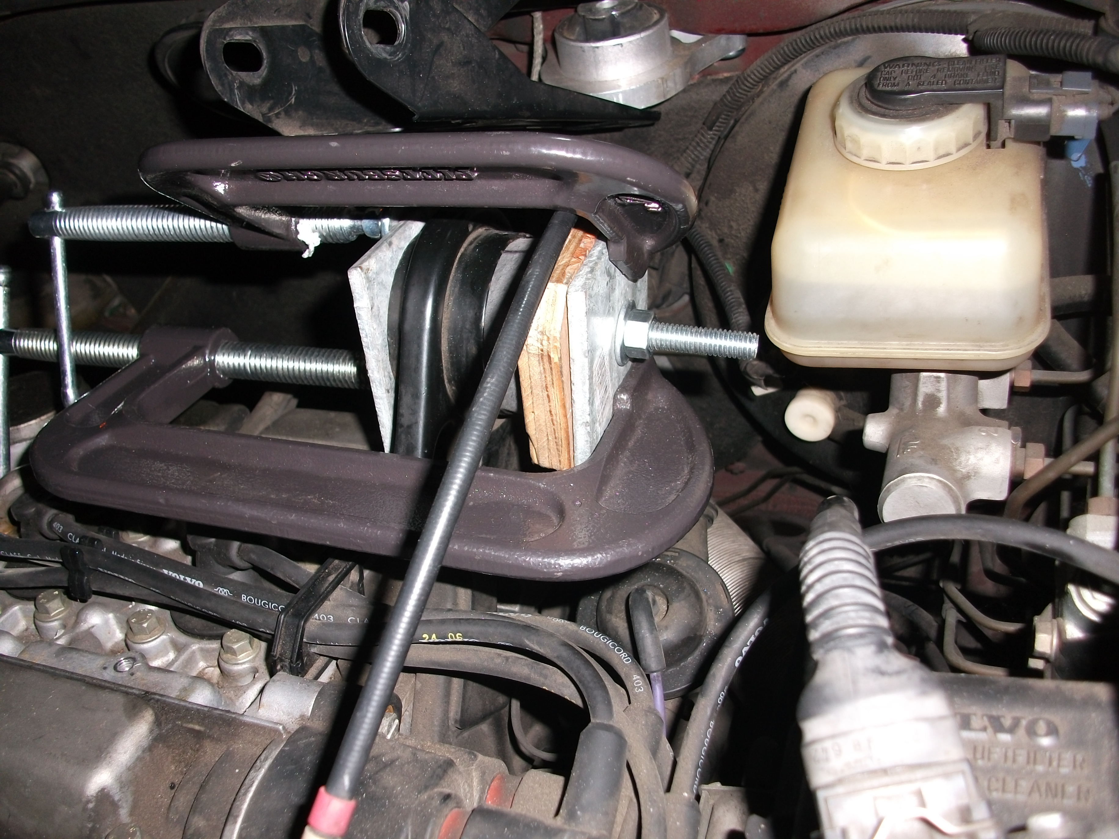

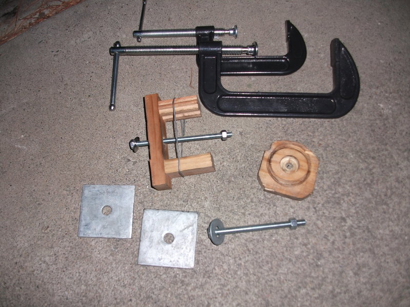

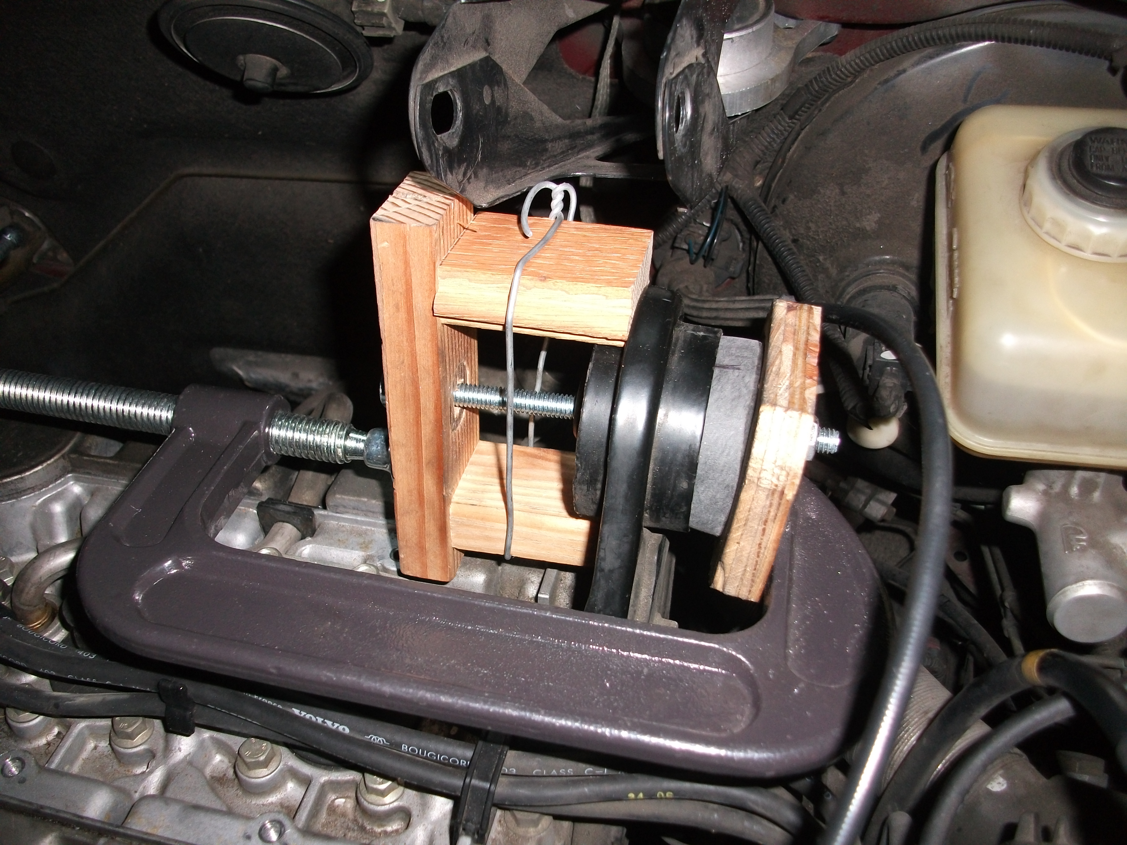

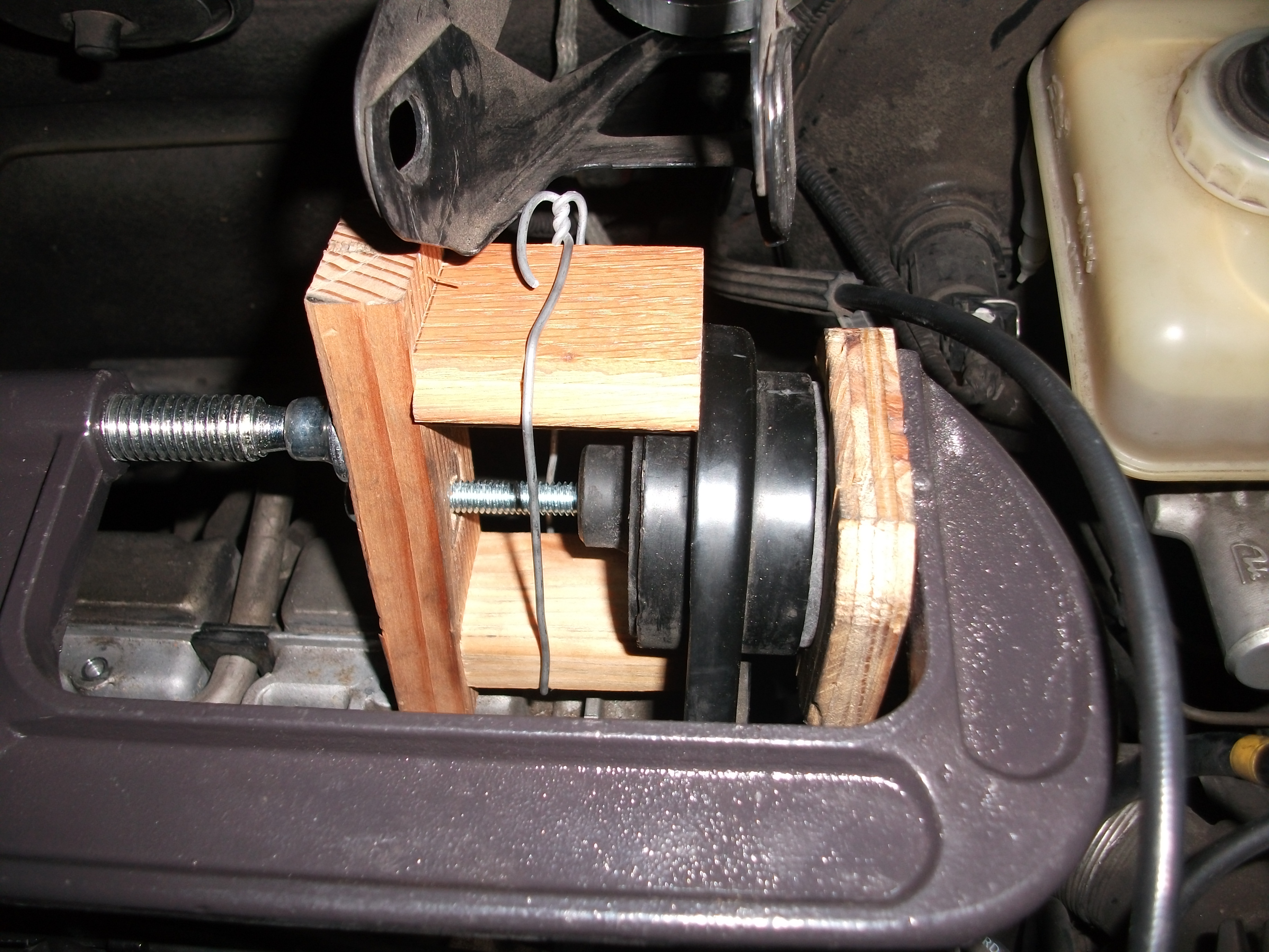

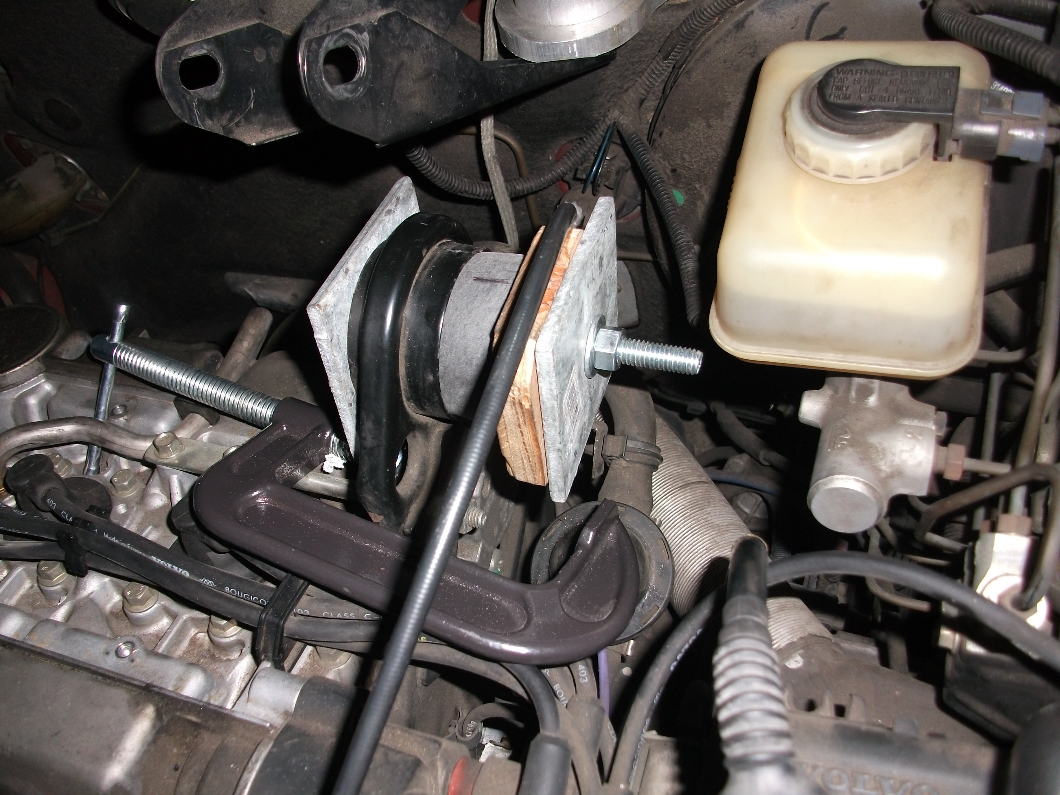

My press tool include 2 1/4-inch thick steel plates with 1/2-inch hole I got from a big box hardware store (I think its purpose is to be embedded in concrete with a rod with thread going through it), a 3/8 hex-headed bolt (about 6 inches long), 3/8 nut, a piece of plywood with a 3/8 hole and countersunk to fit one end of the bushing, a wooden apparatus to use when the bushing is protruding to the other end, two C-clamps (one 6 inches long, one 4 inches long). The two legs of the wooden thingy have different length depending on which part of the bracket they press against, and I also used hardwood (oak) for the wood to ensure they don't easily dent, break or split. I find the C-clamps useful to hold the plane of the plates in place when you're pressing, because otherwise the rubber tend to "slip" and become crooked in the beginning and not sit straight through the hole. Sometimes it may also be easier to press with the C-clamp (press the top, then bottom, then top, then bottom) as oppose to turning the nut to press from the center.
Making some progress:
From another angle:
With the clamps:
Replaced the metal backing plate with the wooden piece so the bushing can come out on the other side:
Just before being done and dismantling the apparatus:
