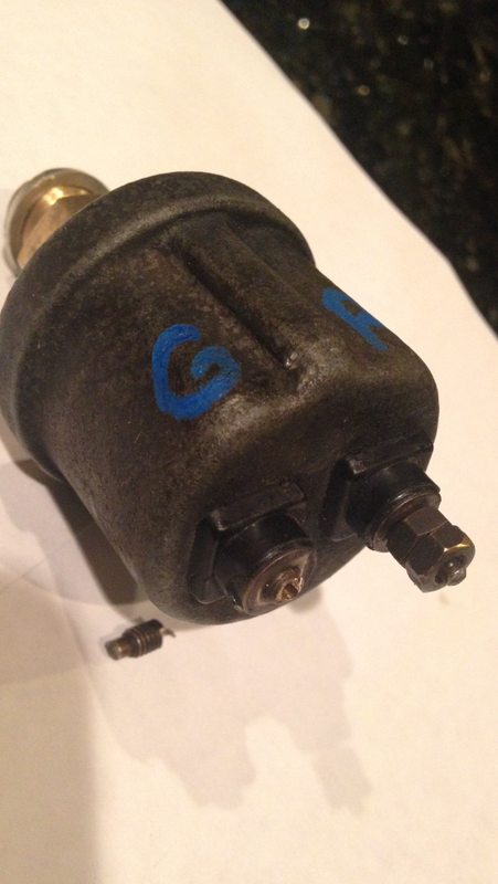

hello everyone, i was finishing up installing a 5 bar pressure gauge in my 1991 240. I thought i was homefree until i broke off the small screw that connects with the green wire going to the actual gauge. Any ideas if and how i can fix this? as you know these sending units can be pricey and hard to find in the salvage yards. it looks like there is a small wire going thru the unit to the screw. is there any way i can get into the unit and repair it?

Hi, I've suffered the same fate. I was working on an alternator and ground wire replacement and snapped off a terminal of my oil pressure sending unit. Local auto parts supplier ran above numbers to no avail. Is there an egauges.com equivalent? Or another substitute? Thanks.

VDO most likely was the original manufacturer. Of the two VDO products listed above 360-081-030-033C is a valid number in their catalog. Can anyone verify fit? It's a 5-bar with M14 x 1.5 threads. Thanks.
detroitbrick
- Posts: 9
- Joined: 01 Sep 2017, 08:07
- Year and Model: 1991 245
- Location: detroit
OK. Talked to VDO tech support. No definite answer. The suggested I contact www.kienzle.de, their european distributor.
Before I go that route however, I want to check out a couple things with MVS about this.
I found a VDO sender 360-028. It's 80 PSI/5-bar, has M14X1.5 threads (is that the correct thread?) and has 10-180 Ohms resistance.
Does this thing tick all the boxes? The VDO numbers in the op are NLA. Thanks.

VDO Gauges 360-800 comes with the adapter fittings. From what I've noticed M14x1.5 threads are nearly the same as 1/4" NPT. Just as M10x1.0 is nearly the same as 1/8" NPT. So an adapter bushing for 1/8" NPT to 1/4" NPT may allow a new sensor with 1/8" NPT threads to fit a M14x1.5 straight thread using the stock copper sealing washer.

The VDO website doesn't recognize "360-800". The Volvo part numbers, 3417000 & 3427000-1, can't be cross-referenced by VDO.
If the OEM part's characteristics could be established then a comparable replacement could be ordered, so VDO told me. The only 5-bar VDO sender with M14x1.5 threads they offer is 360-028. Can anyone confirm if this will work? BTW I have a '91. It seems the mounting hole in the block would be metric. Please correct me if I'm wrong.

360-028 is available from www.egauges.com and appears to be what you're looking for
