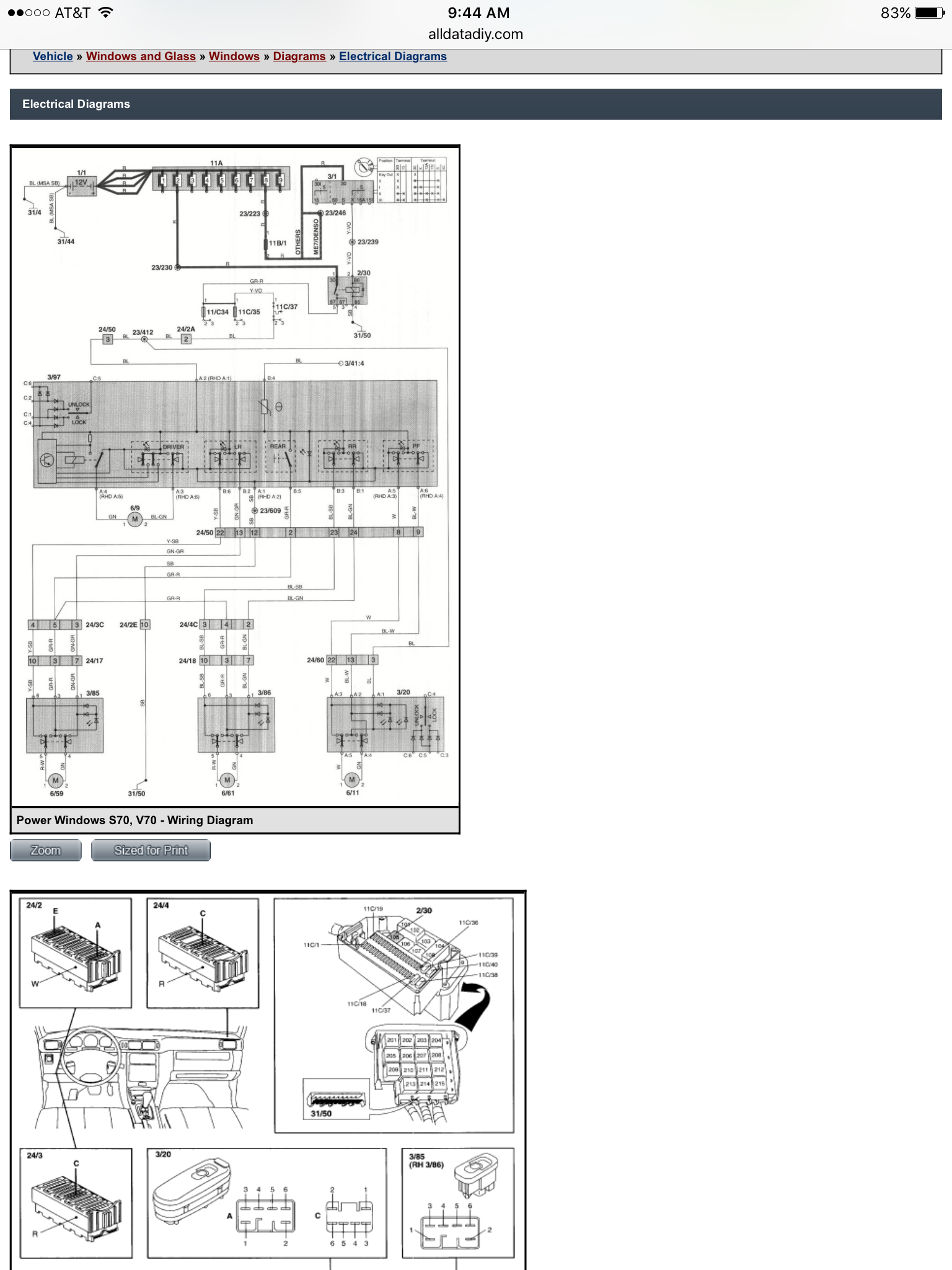

We should also look at the wiring diagrams to see if the connectors will work.
Changed thread title fir search
Here is the V70"switch. 3/97 is the main switch
- Posts: 36145
Opinion. After looking at the functionality here I doubt this swap will work

The S/V's have a bare bones, switch contact based system.
The C's have a much more elaborate electronic set up
with different resistive values sent over one wire to the
window/top controller for up and down operation.
The bottom line is that the switches are completely
different under the skin and are not compatible.
- Posts: 36145
It looks too complicated to just add/drop the window function , but that's just one Richards opinion
If you can find the C70 wiring diagram on the web we can compare switches and figure this out.
