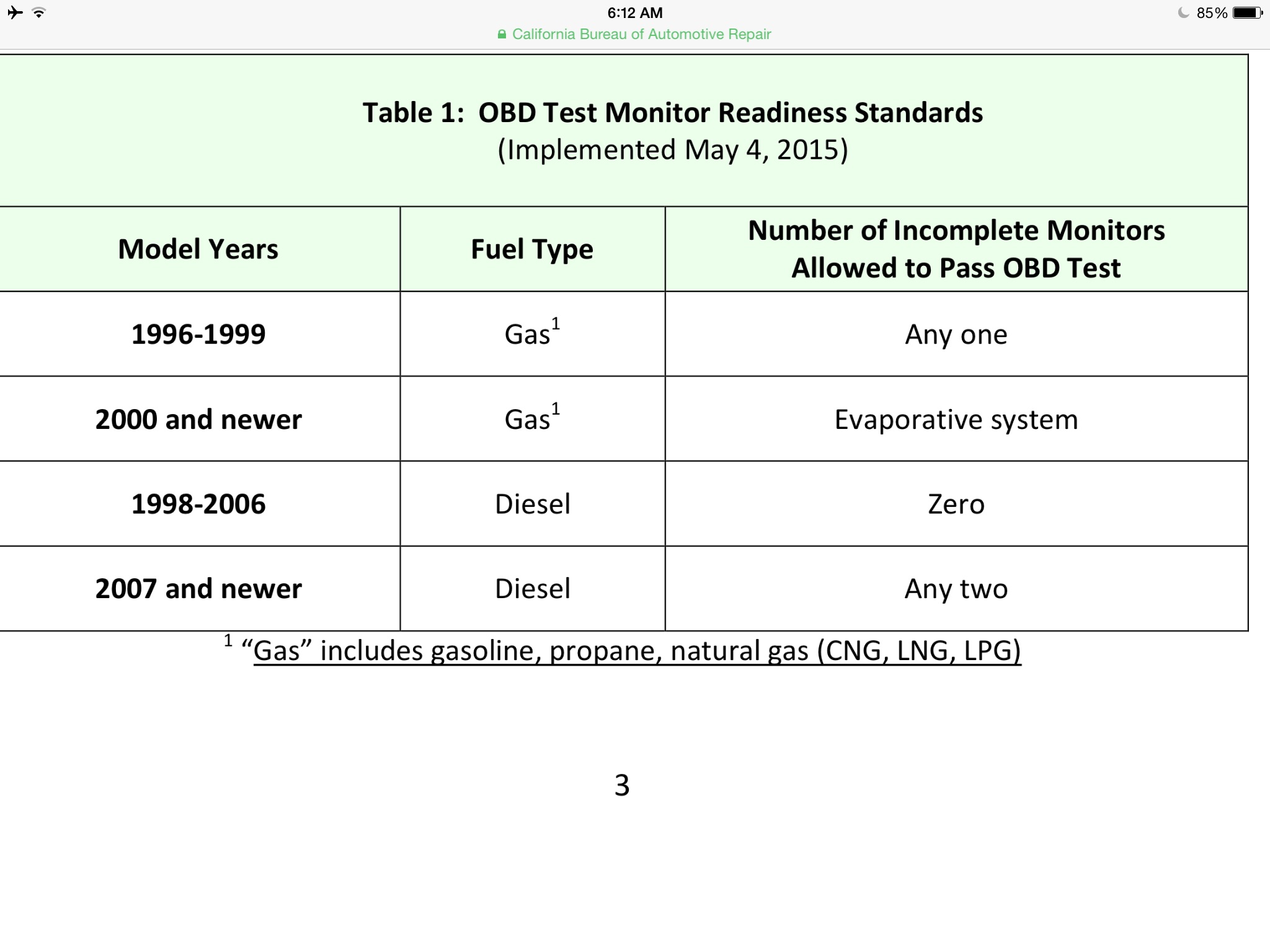

Hmm, not the EPA letter, but it appears this is what's referenced for CA:
https://www.bar.ca.gov/pdf/Smog_Check_O ... _Guide.pdf (page 28)
'97 850 GLT Wagon- Driving to see 300k in the rearview

Just to clarify, in the states , the EPA issued a ruling that :
model years 1999 and earlier can have up to two monitors not ready
Model years 2000 and one can have one monitors not ready.
Generally you can pass your Inspection if your CEL is off with 1 or 2 monitors not ready
It looks like CA is following a slightly different approach per the document above, date Sep 2016
1999 earlier...any one monitor not ready
2000 later...only evap can be not ready
CA readiness rules SEP2016
