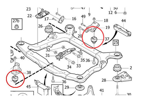

What are the symptoms of bad front and rear mounts? Specifically the 2 mounts circled in RED?
Good question. I'm wondering about that also. I have been wanting to learn the condition of my hydraulic mounts by looking at them, so I finally made time to do that. They looked pretty much OK but maybe deflated. I've changed out the same one you have AND the fwd bushing on the top drivers side mount.
The symptom I'm having is a very buzzy vibration on acceleration that stops immediately when I take my foot off the accelerator. I can feel it in the accelerator and floor pan. I can make it almost resonate by finding a certain speed and staying there.
I figure that old engine mounts are the cause but don't really know. They are a little too hard to replace to just do it to see what happens. I suspect that new ones would improve things ... the question is how much. My Honda Odyssey Van needed new engine mounts at about half the mileage and a third of the age of my V70. That's my only point of comparison.
