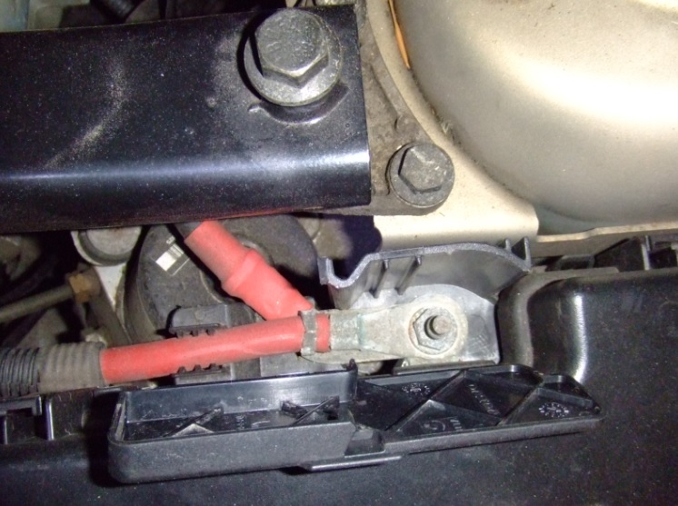

I have this connector on my non turbo, near the left strut tower under a small cover. Never disconnected these, but I know I can jump start the engine if the battery goes flat and, say, I can only access the car from the front end.
Side note, I always keep the ignition key in position II when disconnecting/reconnecting/jump starting the battery
- aaa.jpg (131.25 KiB) Viewed 1188 times

Disconnecting that won't isolate the battery from the car, though. It's essentially in parallel with the battery
