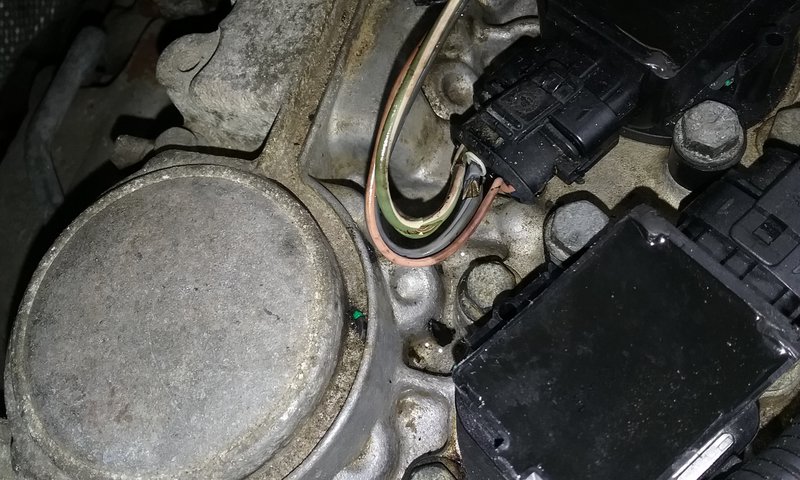

So I've been trying to track down this intermittent misfire for the longest. I thought I had it yesterday when I found a vacuum hose that totally collapsed when motor is pulling vacuum. I replaced hose and it ran great until this afternoon. Anyway after quite a bit of diagnostic work i found an issue with the coil packs harness/plug wiring to cylinder #4.
The outer wiring loom was brittle and fell apart during removal. If you can see in the pic the actual insulation on each wire has hardened over time is breaking apart leaving the wiring to cross each other and short out that circuit. Anyway has anyone ever purchased the coil packs harness? How much did you pay and where'd you find it?

You should get to the PnP and buy couple of coil connectors for a buck or two, then splice them in with either good crimps or solder.
That harness new will break your 401k

That's a good one .abscate wrote:You should get to the PnP and buy couple of coil connectors for a buck or two, then splice them in with either good crimps or solder.
I repaired the connector wiring, covered in high temp electrical tape and the replaced the wiring loom that was falling apart around the coil pack harness. Unfortunately I'm still having an issue with cylinder #4 and cylinder #5 has a slight miss with a random misfire code. Only other thing I could scan was a Volvo factory code 928c, the definition was vague control module communication problems. I'm not sure what that means, I hope it doesn't mean the control module is failing. Any clue?
