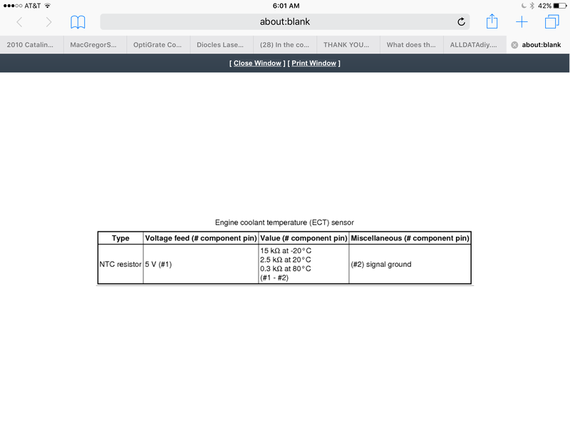

The next thing I want to look at is that coolant temperature sensor. Hey abscate, might that ECT you mentioned be called an IAT by Volvo. Is this it, item number 3 in this diagram? http://www.volvopartswebstore.com/showA ... lYear=2004
If so, can someone please point me to a temperature/resistance chart for that sensor? Or is there another way to verify its accuarcy? Is this a data point that might be read with dice/vida?

- Posts: 36147
This is for my 2005 which I think is the same.
oragex called it first. Replacing the battery did the trick. Cranking time went from more than three seconds to about one. It only cost another twenty bucks to get a modern AGM battery with more cranking amps.
First I changed the oil because it was about time, staying with Mobil 1, but going to 5-30W from 10-30W. That made no noticeable difference, but thanks to cookie-the-sweed for the advice.
I was also able to verify the ECT sensor with abscate's chart. I read about 4kohm at 10degC.
