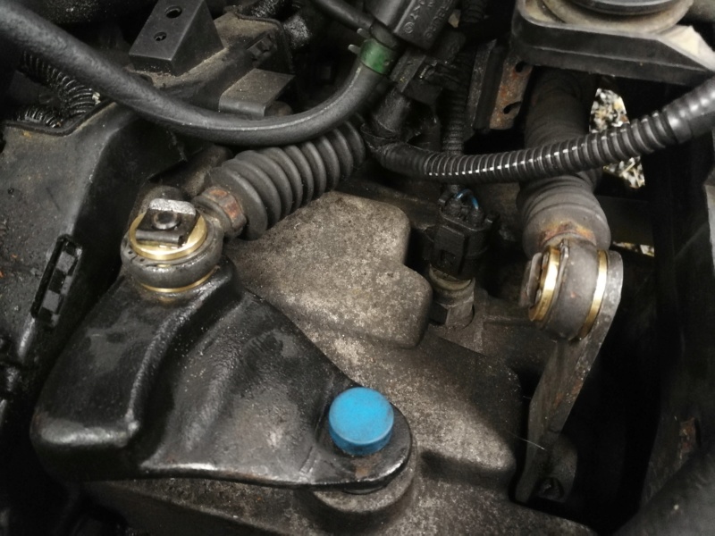

New shifter cable bushes, the difference make them really worth the money !
I used MR2/Celica ones because they were cheaper, fitment is perfect

Tres bien!
Goupil, can you give us the part numbers and source so we can document these please!
Volvo will only sell the entire shift cable at about $150 USD when I last looked into this.

Bought mine here, cheapest I could find with shipping to France
https://www.ebay.com/itm/Toyota-Celica- ... 2749.l2649
In the US you can get those
https://www.ebay.com/itm/VOLVO-BRASS-SH ... 0730473309
or Snabb
https://www.fcpeuro.com/products/volvo- ... escription
I know some people replace them with skate bearings as well (Robert DIY did it in one of his videos). There's also some delrin ones around
Can't seem to find a part number, I guess Volvo consider them part of the shift cable ?
