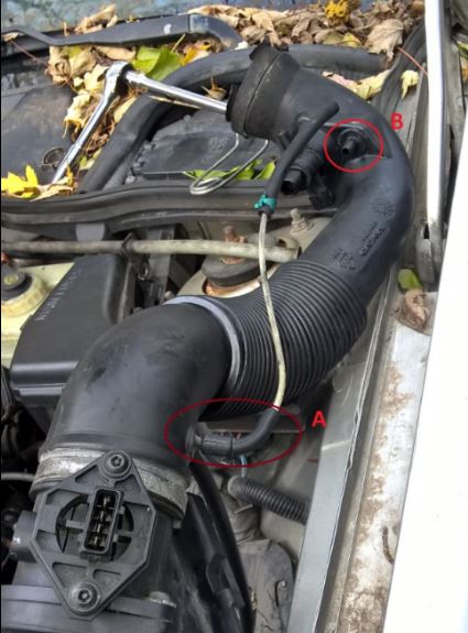

I guess I've been sloppy while tagging which hoses ends goes where, leaving me with interrogations about some hoses routing (looks like an issue for many).
first:

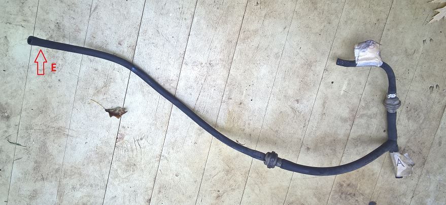

I believe the hose end labeled ''E'' goes into the nipple labeled ''B'', is that correct.
Also, I have no idea where the other end of that white rigid hose (''A'') goes, so a little help would be welcomed.

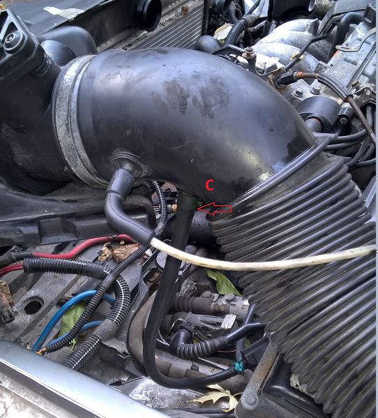

I think that the the arrowed hose ''C'' is the fresh air hose coming from the turbo solenoid valve. That's how I connected it, just need confirmation.

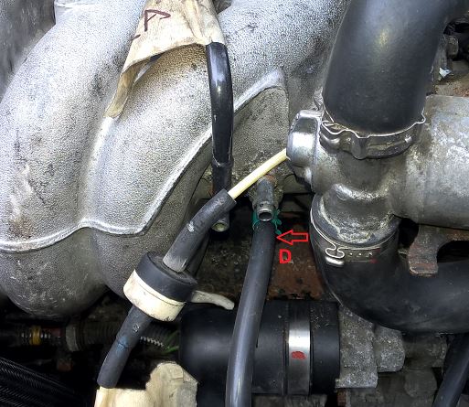

The hose ''D'' that I connected comes directly from the turbo bypass valve, Is that correct.

D I know: yes you are correct.

thanks guys, looks like I got what I needed.
Looks like the routing was good and the small hard white hose goes to a super small nipple on the cooling pipe beneath the exhaust manifold, the nipple is right under the camshaft position sensor.
