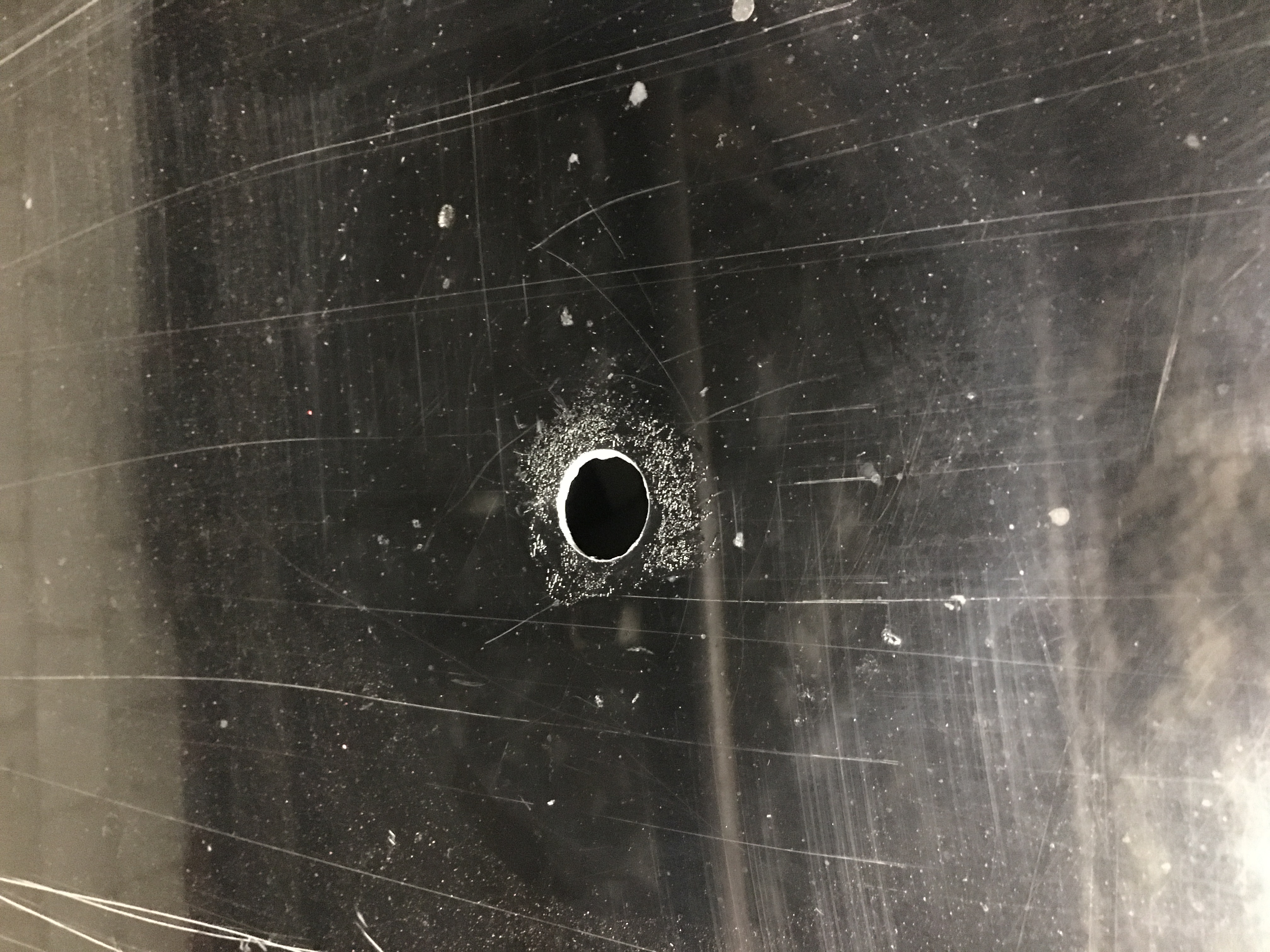

After thinking about it some more, I think a nice flush mount NMO connector drilled through the roof with wire run across the headliner and into the passenger side door pillar trim and under the dash would be ideal. This way I can use the shortest run of antenna wire to the unit.

As far as the hole in the roof, I don't see the big deal. Mine is a non-sunroof model and it's already scratched up pretty bad up there. I think the NMo mount is the best way to go for reasons of being able to disconnect the antenna easily and puttin a little rain cap over the mount which won't take away from the roof rack functionality. I do use my roof rack quite a bit.

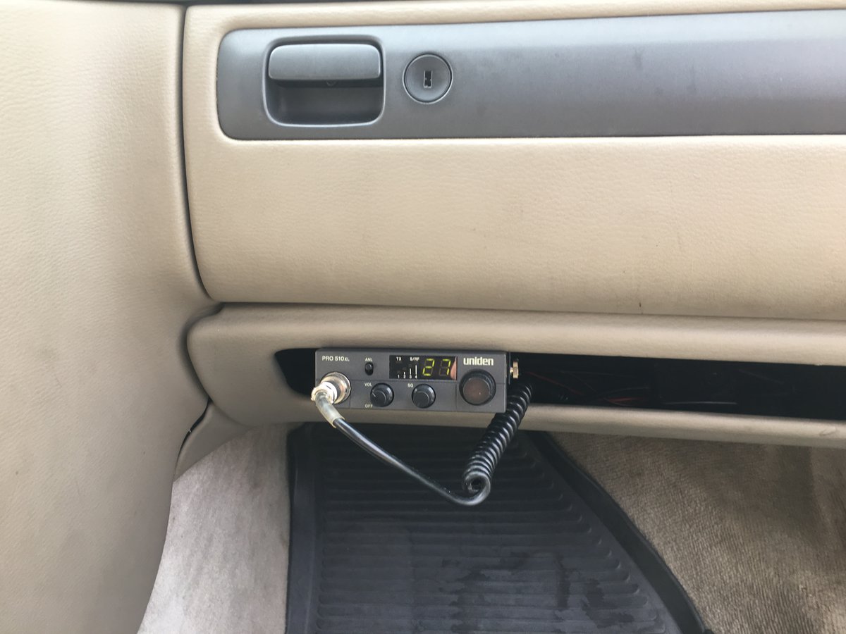

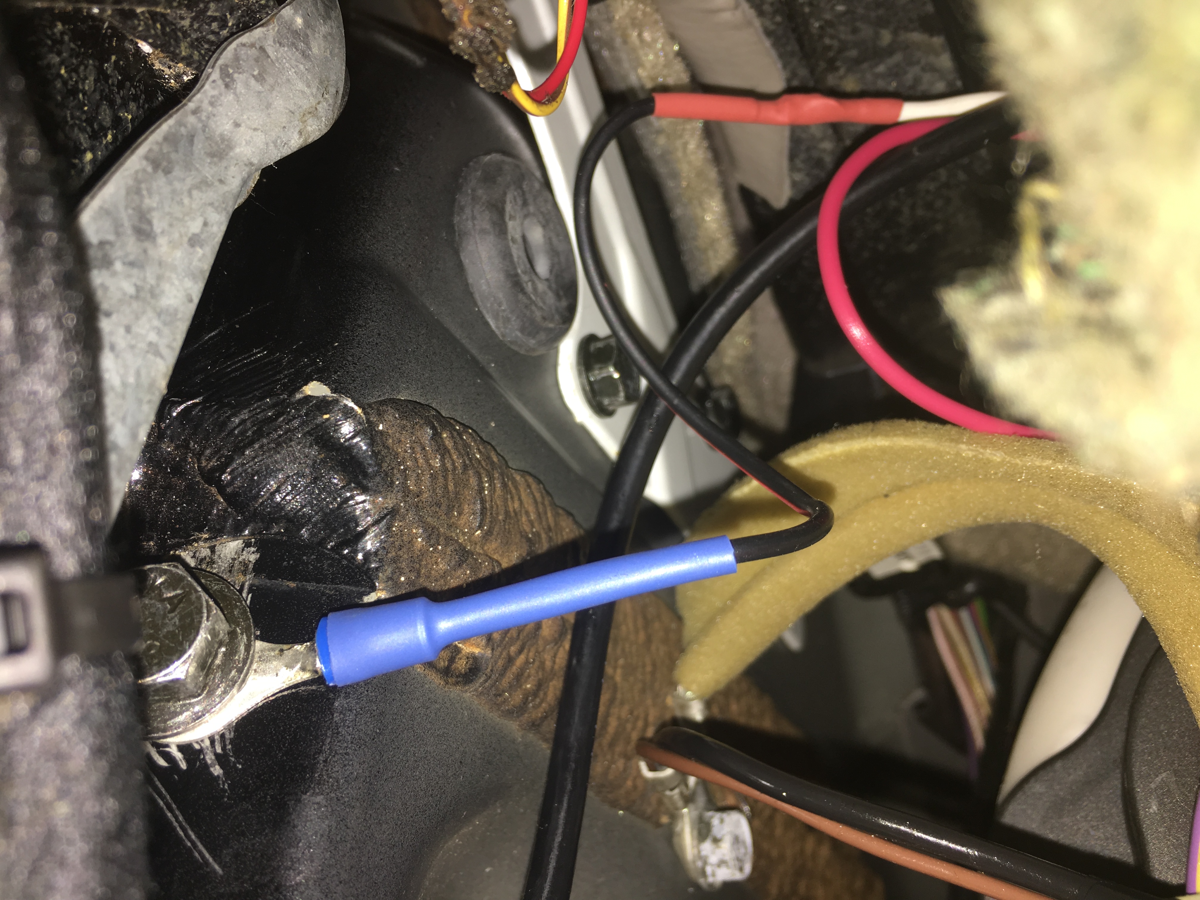

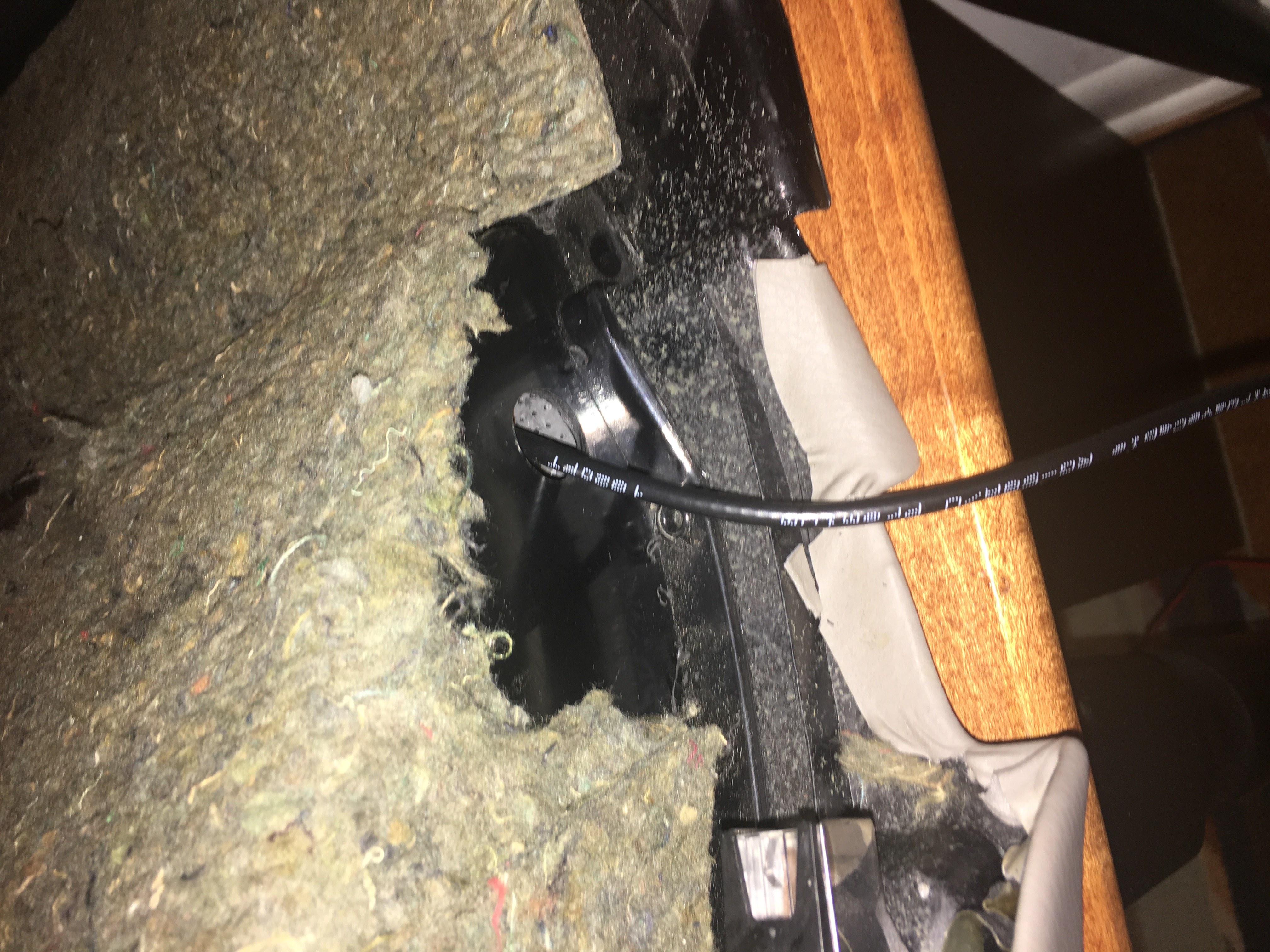

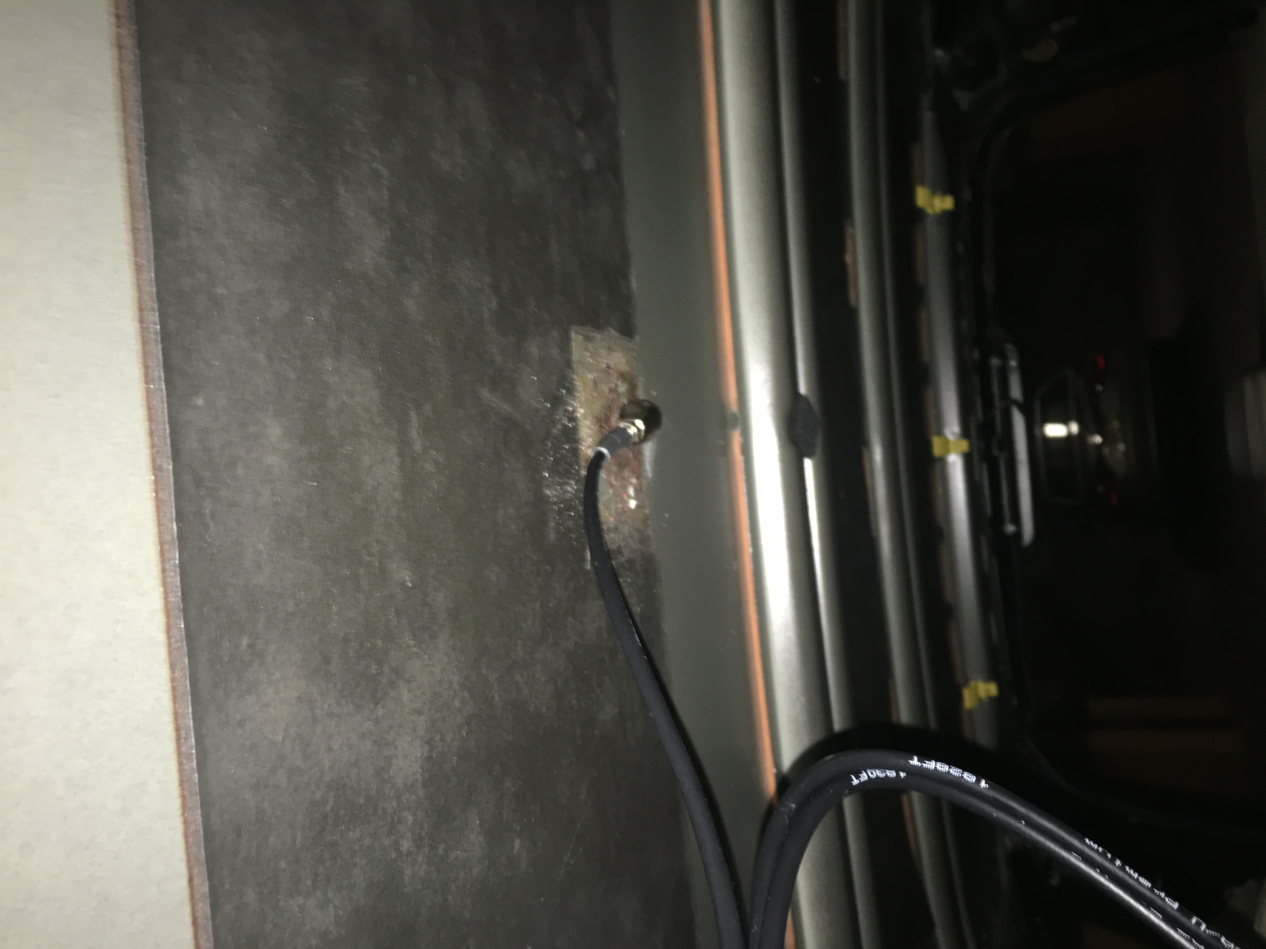

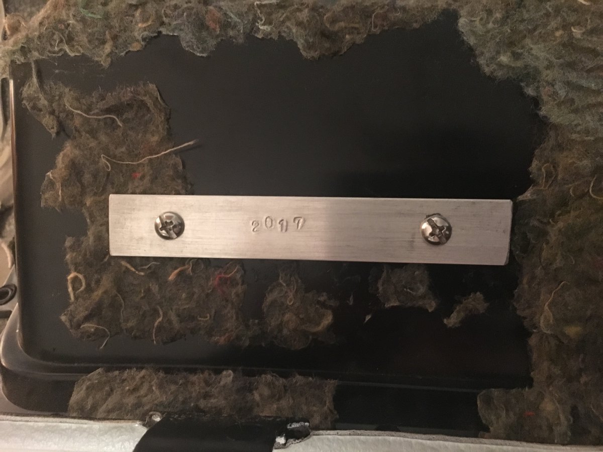

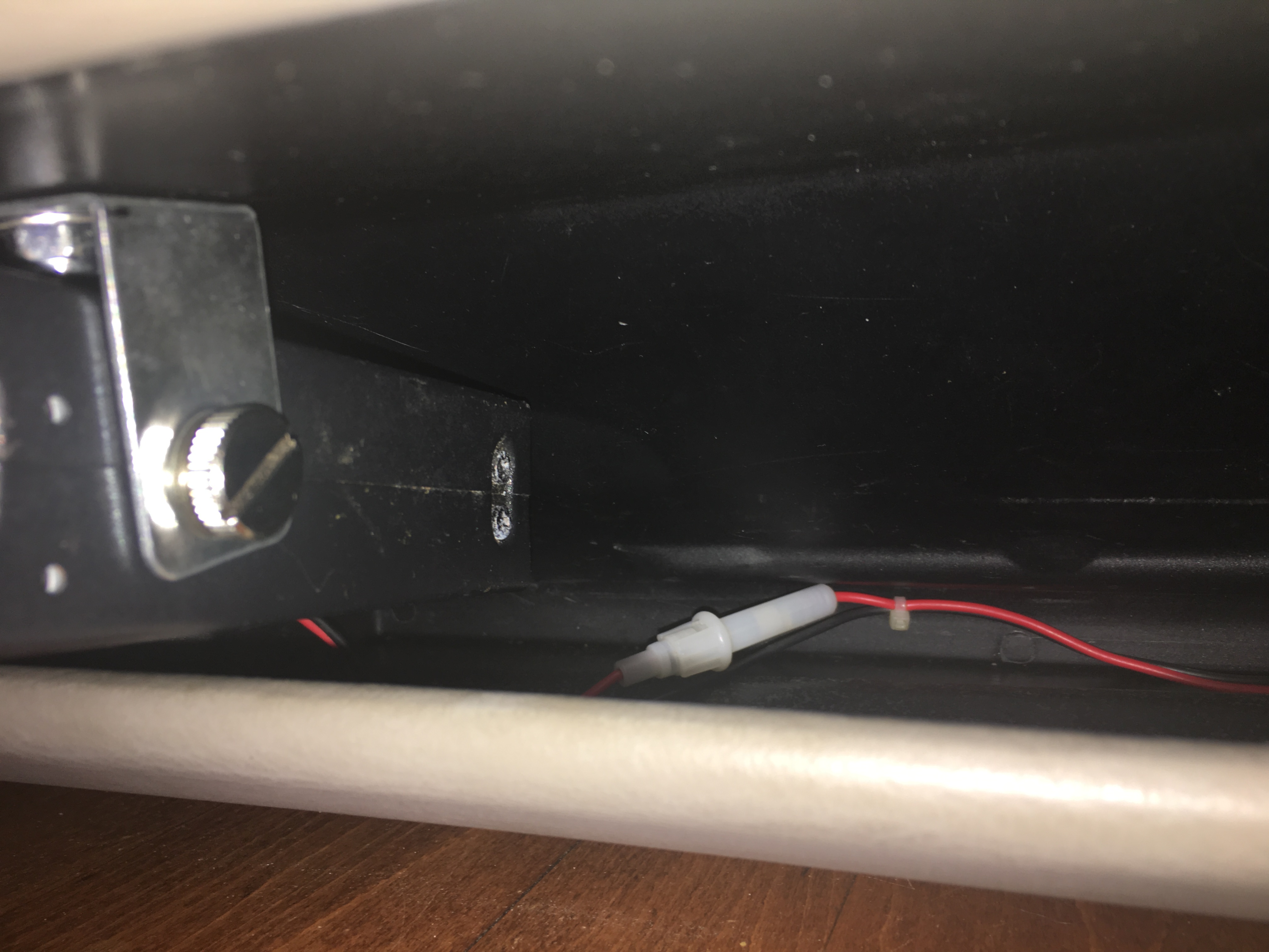

Well after months of work and research I finally achieved my goal of having a CB in my V70.
I removed the passenger knee bolster, installed the map pocket from a 2000 XC70, and installed the radio in the map pocket. Went with the 3/4" NMO mount placed square in the middle of my non sunroof roof.
Power came via the 30 amp hot wire in the accessory connector. Soldered a two-pin trailer quick disconnect to the radio wiring and then soldered a Volvo OEM wire tip on the power lead and actually used the accessory plug as is. Ran the power wire under the drivers side carpet just near the steering column and then through the pass-through area above the heater core. For a ground, I soldered a ring connector and used one of the bolts that formerly held the knee bolster on as a ground lug. Both the coax and the power wires were run through a 3/4" hole in the front left corner of the map pocket. There is just enough space up there above the passenger side entry light for everything to fit neatly with no stress on the wires. Coax was run up the passenger side trim to the NMO mount. I did have to use a utility knife to remove a section of that black sound damper stuff that was glue to the roof to properly install the NMO base but that wasn't too bad.
The radio is a little further away than I would like, but it's solid and secure. I used a piece of aluminum bar stock as a reinforcement for the CB mount bolts. I also drilled two little holes in the map pocket top and ran a zip tie through them and attached it to the glove box support member to give the whole assembly a little more strength.
The radio I used is the ubiquitous Uniden Pro510XL, which is a simple, sturdy and relatively light unit. I bought it used on eBay for $17. So far it works great. For the antenna, I got a Larsen NMO27B. It really gets out there. The main reason I went with this set up is because I have a low parking garage and I have to remove it before entering. When it's not in use, I have a little rain cap to cover the mount.
There isn't much CB traffic in my area, but I've had some good contacts. People have confirmed that I'm getting out there pretty good. Worked great on a recent highway trip out to a more rural area. It's a fun hobby that I've had a lifelong interest in and I'm looking forward to getting some good use of this. Thanks everyone for your feedback. I'm going to post some photos of the installation for reference.
