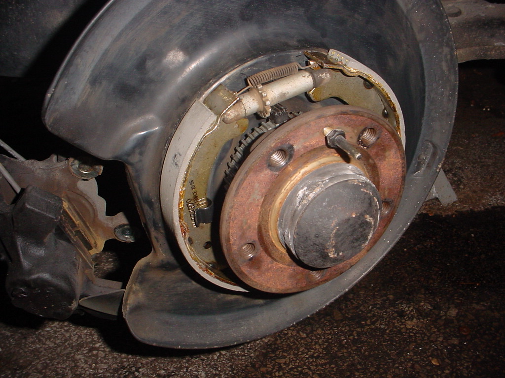

The reluctance rings, they are also called tone rings, are gear shaped pieces that are on the end of the axles. On the fronts they nest into the steering knuckle just behind the hub. I have a picture of the rears here:
It is the sprocket shaped device just in front of the backer plate in the picture.
Each tooth on the ring sends a pulse to the ABS controller and that is how it determines if the car is skidding.
