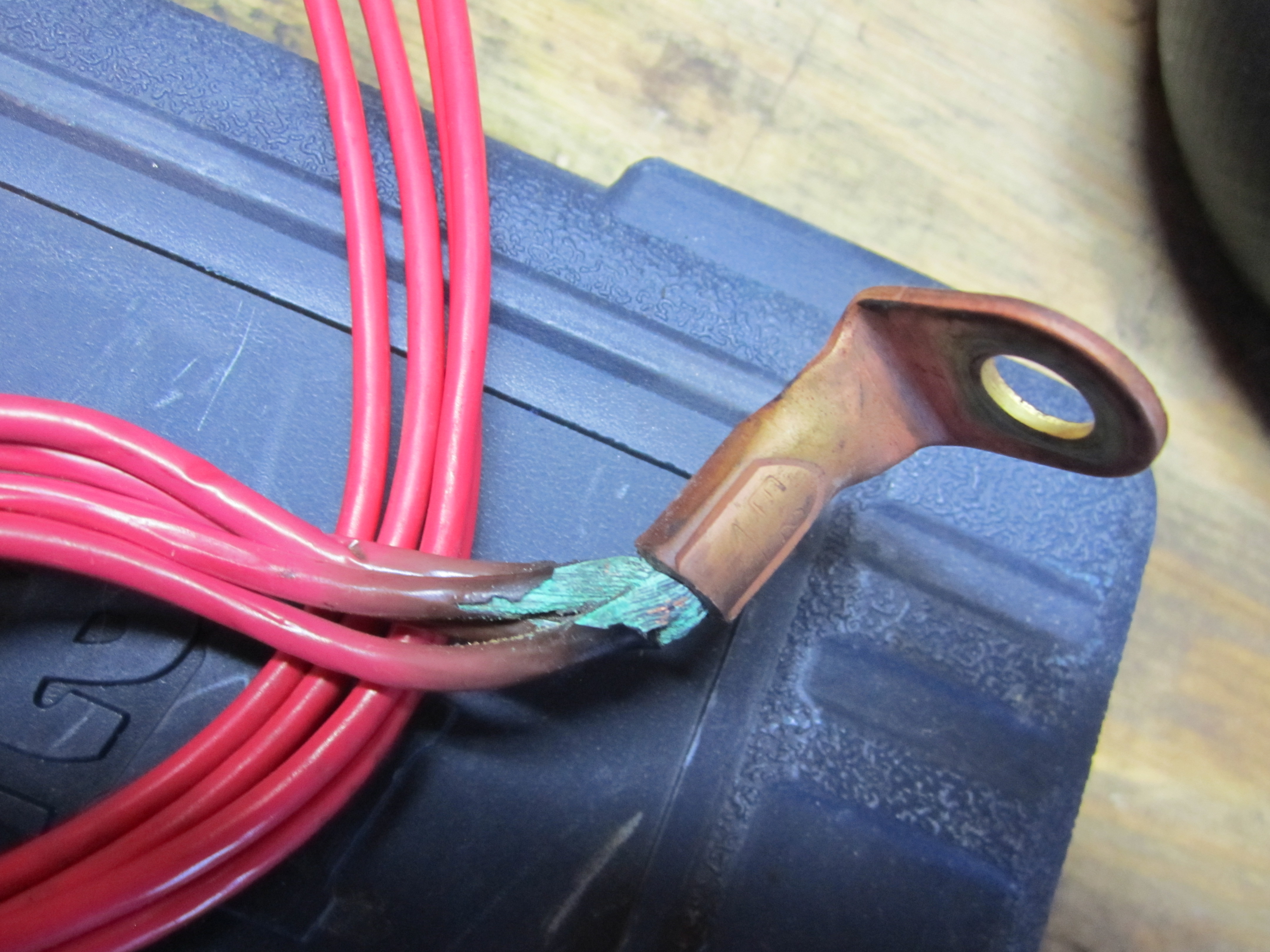

Also check the B+ cable inside the kidney shaped fuse box near the brake booster. The cable terminates with a nut at the front of the fuse box and it is prone to melting and then shorting out. If the end of the cable is not bright and shiny look below the nut at the cable carefully. Mine had completely melted. Worst case it can cause a major short and then set the car on fire. Affects 99-00 models most but not exclusively.
