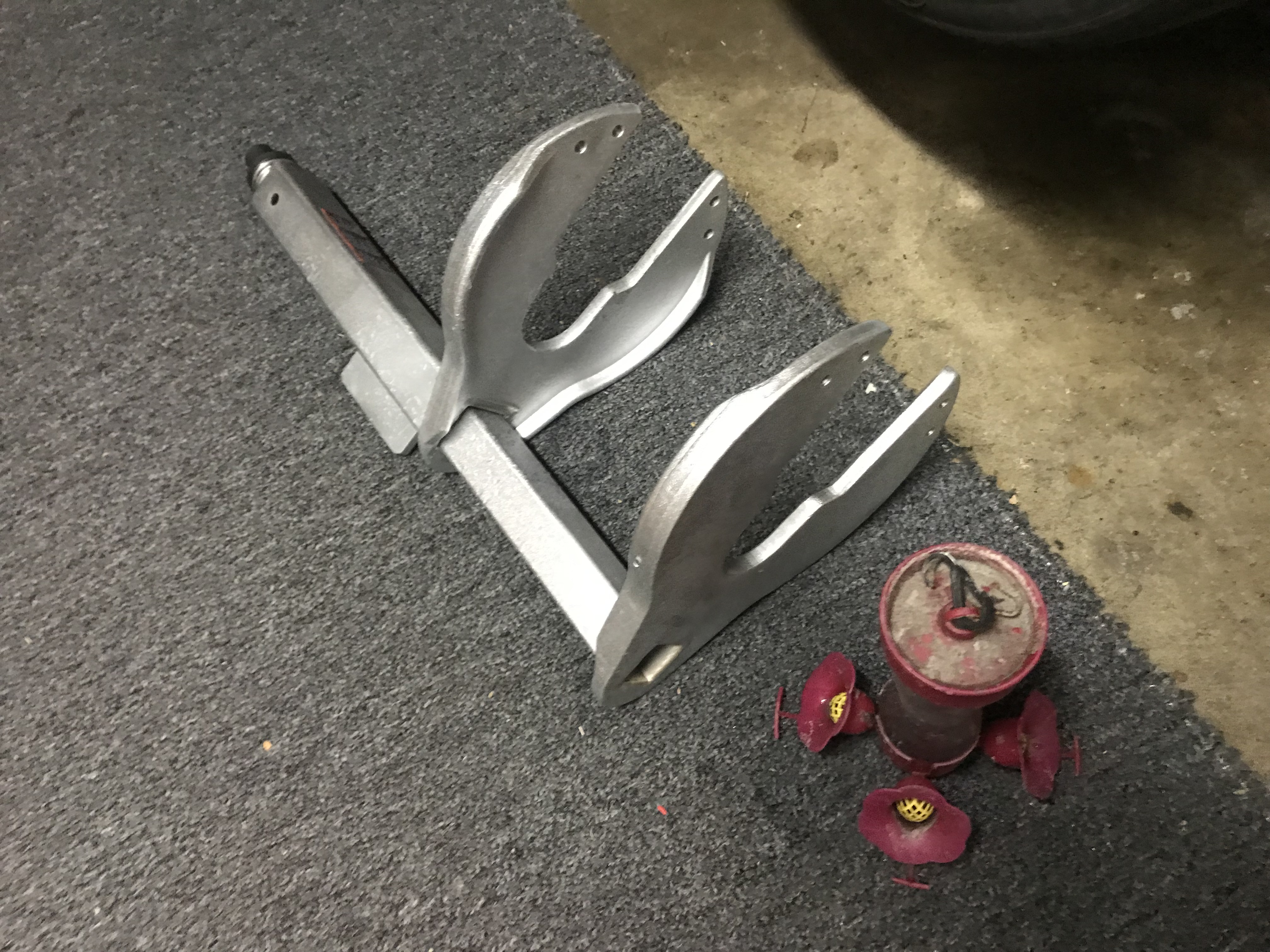

Go to Autozone and rent this bad boy. No chance of any springs jumping away and it is so fast and easy. Had a pair of those spring compressors from HF, they just turn into spaghetti noodles when you start tightening them.RickHaleParker wrote: 29 Apr 2019, 11:17The strut mounts are worn out.Jedwar11 wrote: 29 Apr 2019, 08:37 I noticed the top of the strut mount in the engine compartment has a gap between the top rubber and the mount.
Take it to a mechanic and have him change out the strut mounts. I don't advise DIY strut mount replacement to anybody that does not know what they are doing. People have been killed when they lost control of the spring on the strut. A flying spring has the energy of a Cannon Ball. If it hits you, it can kill you.

Brilliant! I never thought of using a humming bird feeder!!!
