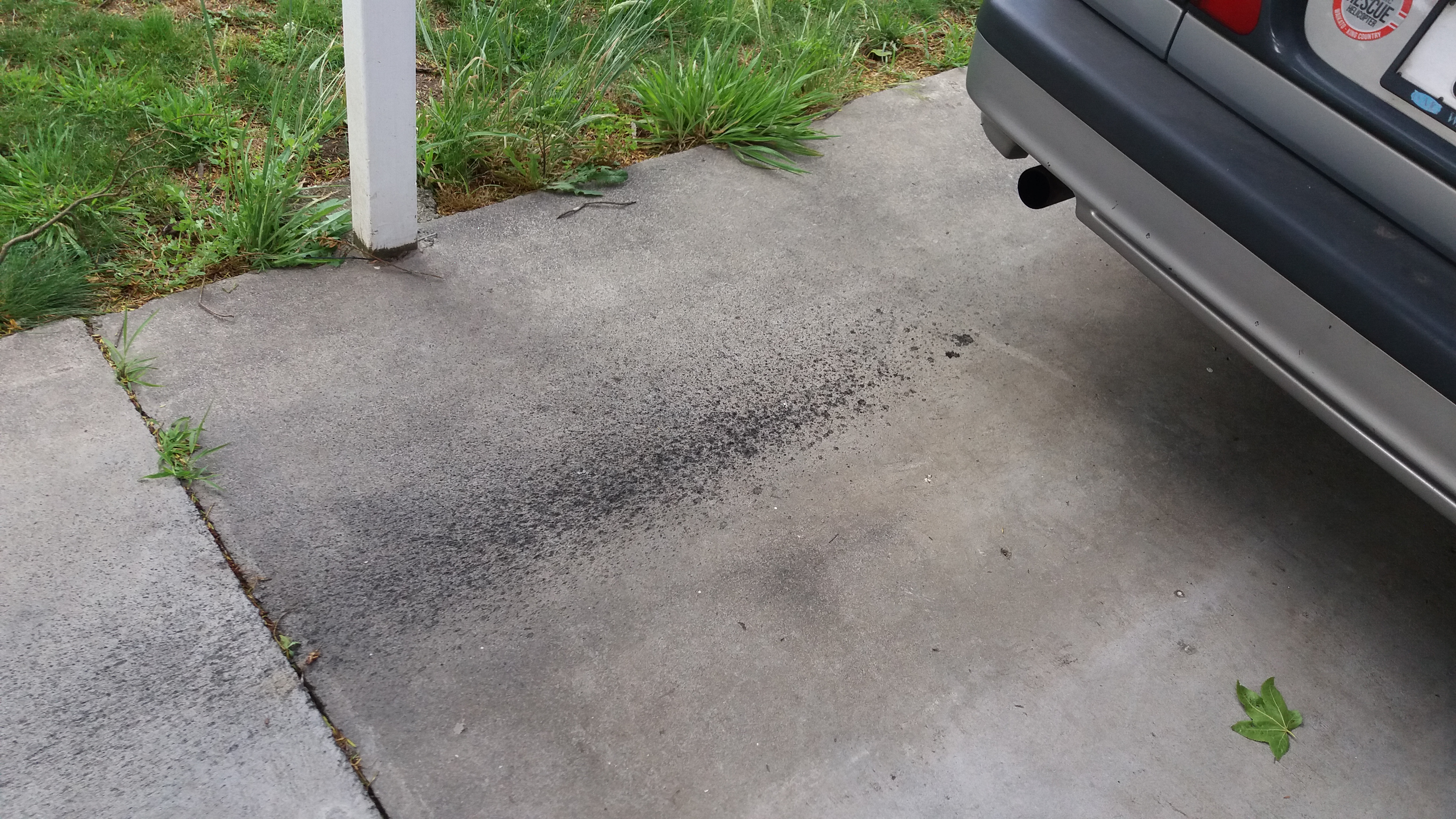

The other day my Volvo died on the way to work. Ran 100% perfectly then when coasting down a hill the engine stopped. It's a 1996 NA Volvo 850.
The car always starts, at first the car ran perfectly again and could even drive in the driveway (I didnt trust it to take me anywhere) but now it always stalls. With my foot on the gas it will stay running, with a misfire. Blows out white smoke (Running rich?) left a splatter of petrol on the driveway from the exhaust. No water in oil and vice versa, head gasket is probably fine.
I have another 850 exactly the same which I can swap parts from. The only part I can't change is the MAF sensor, because its broken in my other car. So far I've checked all fuses, swapped fuel relay, swapped the 3 computers, disconnected MAF (runs the same, again can't replace this as its broken in the other car) and the fuel pump can be heard running, But I am leaning either towards a problem with the MAF or the fuel pump not working properly?? I've listened for vacuum leaks and can hear something but not sure where its coming from. I Honestly don't think that is the issue.
Can anyone point me towards whether I should look into a new MAF or if I should swap some more parts over? Engine light is on but I am unable to read the codes.
