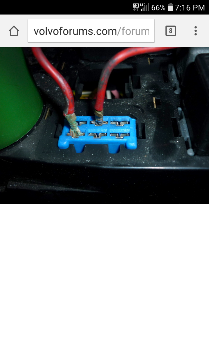

I found the "jumper test" and tried that, and could hear the pump running, BUT... the car wouldn't start. Pin 30 and 87/2, or the closest lower on the left, jumped to middle pin on the right. (Ive seen pictures that are NOT correct)
Not sure why that didn't work? Put the original relay back in.

Yes, thank you very much, Lummert, that makes much more sense. I had only seen the one wire jumped and people claimed it worked until they got a new relay.
This will NOT work to start your Volvo..
Nor will this...
I will try the "correct" jumper and report my findings, and post pictures. There are many dead ends here that are not known to be resolved.

Jeff Schubert wrote:Yes, thank you very much, Lummert, that makes much more sense. I had only seen the one wire jumped and people claimed it worked until they got a new relay.
Nor will this...
87/2 powers up the pumps. but the radio suppression relay needs to be triggered through 87/1 to power the injectors.

Excellent, thanks again. I just made myself a Y shaped jumper. As you explained, should jump 87-1 AND 87-2 to 30. Presumably 87-2 goes to fuel pump, 87-1 goes to radio suppression relay, and pin 30 is power.
So, viewed from the top of the relay panel would be 30 is lowest left, 87-1 is highest left, and 87-2 is middle right pin...correct?
For safety sake I think it would be best to plug in 87-1 and 87-2 FIRST, then plug in 30. Less chance of accidently shorting. Seems logical.

Well, yes, the jumper DID work to start the car. However, it still does not run right. I did for a few minutes then back to stumbling, backfiring,and barely idle.
Is there a bypass test for the radio suppression relay? I don't understand what could be causing such an intermittent problem.
