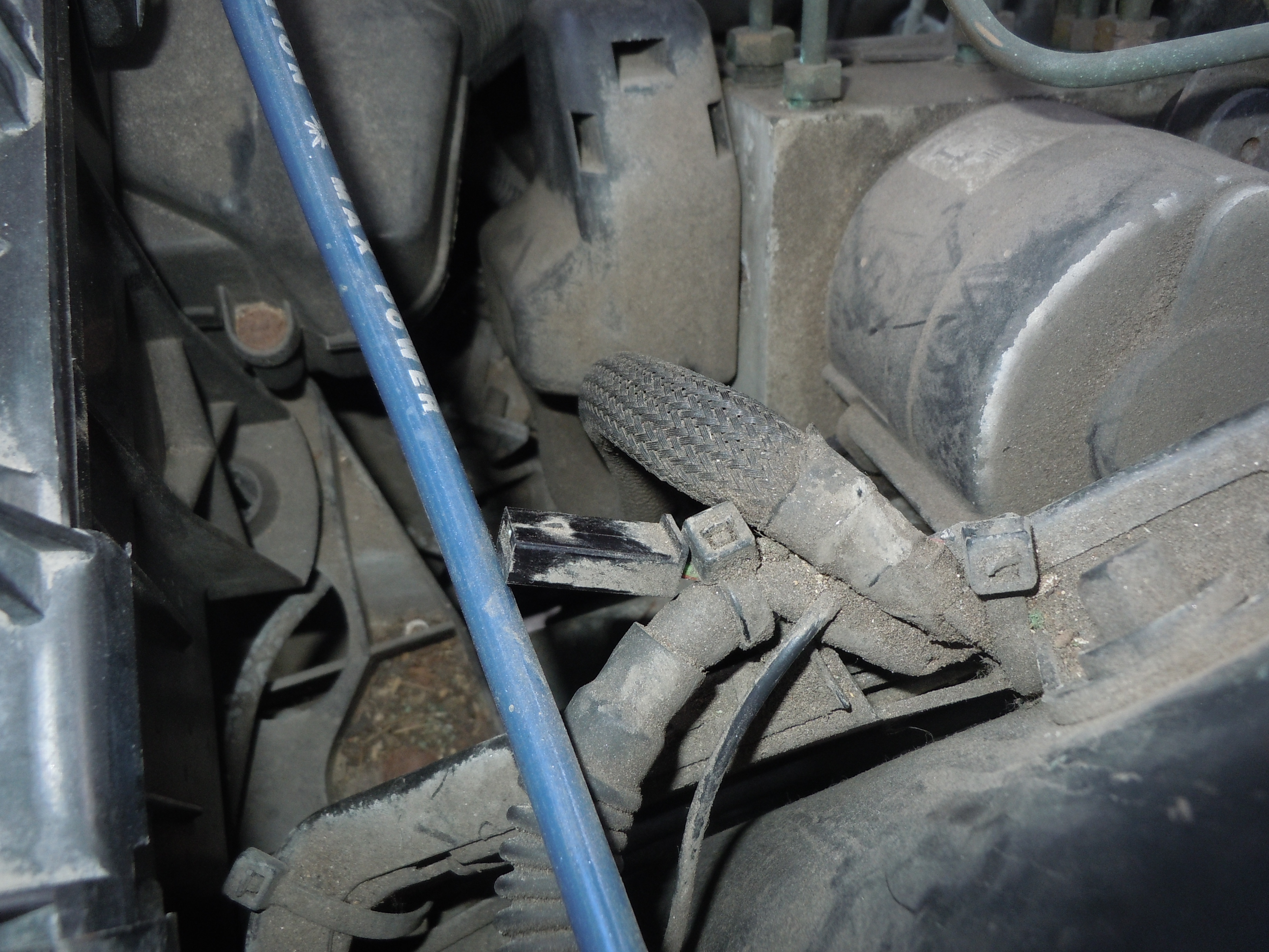

My 96 855 does have a female spade-type connector peeking out of the harness in that vicinity. I photographed it and will send the picture later.
My 93 850 doesn't seem to have anything like that. The area right in front of the fuse box on the 93 is very congested with the early version of the ABS system and the harness coming off the fuse box, but I don't see a plug or wire, except for the two small wires that connect to the spark coil.

The wire is green on Manual trans cars, green /red on AT
If you just post the picture here in a reply, I'll move and clean it up.

Okay, here's the picture. As I mentioned, I couldn't find a wire or connector on the 93 850; there is a connector on the 96 but no wire. Maybe that's for something different. Both of those cars are manual trans.

That looks like a green and red. If you want to be positive, put a voltmeter on it and see if it goes to 12 volts when you've assistant cranks the motor.
