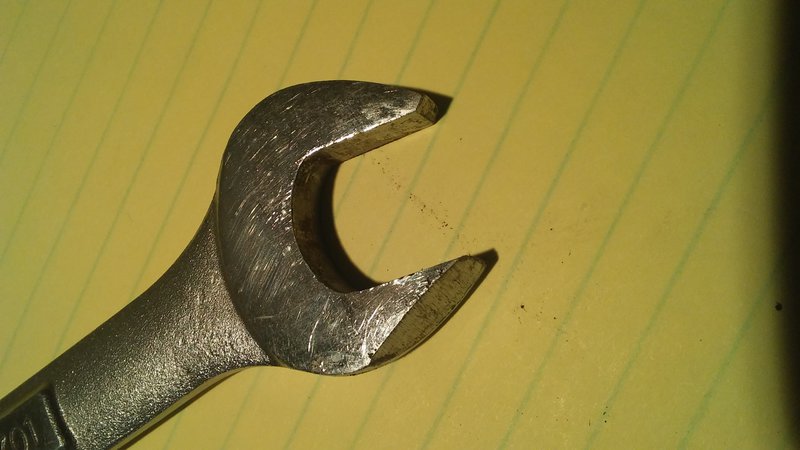

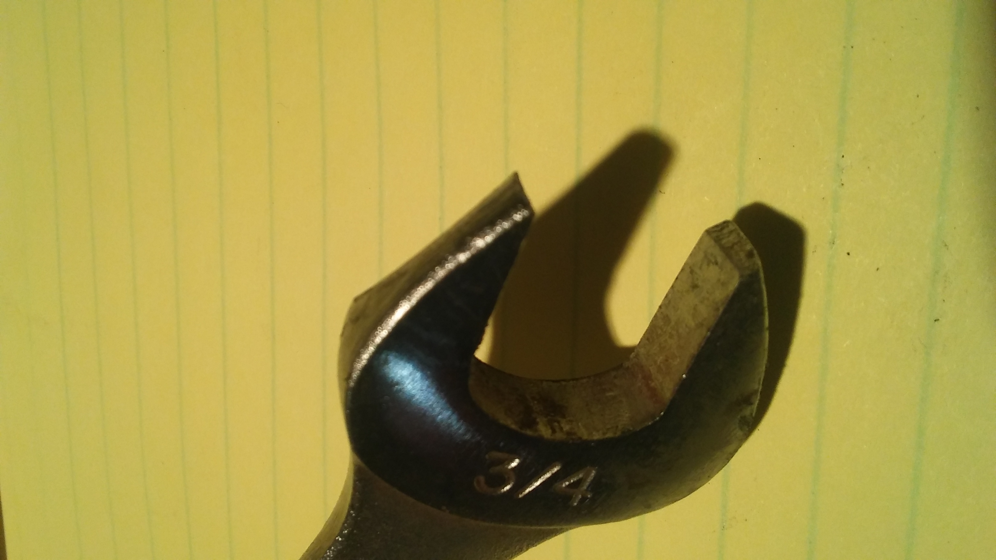

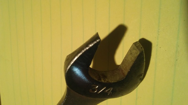

This was done on a 1989 740gl
Step 1 Disconnect Battery
Step 2 Remove connector from ECT
Step 3 Remove connector from Knock Sensor
Step 4 Grind small corner off 3/4 wrench
Step 5 Remove ECT sensor
Done
It took me longer to type this than it did to remove the sensor....
Remove the intake manifold?!
Um..a socket won't even fit over the plastic connector?
I had done research on this and thought it was going to be a cursing, tool throwing, bloody knuckled nightmare...
Seriously...less than 5 minutes. Cake.
Any questions, feel free to ask.

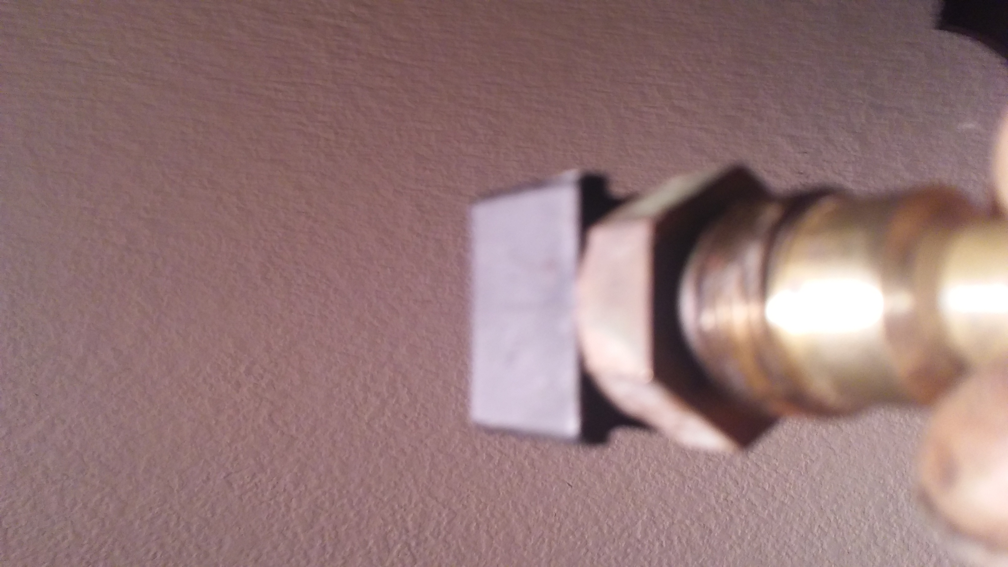

Maybe my plug is aftermarket but I couldn't get a socket to fit. The connector is in the way of the flats.
Nope, it says Volvo on it...?

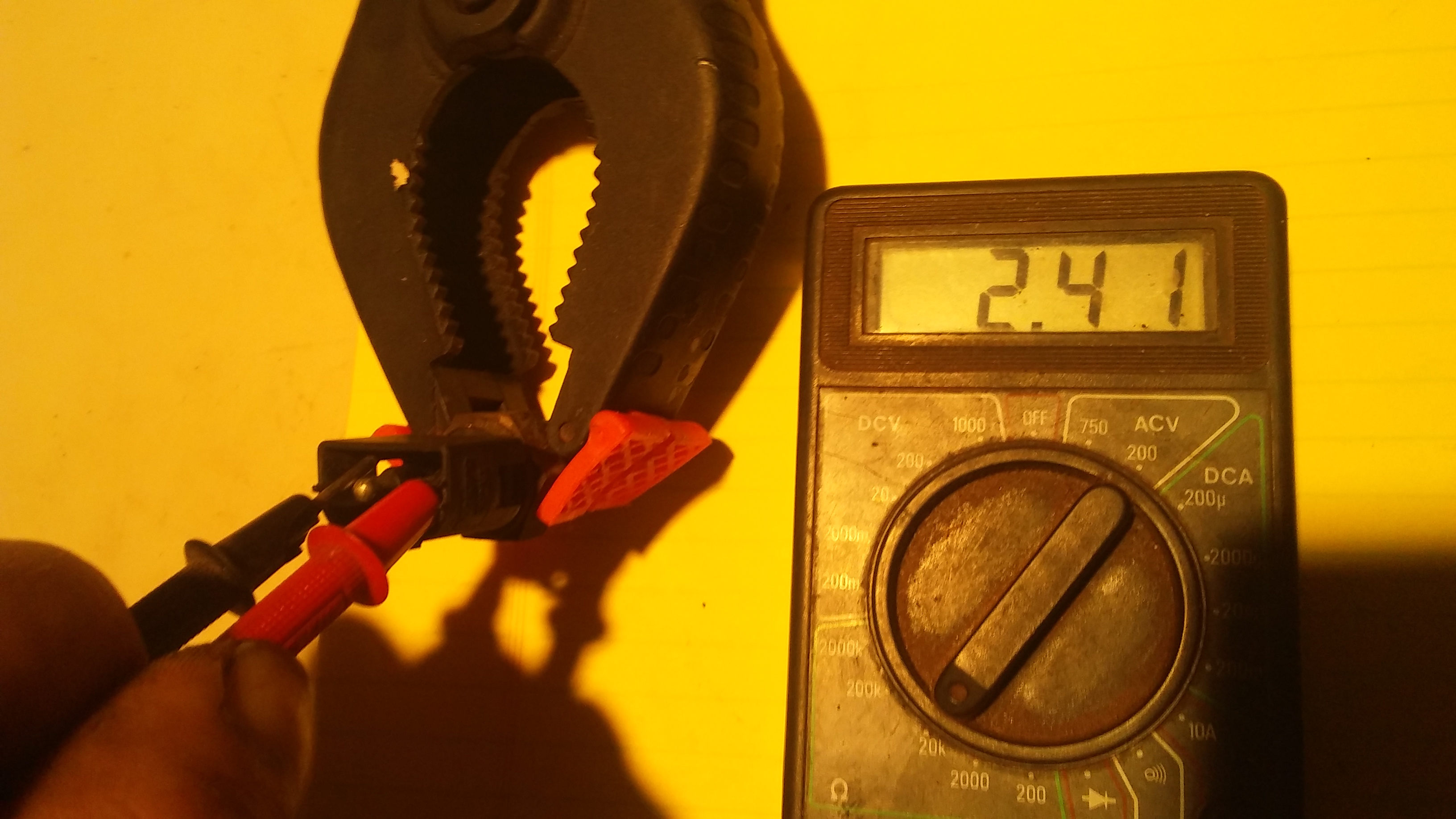

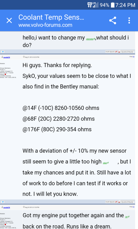

Sorry ignorant question. ...
This is at about room tempreture. Would this read as 2410 ohms?
If so that should be within spec?

Jeff Schubert wrote:Maybe my plug is aftermarket but I couldn't get a socket to fit. The connector is in the way of the flats.
That connector looks odd.

On one side says Volvo 1362645
The other says SWF Germany 601 607
The plastic plug part is wider than 3/4, maybe 13/16ths.
I just had it in the freezer for about 30 minutes and it seemed to level out at what I believe is 14100 Ohms.
I don't think there is anything wrong with this sensor. I have yet to test 'boil' it, but room temperature around 3950 ohms and 'frozen' around 14000 ohms, don't think its necessary.
Next test...blah still chasing problems...

Could the connector be slightly rotated? the first time I replaced the sensor on my 1988 760 Turbo the connector was coming loose due to corrosion.
1988 Volvo 760 Turbo Wagon
Jeff Schubert
Posts: 24
Joined: 12 Dec 2016, 21:01
Year and Model: 1989 740gl
Location: Wisconsin
Post by Jeff Schubert »
No, seems quite solid. Im no body builder but it seems it would take a lot of effort to turn it or break it.
