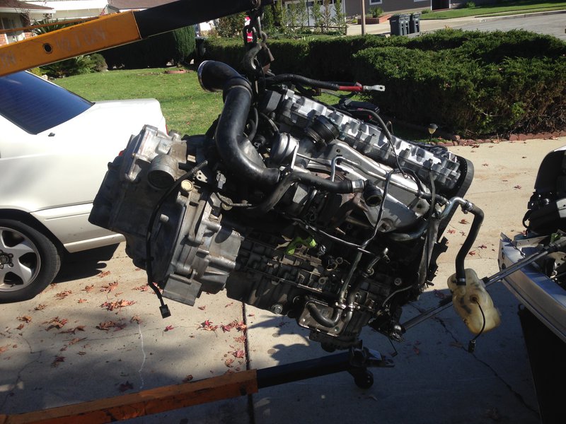

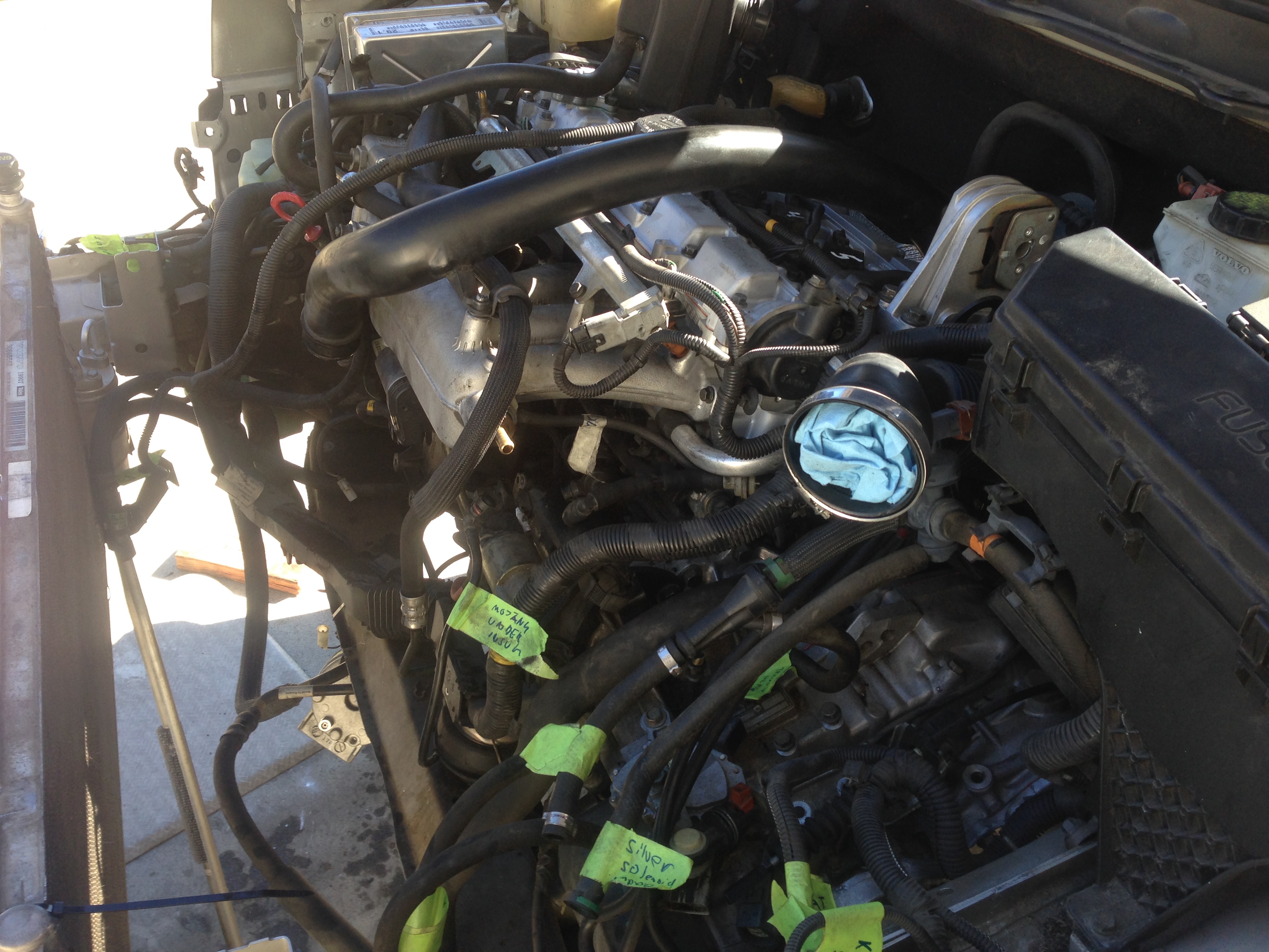

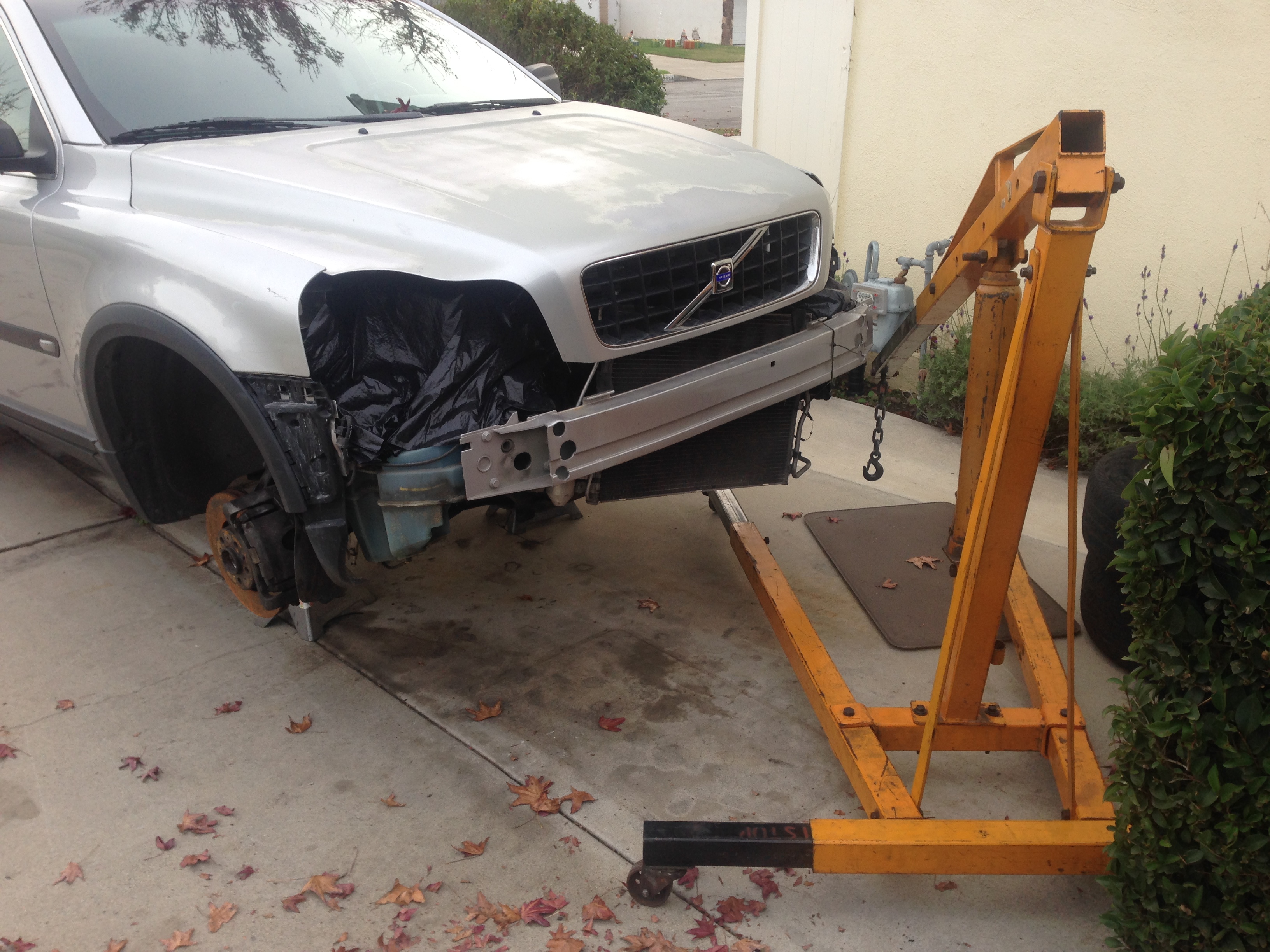

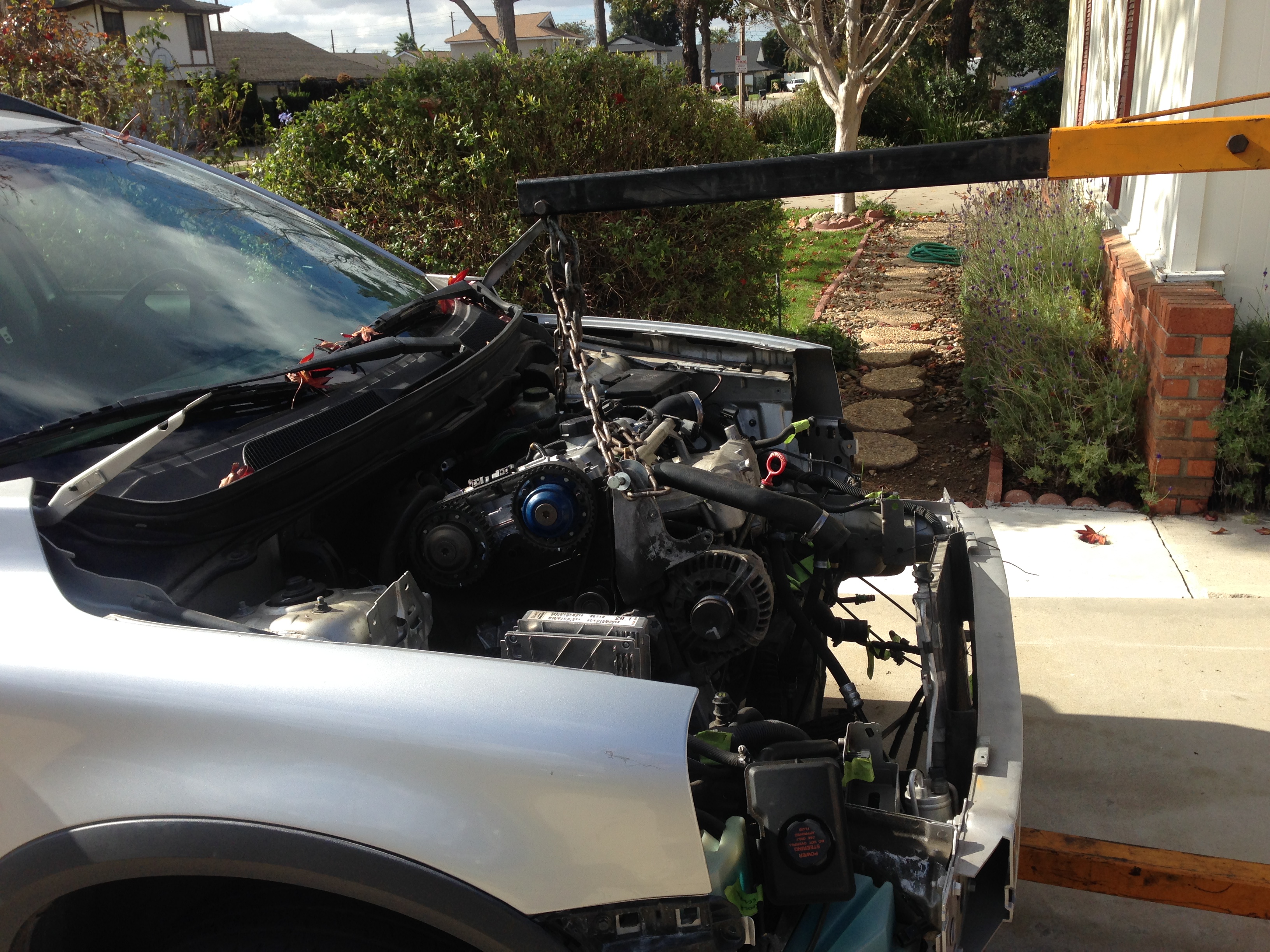

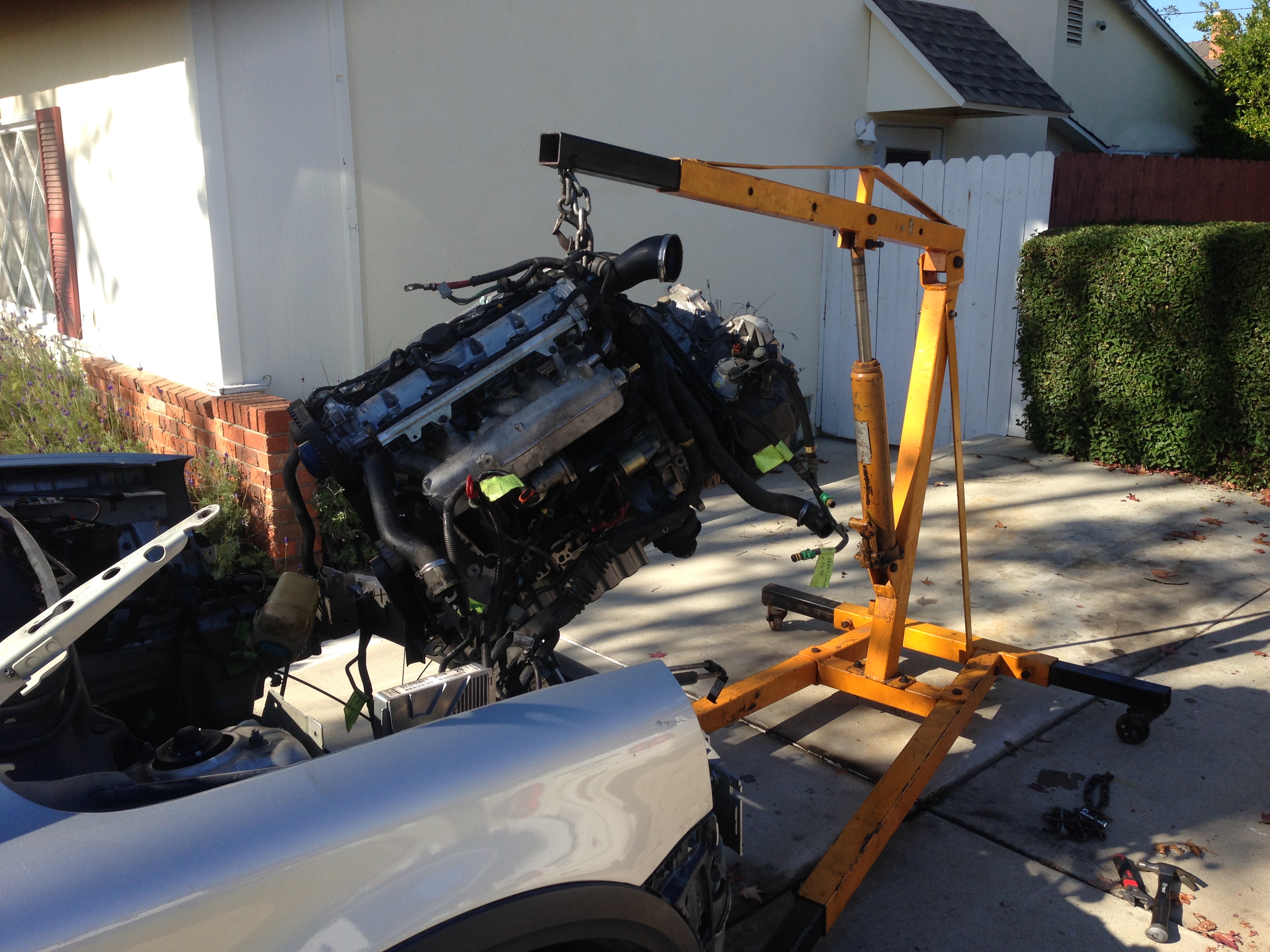

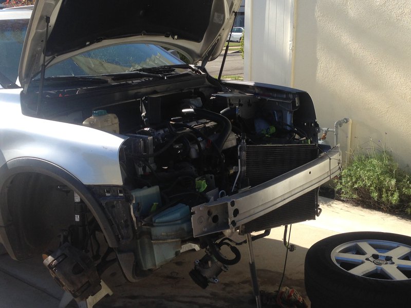

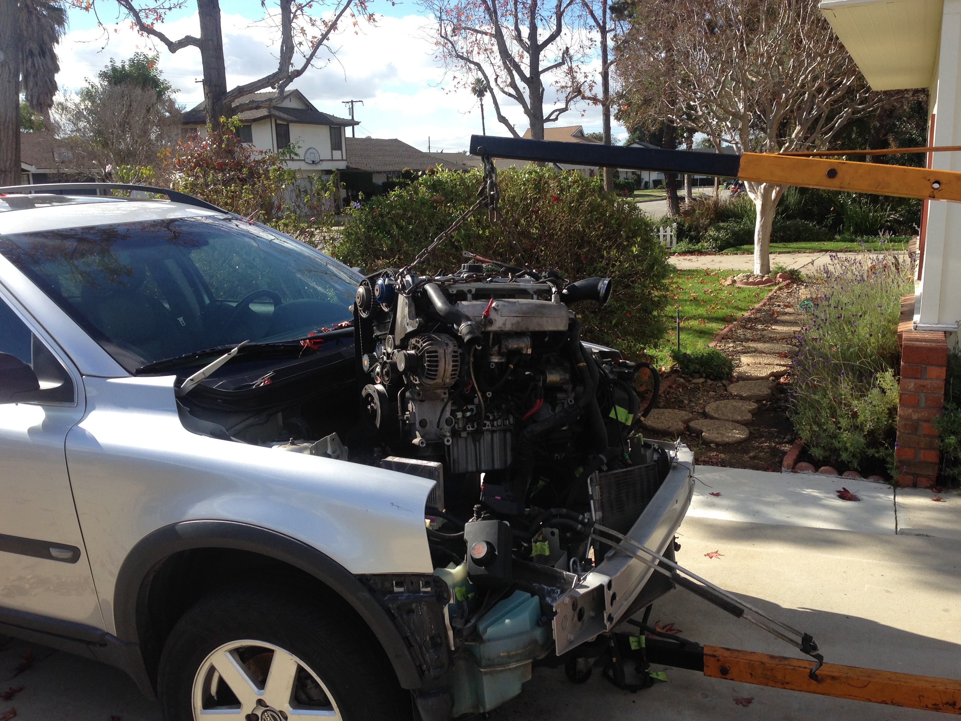

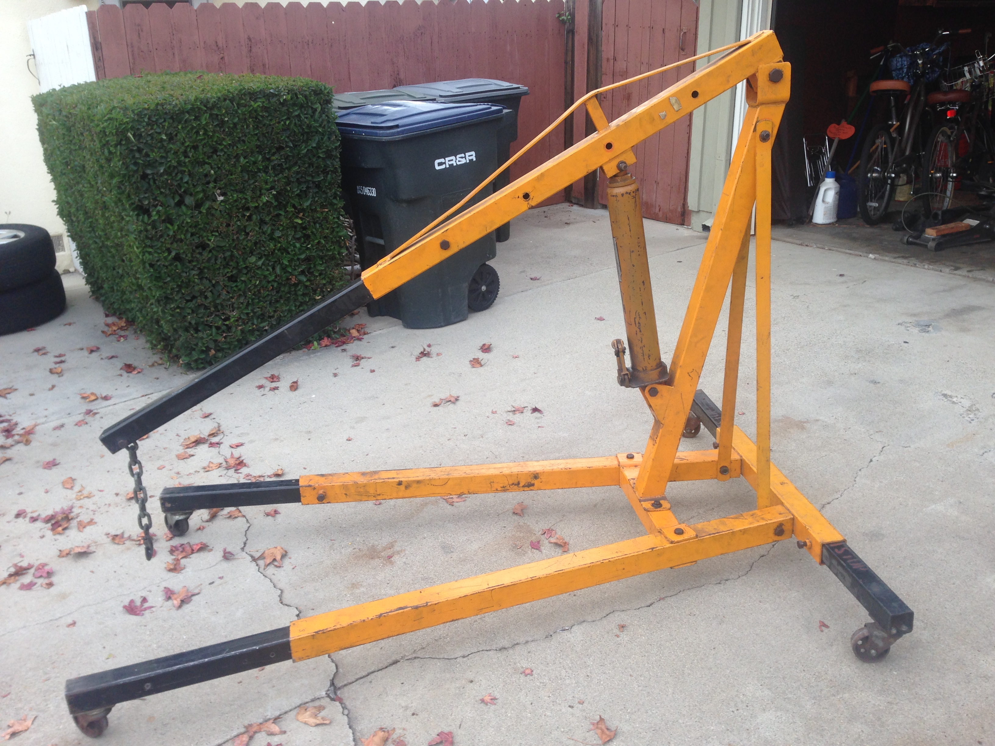

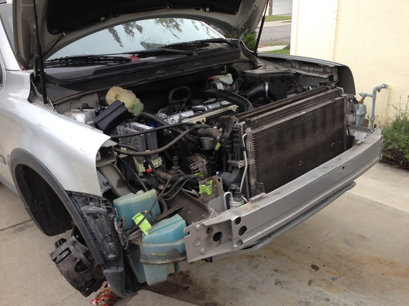

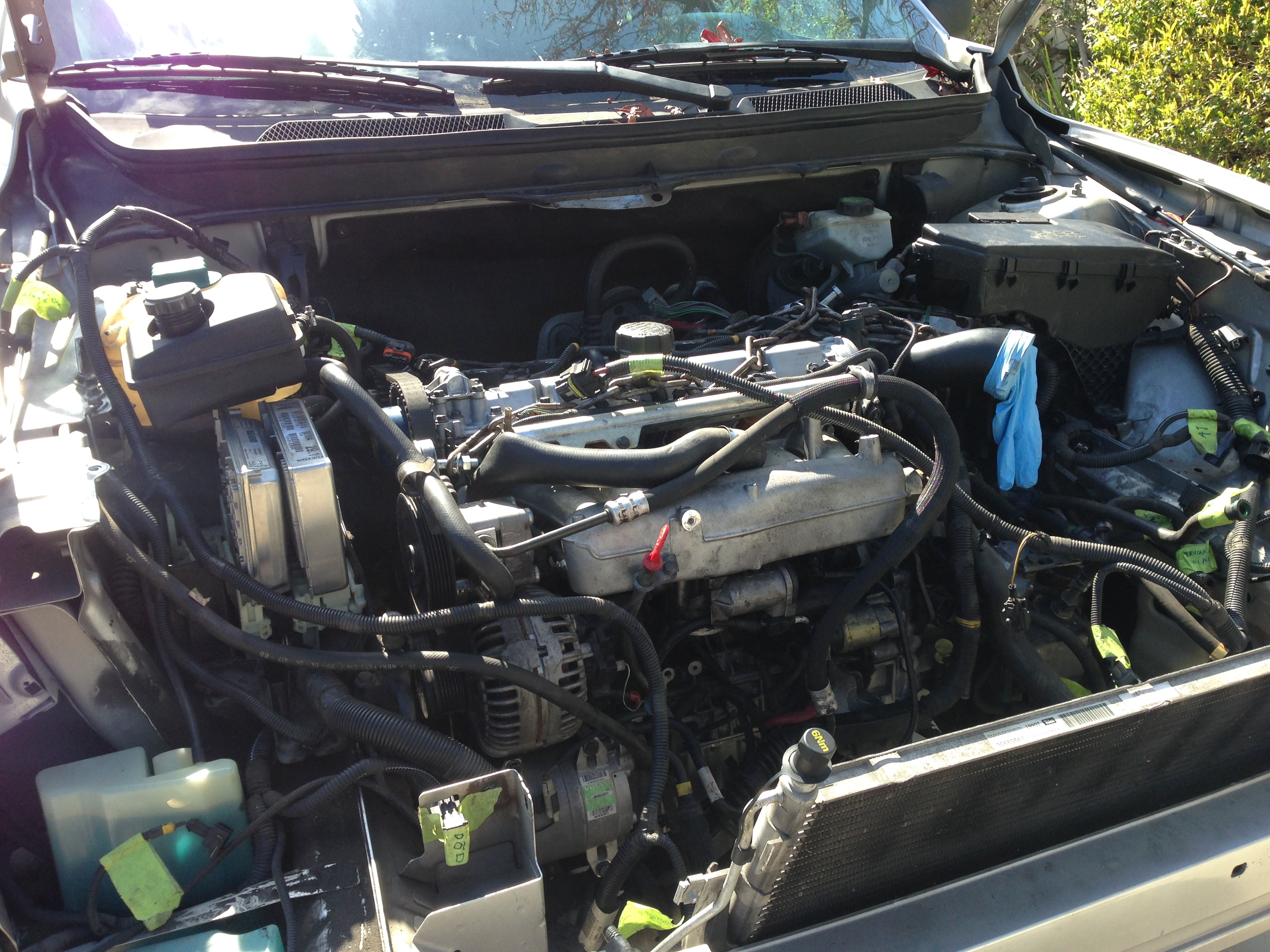

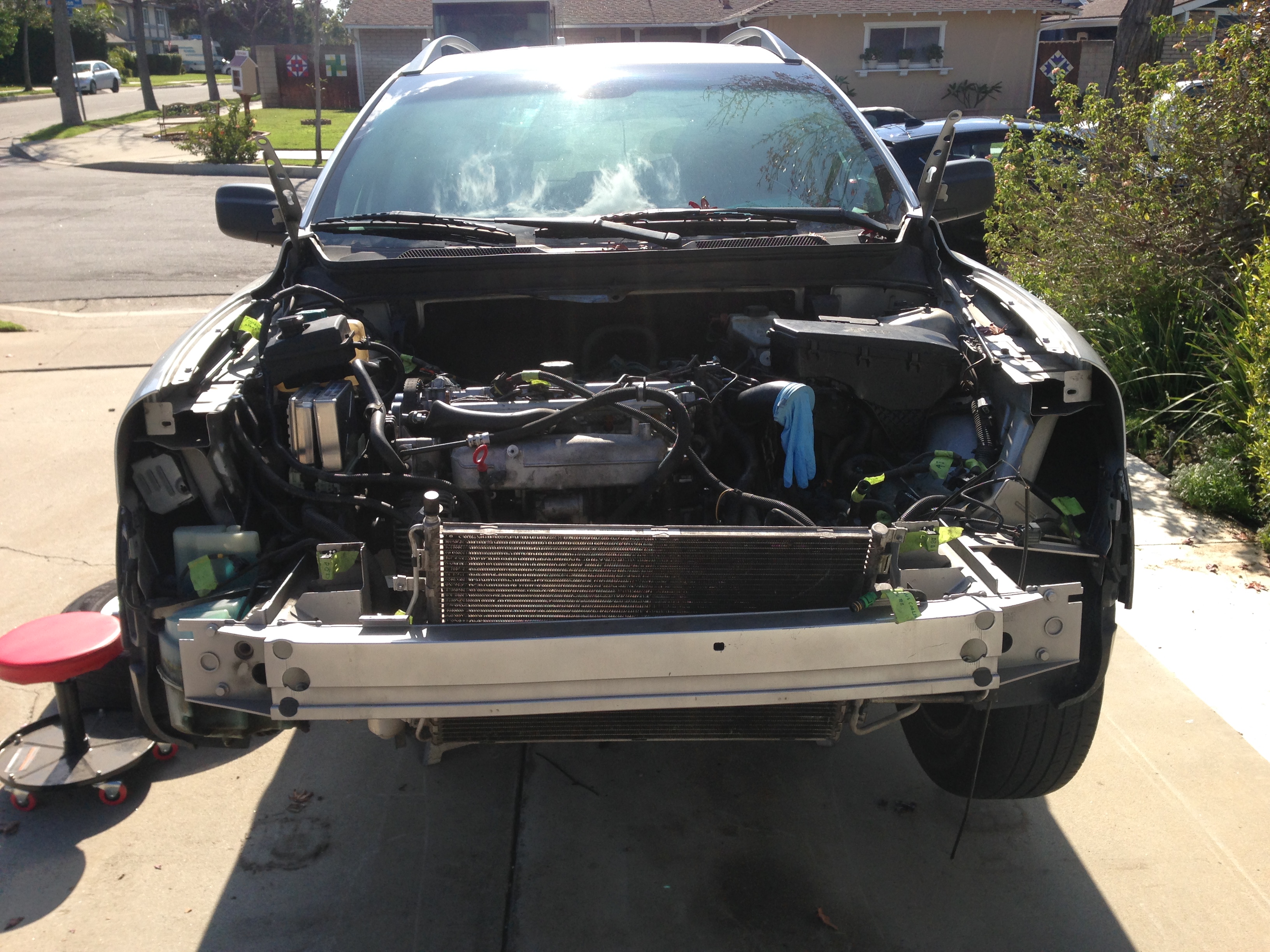

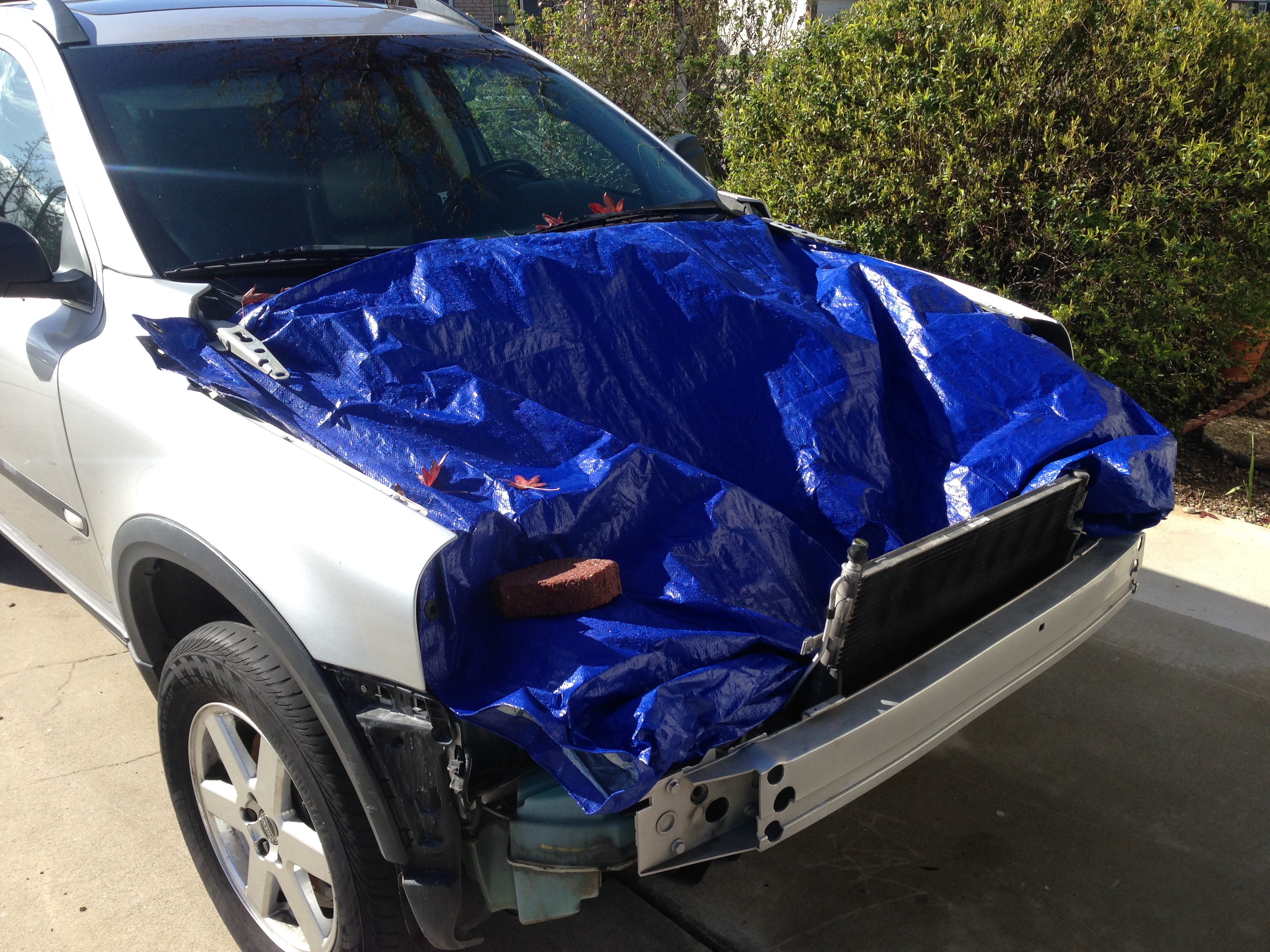

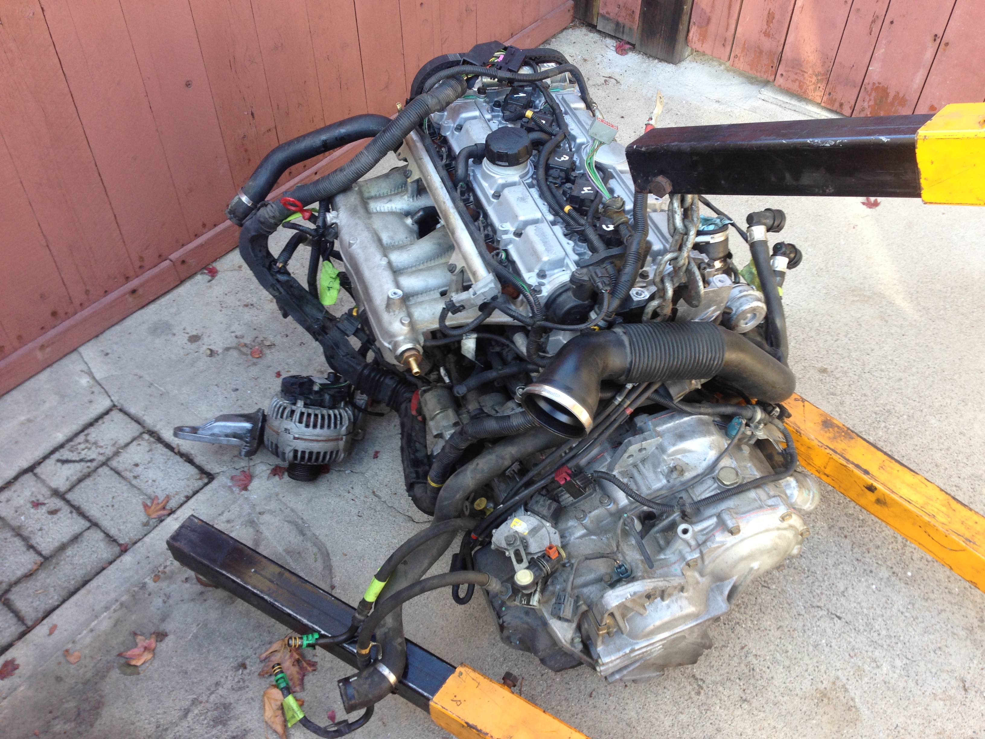

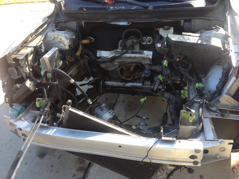

Bought myself an xc90 with a burnt exhaust valve. Thought i was just gonna fix the head and then flip it. However, an over enthustiastic mechanic before me had completely stripped the threads for the turbo oil pressure pipe in the block. Tried both heli-coil and time-sert but there just isnt enough material. So now the engine has to come out and taken to a specialist in broken bolts and thread repair. Stay tuned for more pictures...
