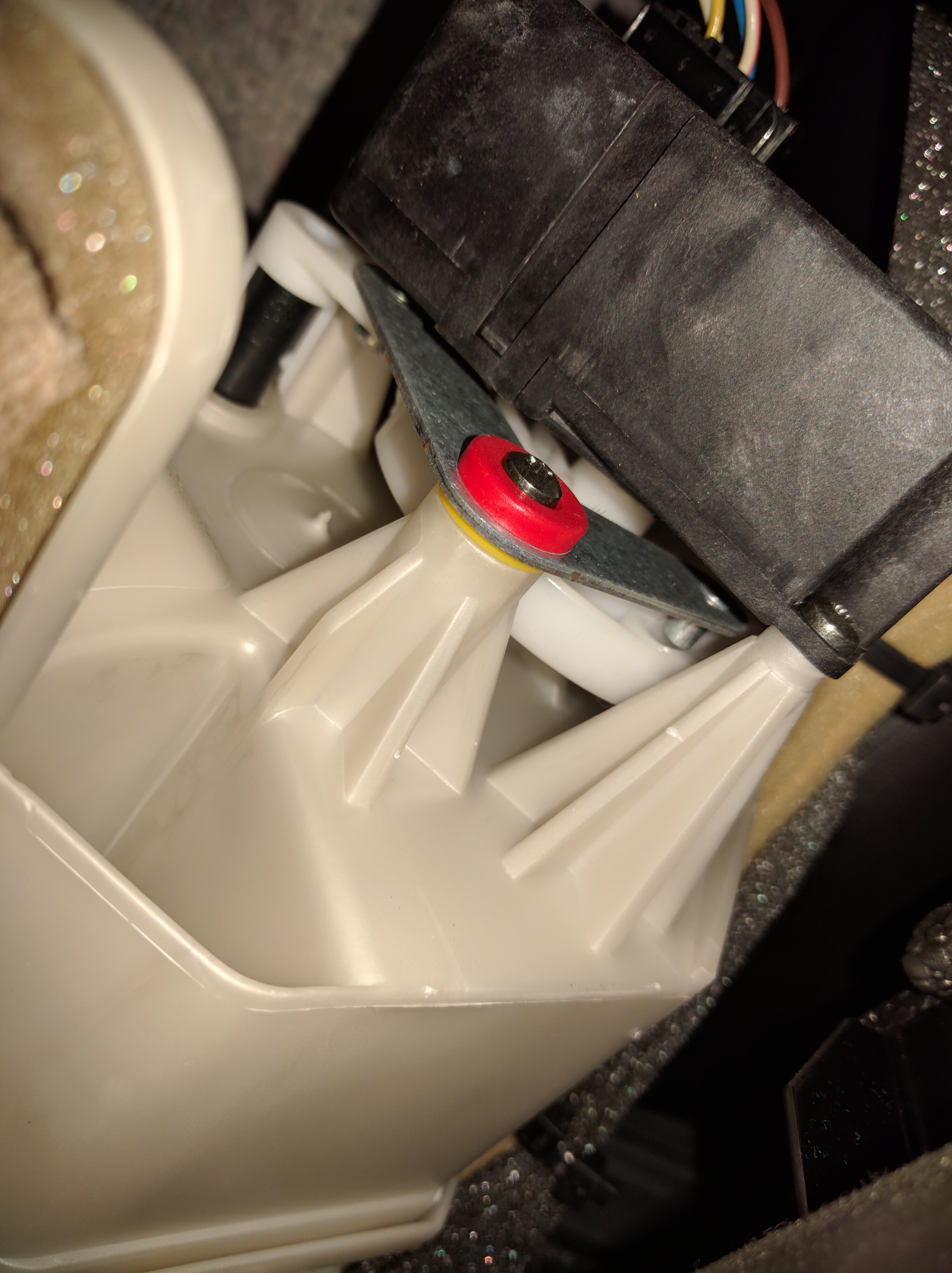

My drivers side climate control is stuck on cold, it's not the best for this time of year, I've been surviving on the heated seats to be honest. Anyway I finally decided to take a look into it, I get the blinky ECC lights but don't have a code reader. I could get an OBDII reader but I'm under the impression those can't read ECC codes, right?

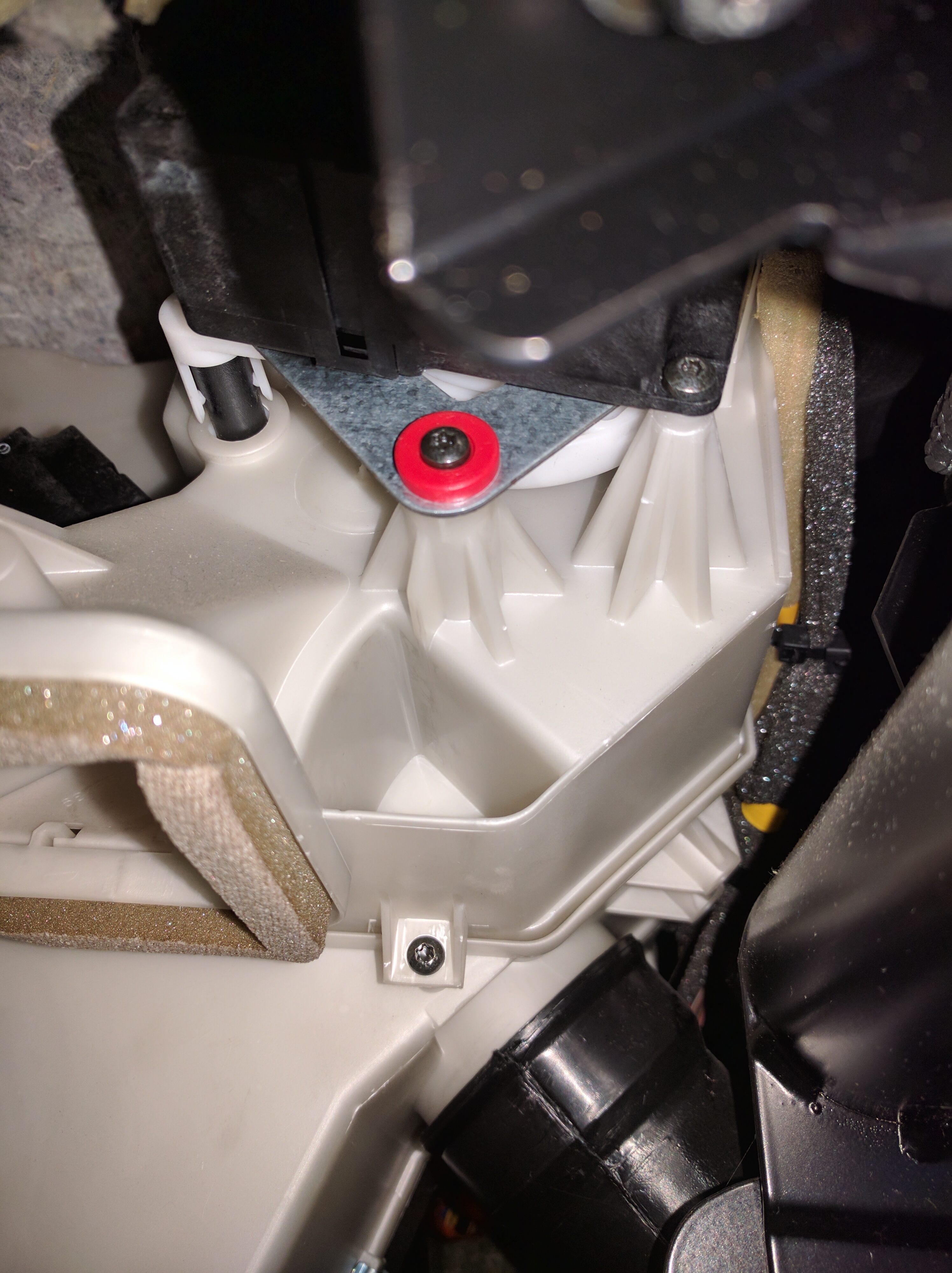

I figure I could remove the damper motor while leaving it plugged in, see if it's turning or not, but I'll need to get ahold of one of those flexible bit drivers because I can't reach the screw that is supposedly on the far side. Photos attached. Am I looking at the correct motor? I can't feel it doing anything when I adjust the temperature setting, which leads me to believe the motor itself is shot and not the shaft.
Are there any easy fixes (temp sensors?) I might be missing? Is it possible to read the codes without spending more than $50?

A good reader that reads ECC module codes will cost $150 or so, or you can setup VIDA fir about $100.
That motor controls both the blend and the distribution on the late 1998(?)-on ECC so it is probably the culprit

Interesting. I pulled the motor and confirmed that it isn't turning. Then I checked the wires with a multimeter and made the following measurements:
[ ] Pink white 5V
[ ] Yellow red 4.9V
[ ] Red white 0.5V when still 11V after turning temperature control
[ ] Red black same but delayed couple seconds after turning temperature control
Comparing against this schematic:
I assume this is part 6/45, looks like a motor with some kind of buffer/relay? Anyway these measurements don't really make sense against the schematic, but I'm kind of reading tea leaves and don't really understand how this connection is supposed to work. Anybody know if this proves if the fault is in the motor or the ECC?

Assuming that 6/45 is the correct motor (without the secret decoder ring I can't say for sure) then the motor control voltage is applied to the Red/White and Red/Black wires and the polarity will change depending on whether or not it is opening or closing. The Yellow/Red wire is a sample voltage that tells the system what position the damper is in. That portion of the motor assembly is essentially the center tap on a volume control and the voltage sample will vary based on damper flap position. The voltage between the Pink/White wire and the Brown wire should be constant.

Ah, I see how it works, thanks for the explanation. Given that the R-W and R-BL wires respond to the temperature knob but the motor doesn't turn, sounds like the motor itself is at fault. Found a used replacement on ebay shipped from Germany for $55 shipped. Thanks everyone!

The motor you have pictured does not control the heat. It is the motor that controls the air to the floor or to the defrosted. The heater motor is down lower on the driver's side.
I have the same car and need to repair that motor as I don't have defrost.
