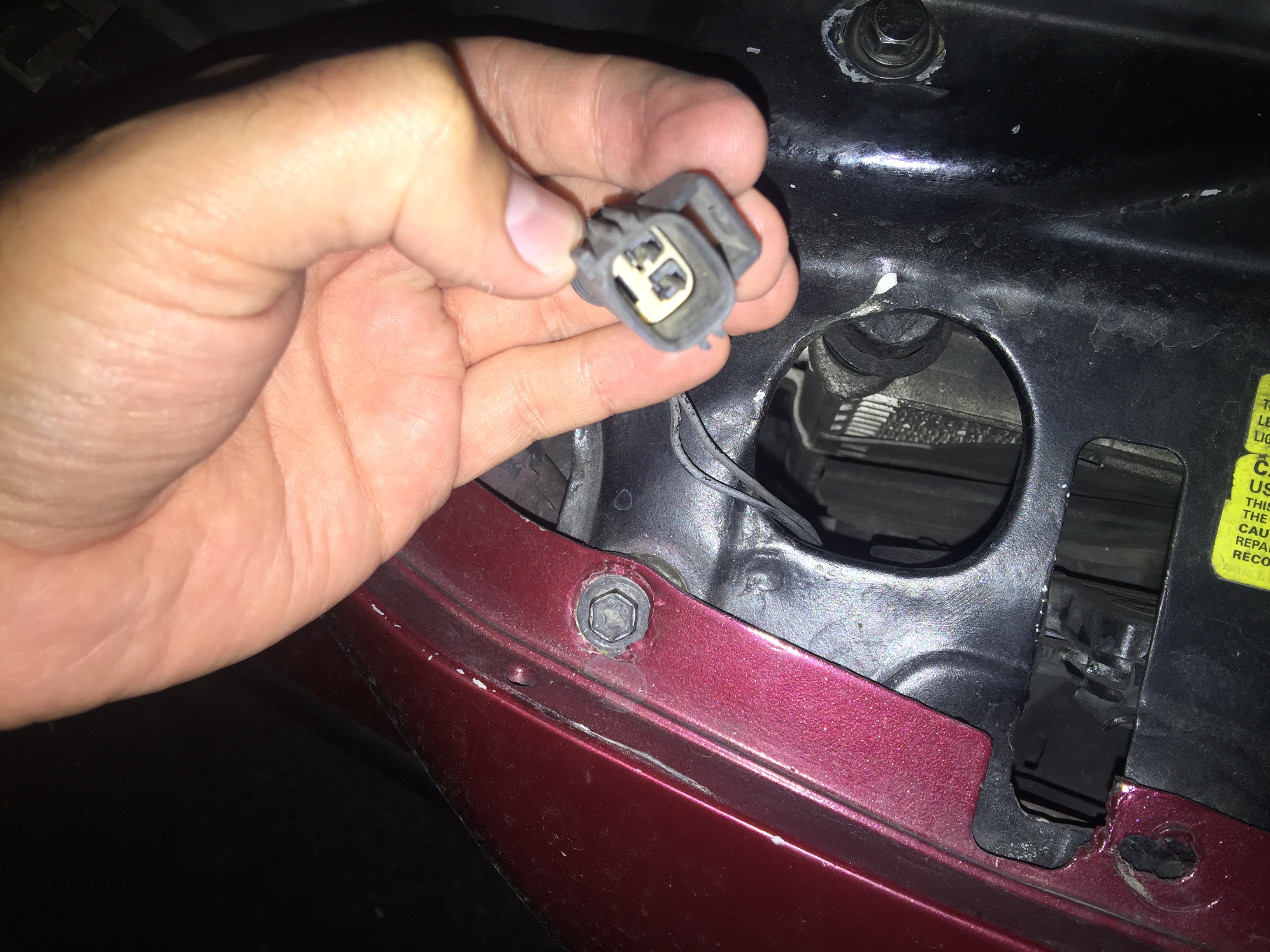

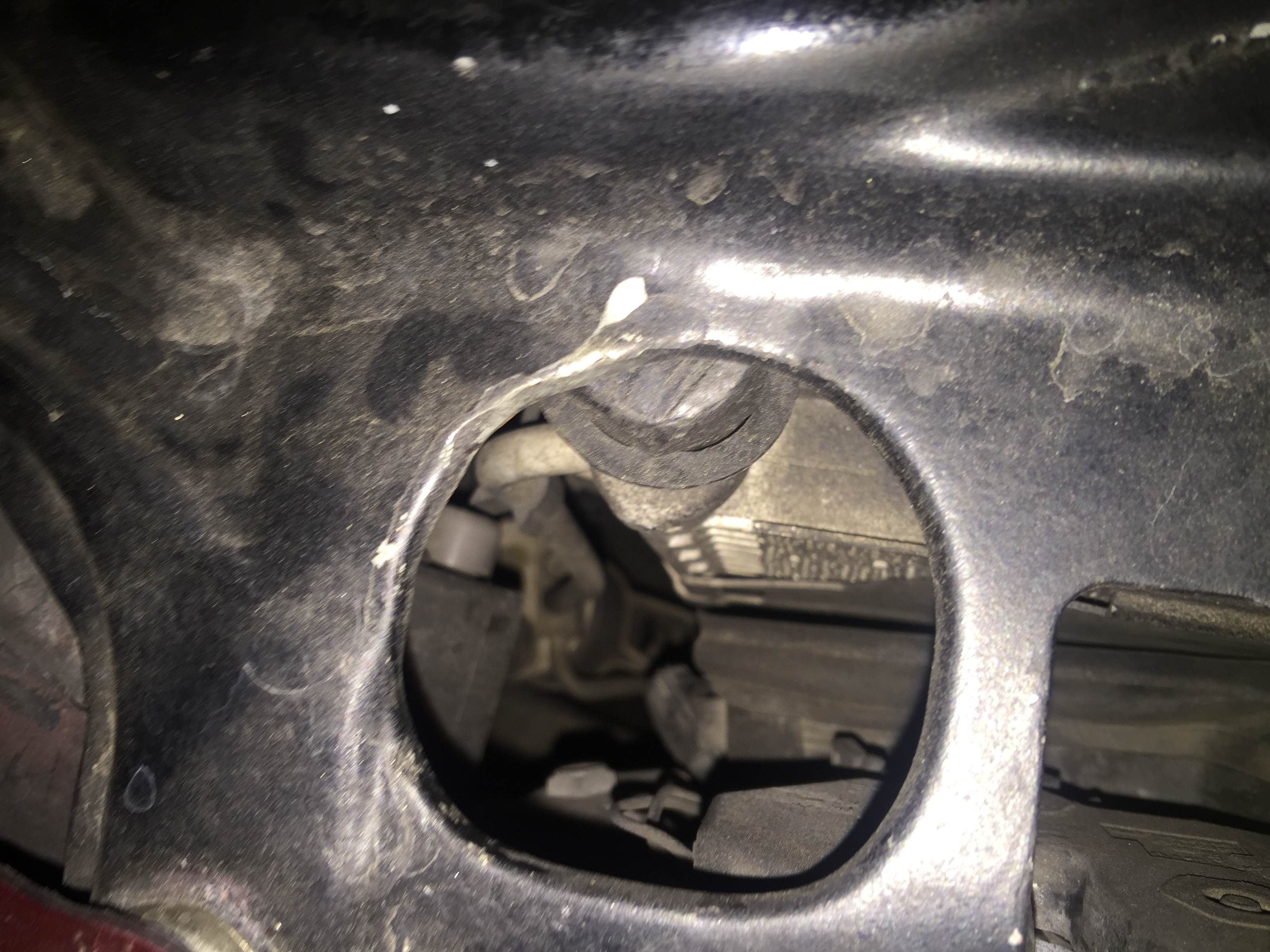

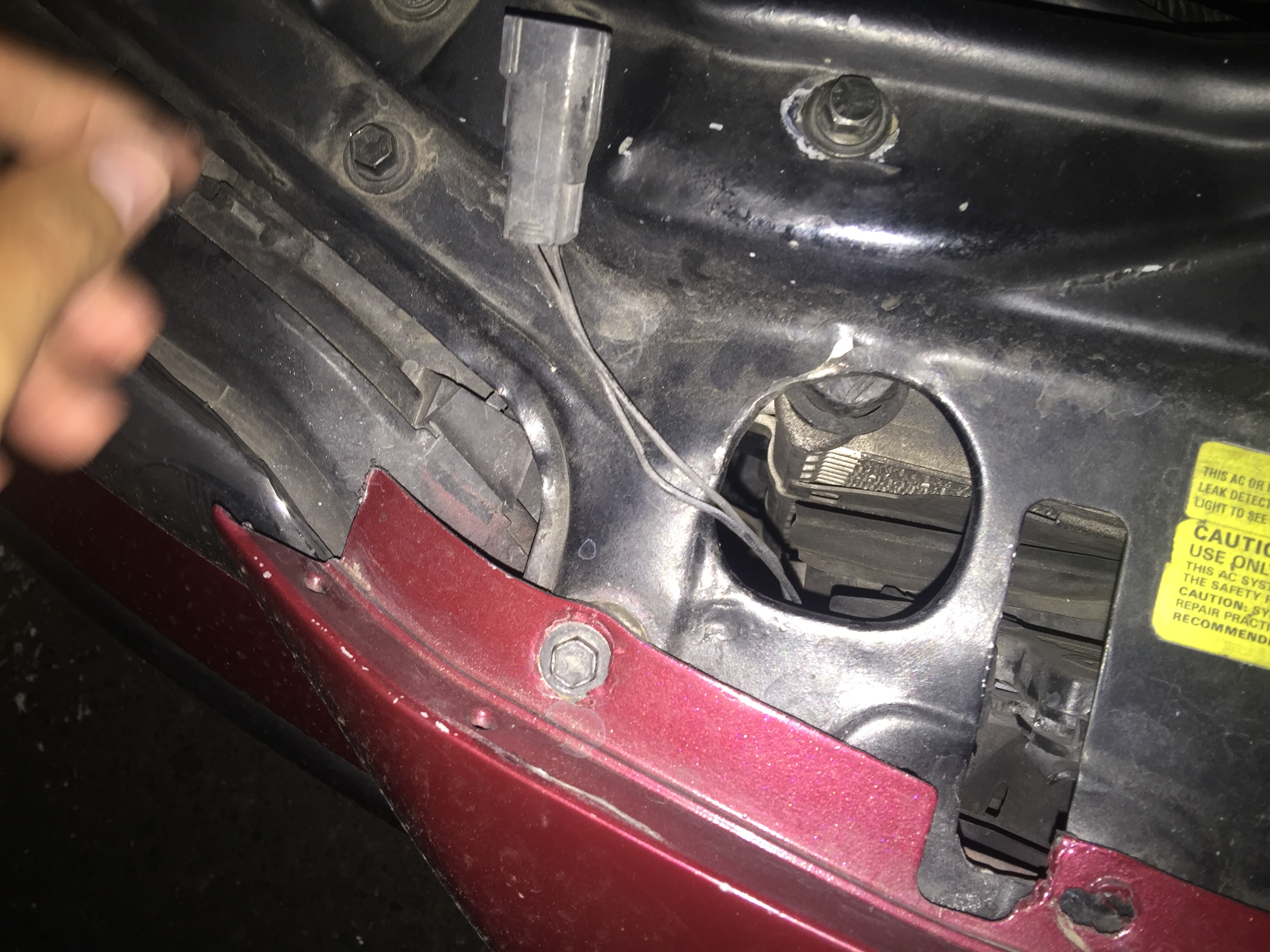

Ok so a little more investigation under the bonnet and look what I found! It doesn't solve the issue but it's a start
It looks like the connector for the switch built into the latch assembly on the passenger side. There's also a latch on the driver side, i imagine that also has a switch? If so, i need to trace down the wiring and find the other connector
