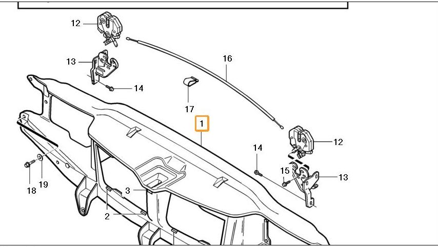

Yes Neil was right there is a separate cable between them. From the pic here I think there is a front 10mm bolt that can release the lock without having to undo the 3 side bolts

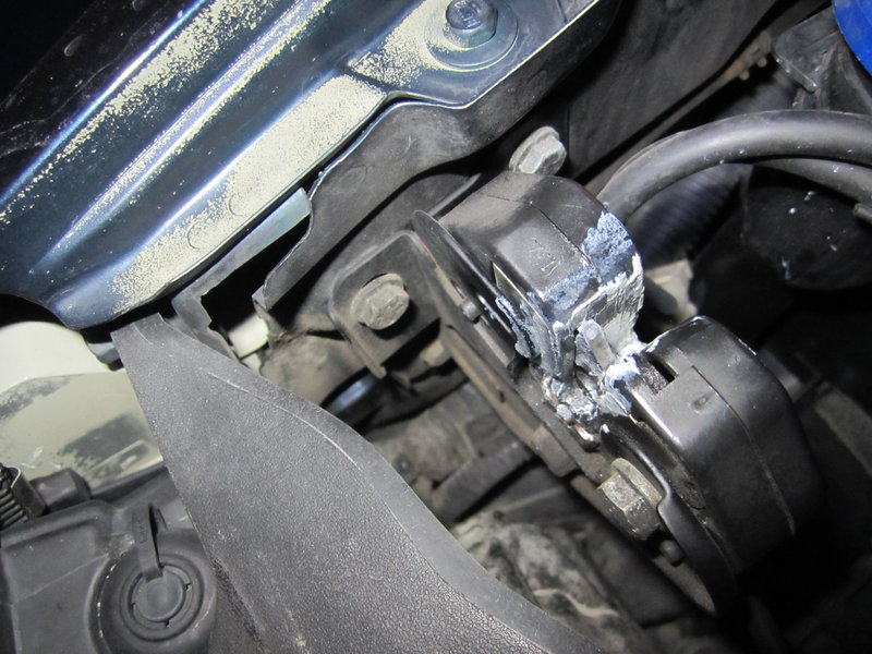

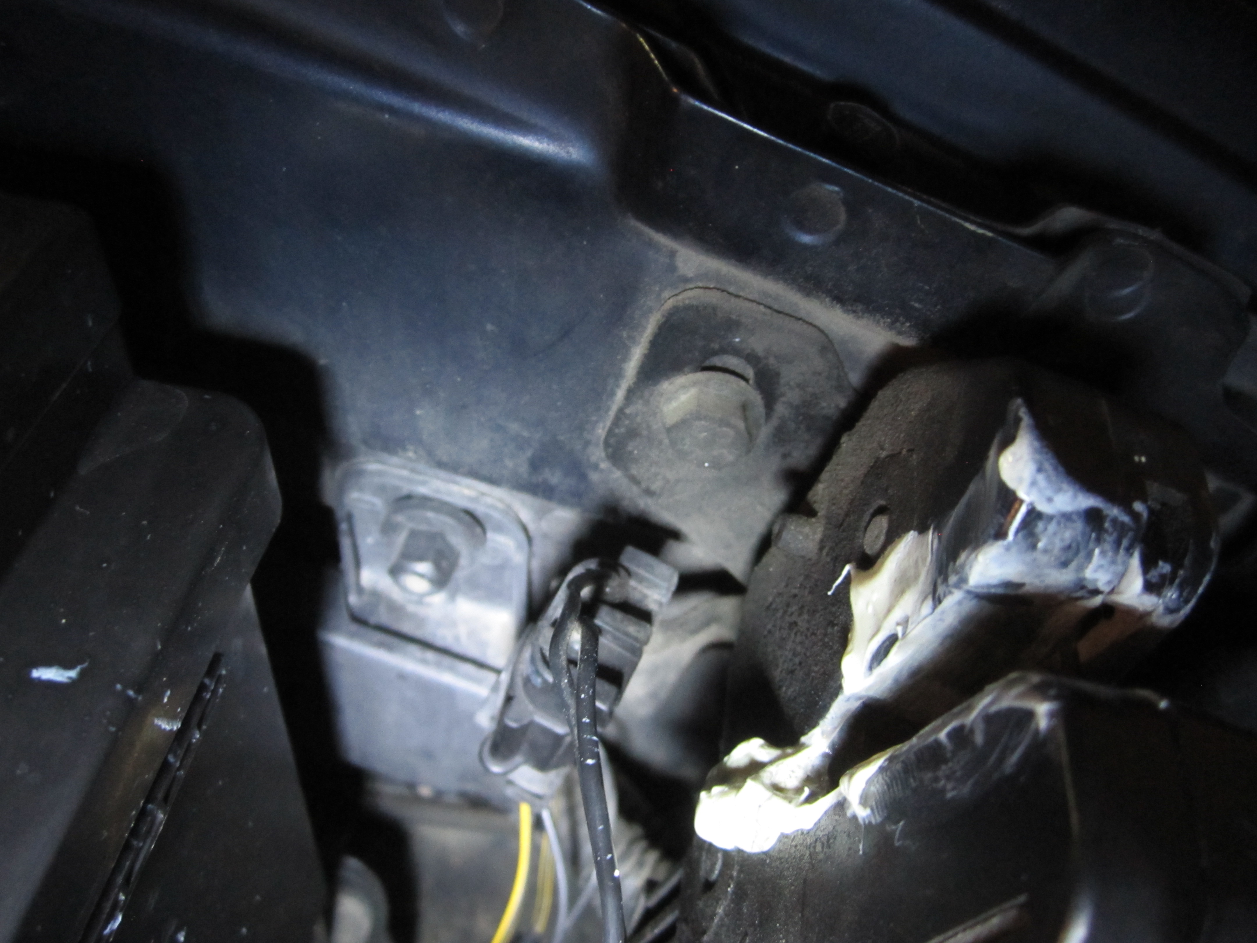

I've sent you the pictures directly, but added a few more here Mike.
This shows the RH latch on a LHD car. If you look carefully you can see the 3 mounting bolts. 2 parallel at the top and one toward the front of the car at the bottom of the latch bracket. It is a little blurred. The bear is to access the rear upper bolt as the latch is in the way.

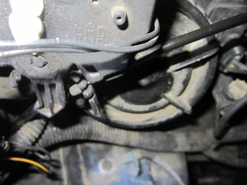

This attempts to show the 2 cables on the LH latch mechanism. Note the LH mechanism also has the contacts mounted for the alarm system. See photo below.
Hope this helps along with the great schematic of the parts already added above.
