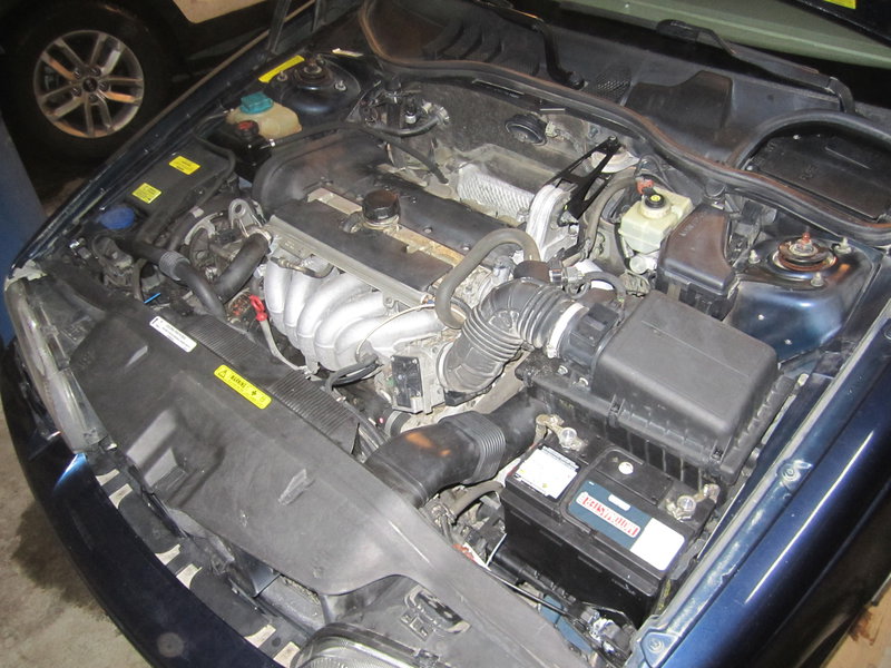

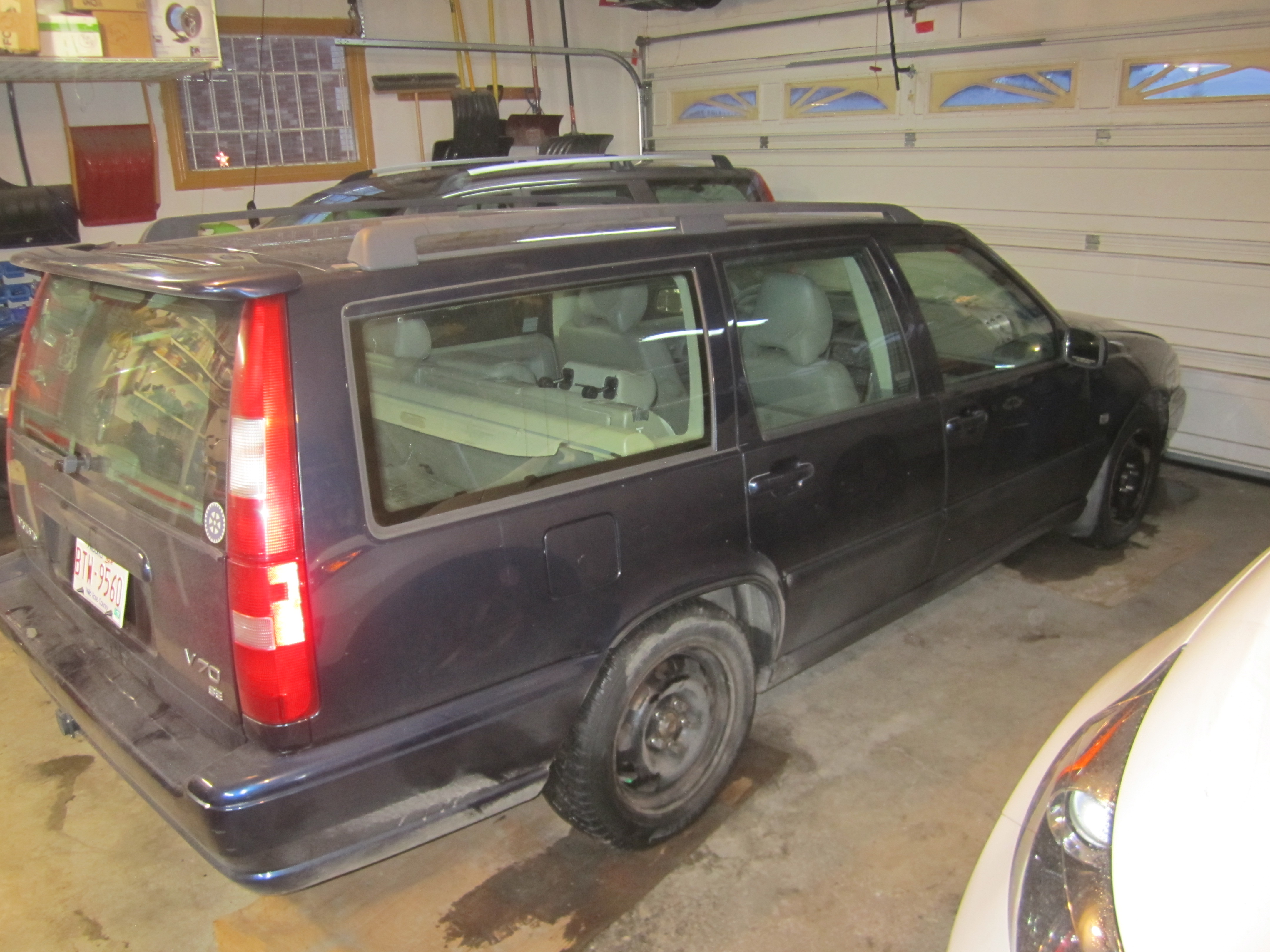

THE CAR
So what have I gone and bought? Probably close to the least desirable specification P80 as I could get! 5 speed auto (hmmm), non-turbo, and ETM. Colour is one of my favourites in Dark Blue. The advantage is it hides a lot of paint issues, and this one has a few! Some peeling paint on the rear bumper, a few scrapes on the rear of the trunk spoiler, some dents in the roof (loading/un-loading the top box??) and a 2-3 more small parking dents in the LH rear panel. Paint appears otherwise sound and no obvious body rot. Interior is beige leather and needs a good clean. The front door cards have de-laminated and need re-glued, and someone has done a poor repair to split drivers seat seam.

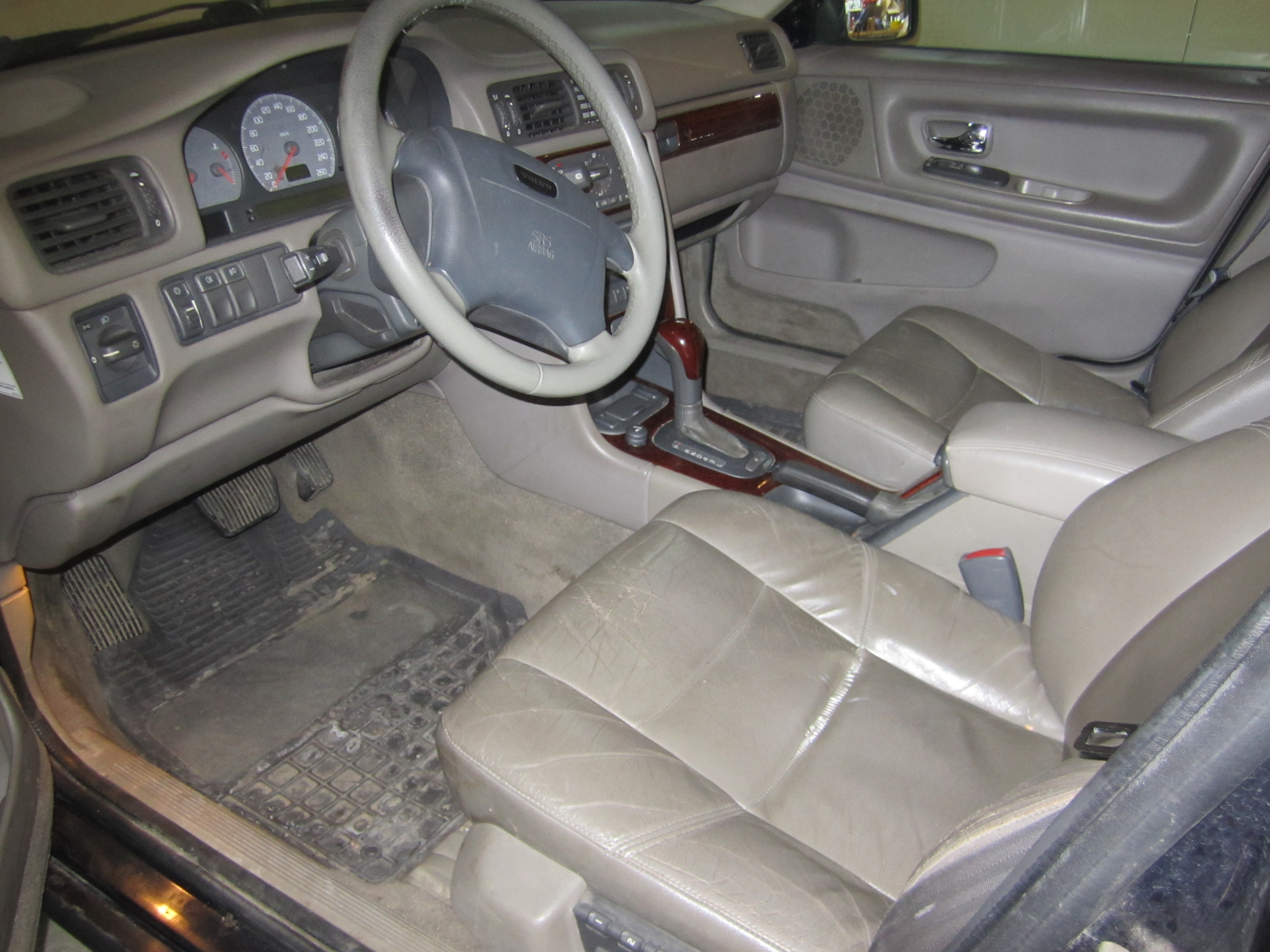

Other pluses are: SE spec, with roof rails, fog-lights, Homelink, leather, ECC, and an aftermarket tow hitch that is wired (could do with re-painting and wiring plug checked). Car has had the PCV system re-built 2.5 years ago by Volvo specialist, timing belt is not due for 3 years/70,000km), all rotors and pads have been replaced in the last 30,000km (fronts again in last 1000km).
The issues/needs:
- Rear shocks – one is very rusty and damp. I am assuming it has failed and hence the strange handling at the rear
- Rear parking brake is not working on LHS and average on RHS – cable is frozen
- Rear LH caliper is frozen. Hence strange braking, but repair shop replaced fronts?
- Needs a full service
- Trans issue fixed by dealer. Bad comms from corroded contacts on TCU.
- Top torque mount failed, and crank pulley mount separated
- RH outer CV boot failed
- Rear muffler mount rusted and sheared off
- Rear winter tires need replaced
- Front winter tires have been replaced but were left at 50+psi by installer!
- RH front door actuator failed.
That is the main issues and some dash lights need replaced but overall car has possibilities and
I like it has no moon-roof so I have more headroom! Car also ran really smoothly and the positive of the 5 speed auto is it accelerates quicker in gears as it stays on torque for longer.
Now looking at sourcing parts, and if I decide to keep will replace some other older but still functioning parts like rear rusted/saggy springs, rear flexi brake hoses (front already done).

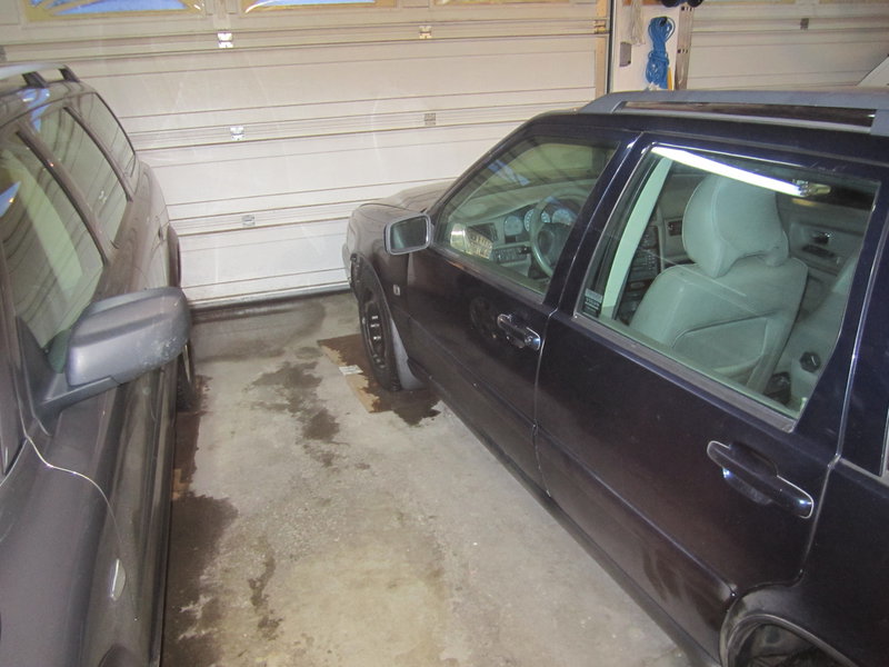

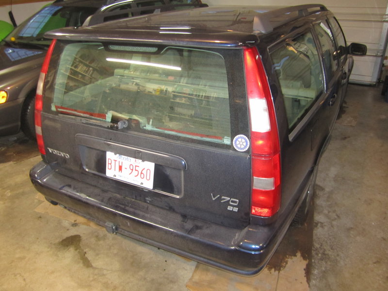

Pictures:
Sorry the pictures are not better but it was blow -20C and dark outside and roads are slushy!

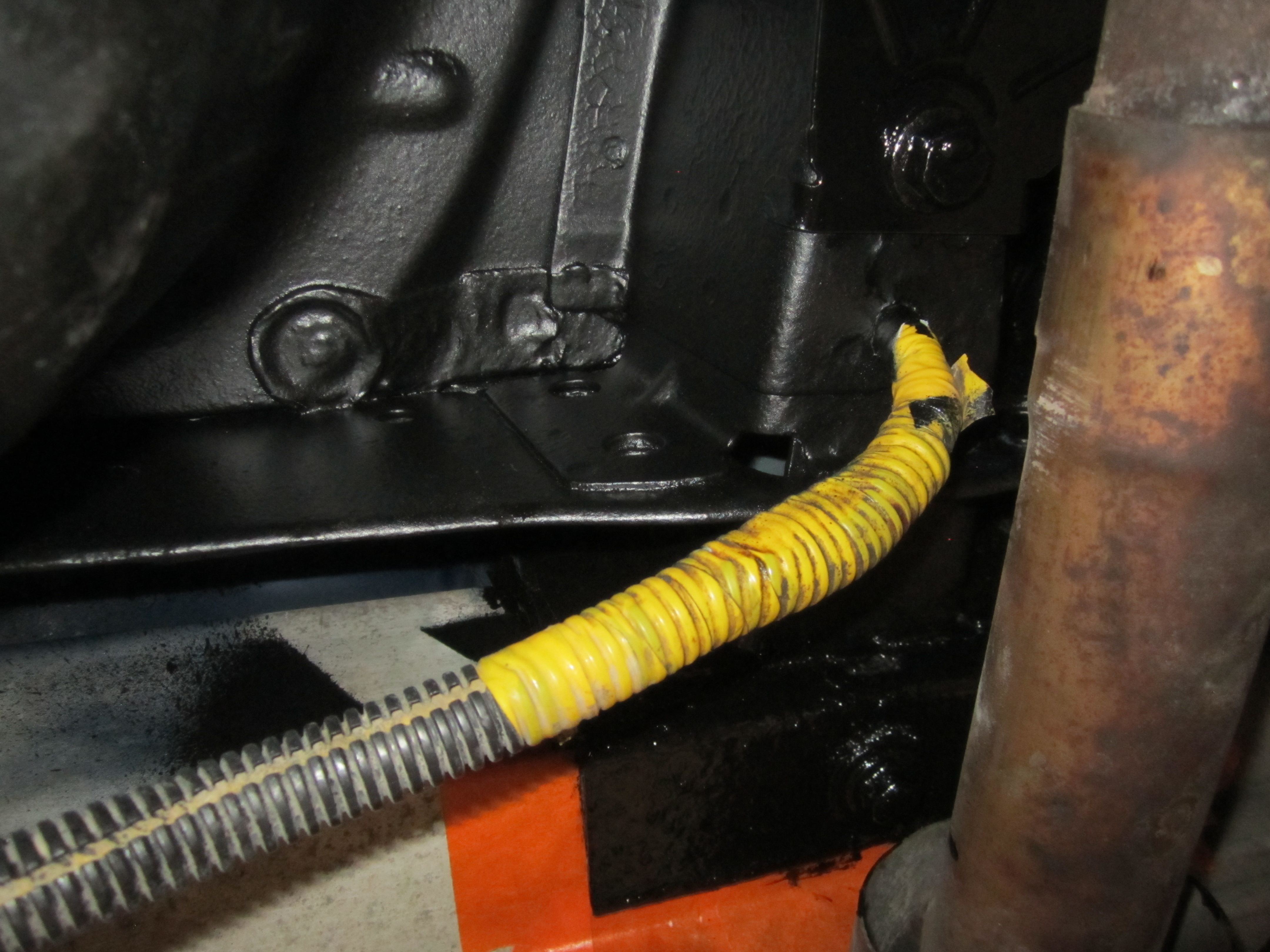

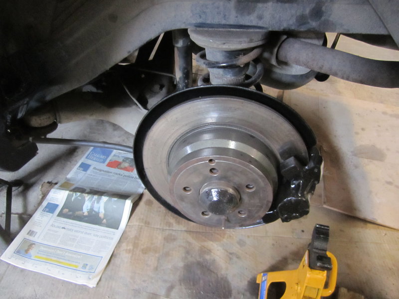

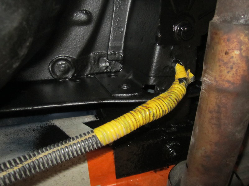

I have installed one of the Pro-Parts parking brake cables on the LH rear. Again, un-necessarily complicated job but relatively straight forward once you know how. Not now sure that AWD version is that much more difficult! One side done, but 2nd side is on hold as I found the 'J' pipe at the carbon filter above the rear axle to the rollover valve mounted to the side of it on the RH side is rotten. The breather pipe from the rollover pipe to the filler cap is also rotten and split. These can only be accessed easily with the fuel filter out of the way. Needless to say the filter looks like it may be the original!. Never seen one so rusty. The bracket is a flimsy piece of heavily rusted steel with a blot and a nut to a stud. There is little to access in a way of leverage to undo the nut on one side and the bolt on the other. Took me close to an hour (even having cleaned and soaked them in Deep Creep days earlier) to undo the 2 mounting points without breaking them. I'll not replace the mounting with a new one, but will have to order it.
That will delay the RH parking brake reassembly but it is all cleaned and ready to put back together.

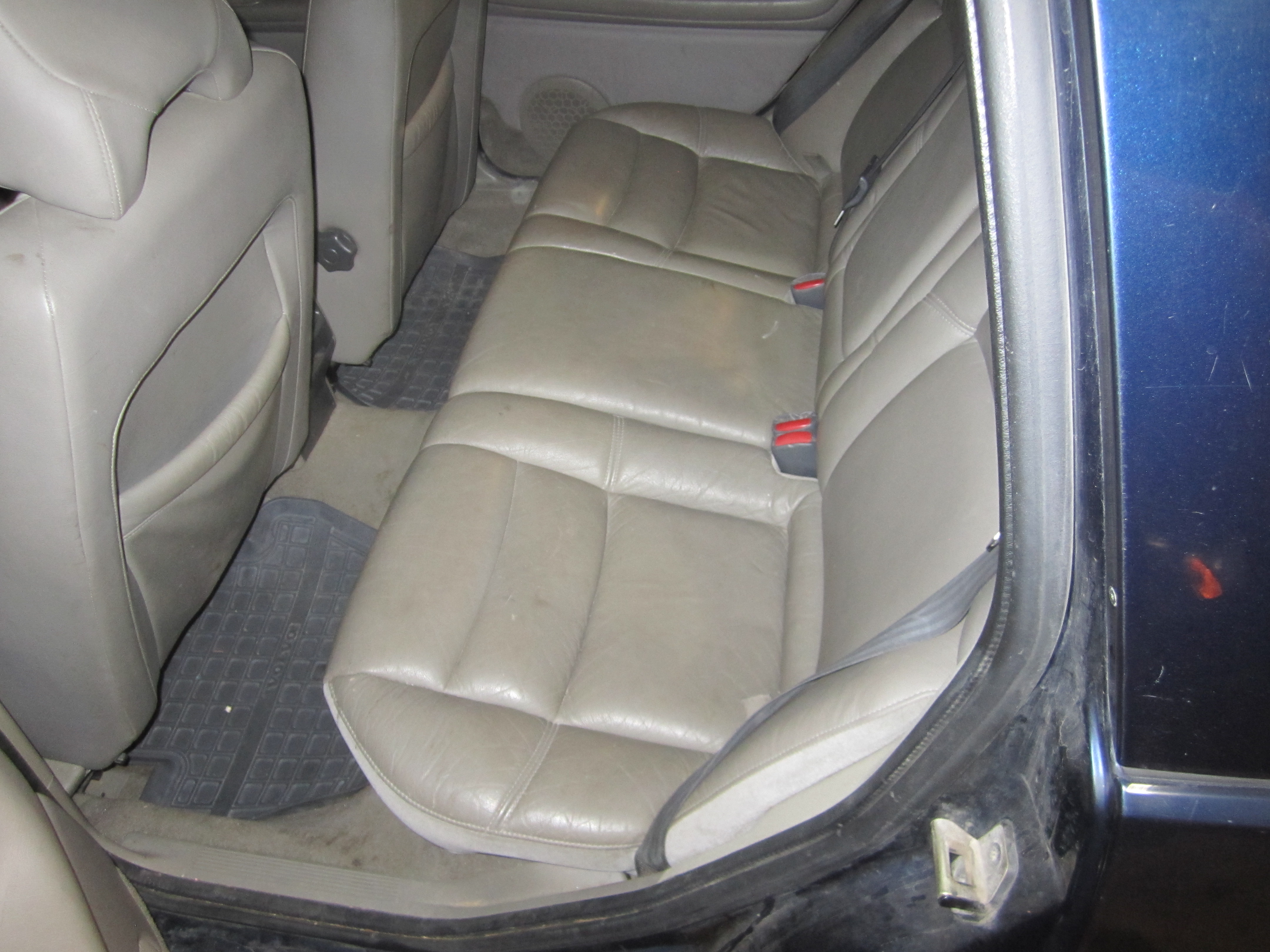

What took way longer than I have ever had before was to clean out under the rear seats which is something I always do with a 'new' car. Most owners never clean under there it would appear! This one is probably the worst as someone had spilt coke down the back of the seat so it was all over under the seat, the sound deadening material and in the rear floor area under your feet. Took ages to clean this out and get rid of the sticky residue. It had also coated the rear seat belt latch assemblies, and the easiest way to clean these was to remove them, dis-assemble and re-install. During this process found the center latch casing was cracked which was concerning. Fortunately I had a spare in the 'stash'!
Also found the car has the built in booster seat in the rear arm rest, but again this has been damaged by someone ripping the pull tab out of it. Thanks to Erik, this has now been removed and the cover removed for repair. Cleaning the interior is taking way longer than the actual repairs. I will eventually have to pull the 2 front seats to steam the spilt coffee that has been left in the carpet either side of the center console. Gross!

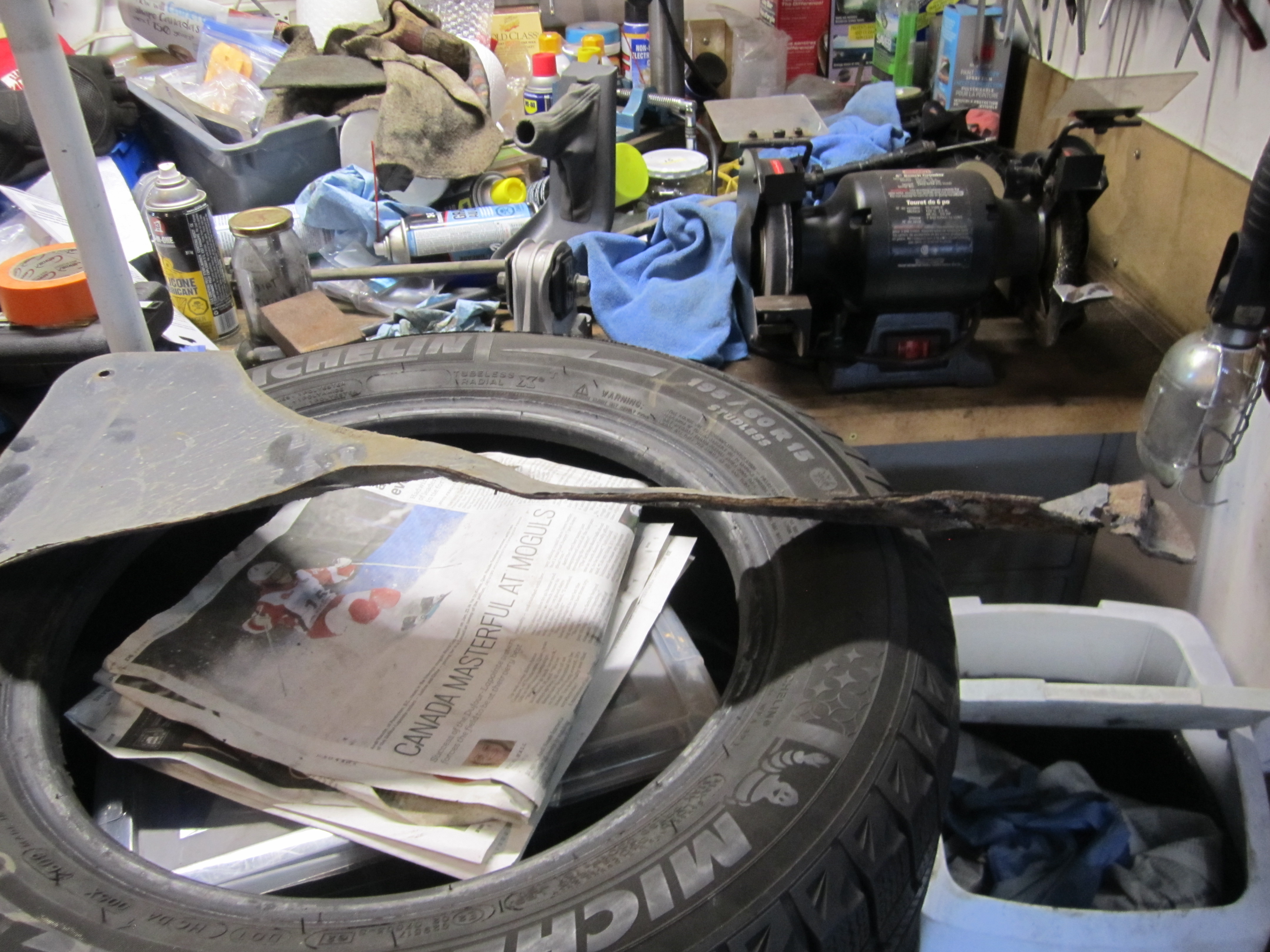

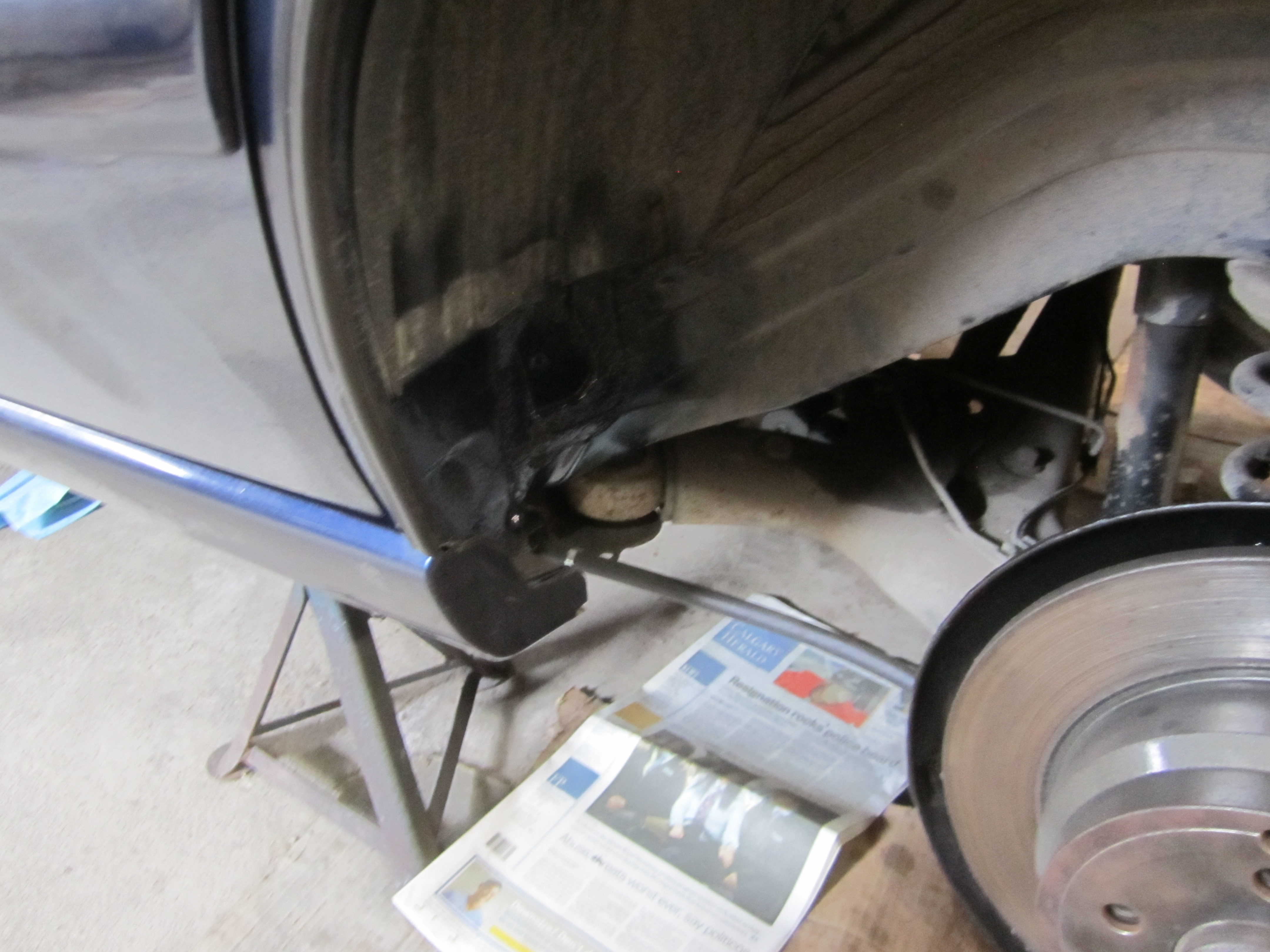

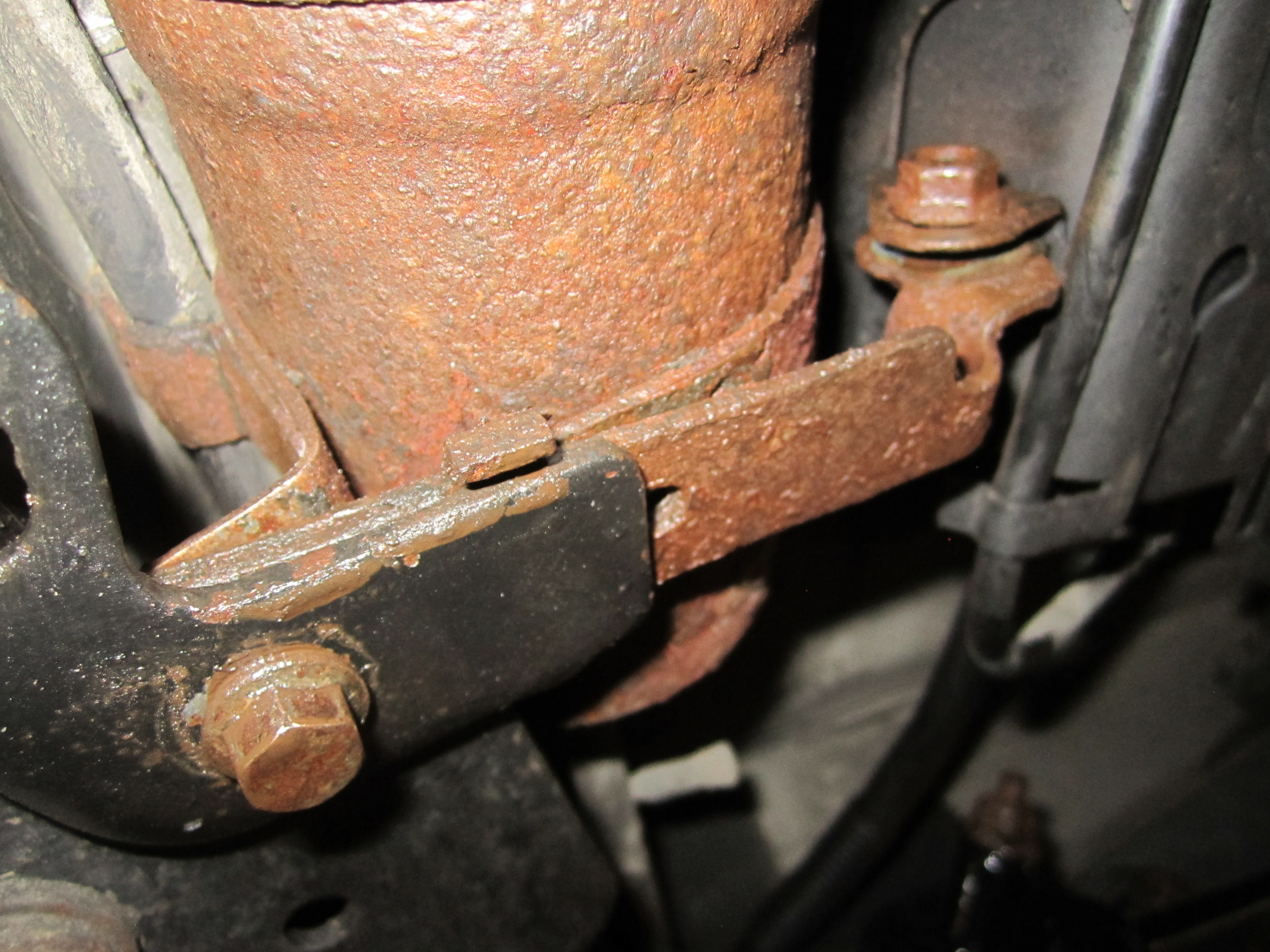

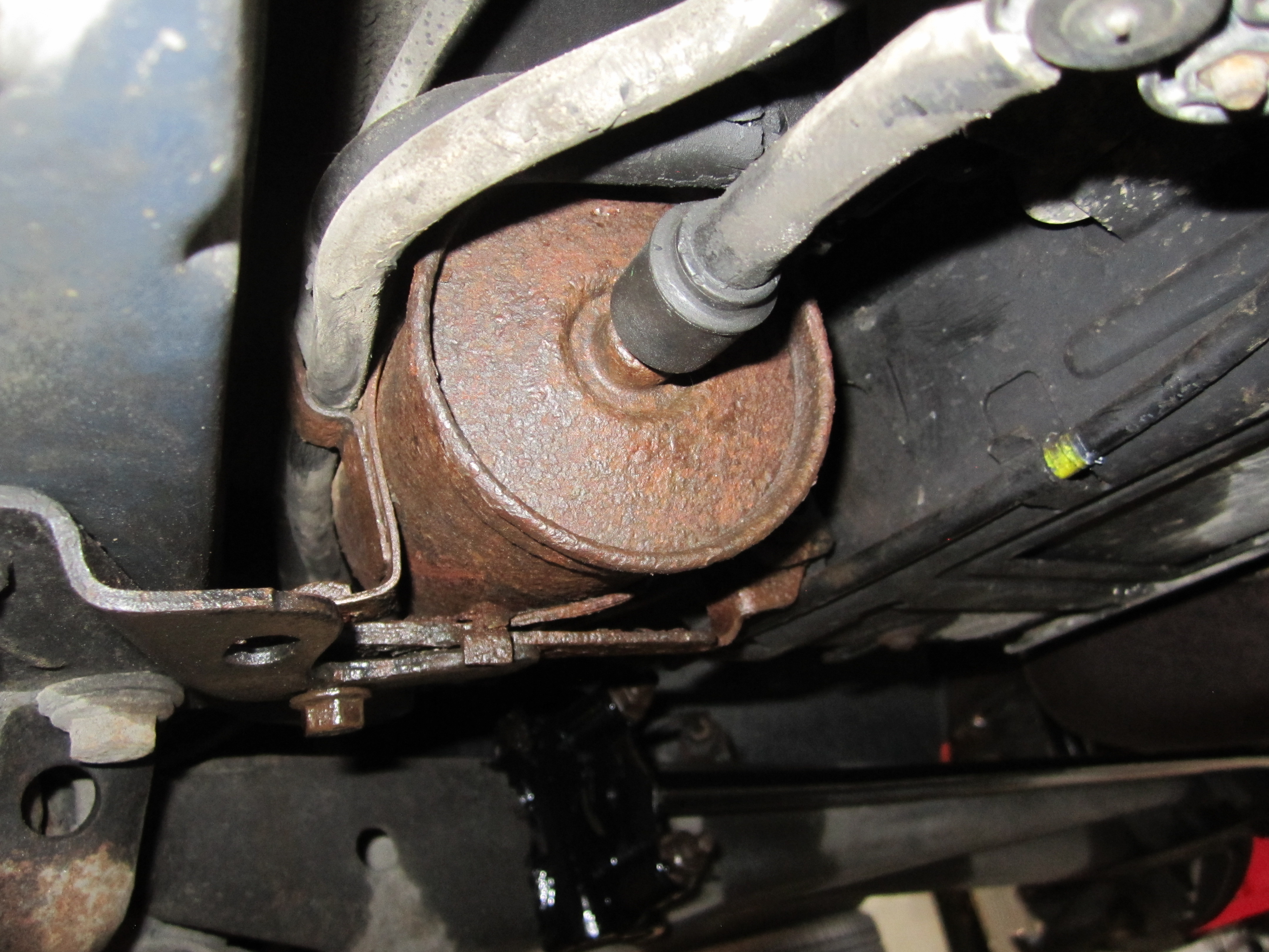

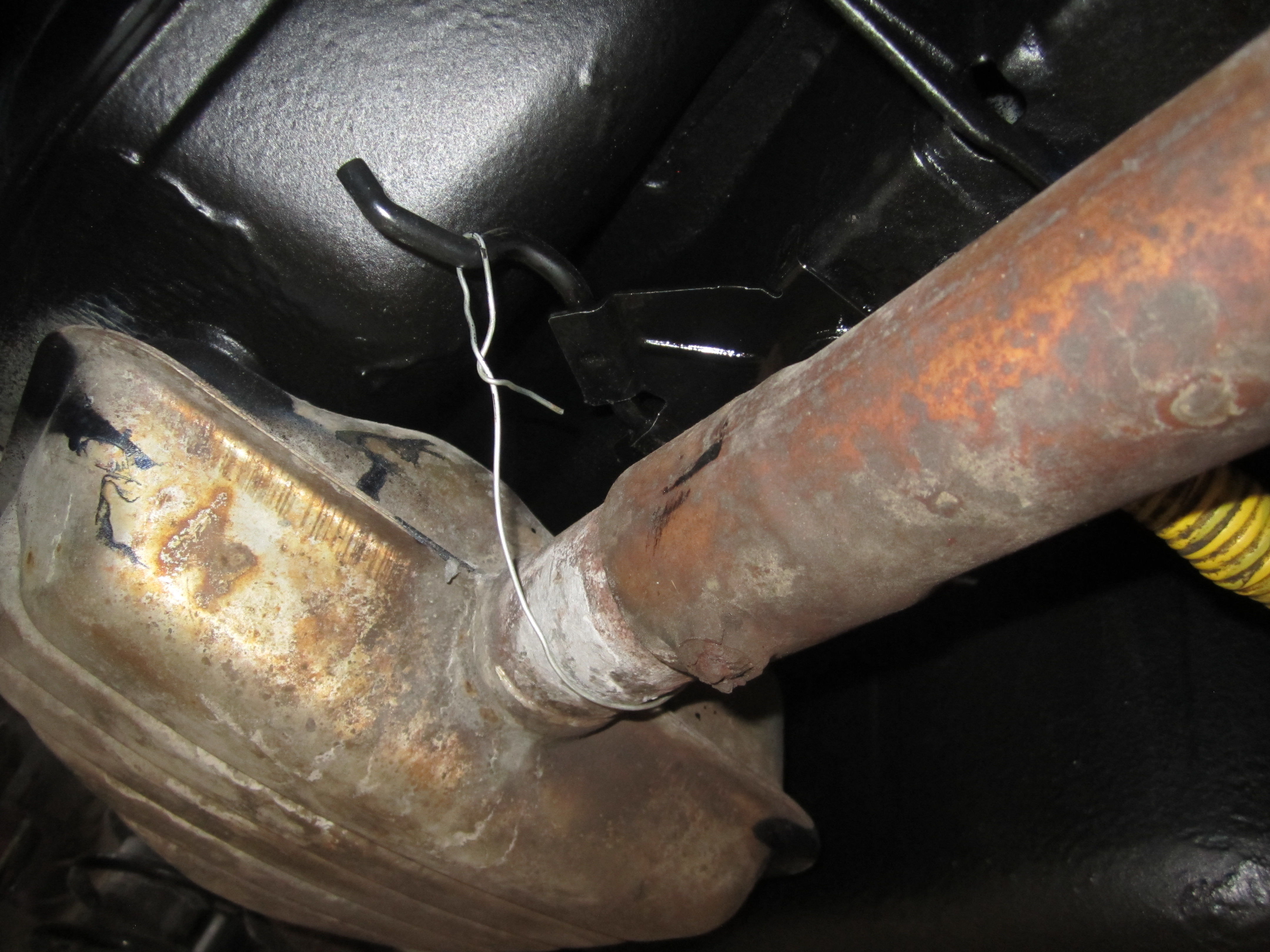

While under the car I found the rear muffler mount was broken off. Rust I am thinking may have been the culprit, and it looked like someone had done a half-assed job of trying to pigeon weld it back on. All they had achieved was leaving a very hard residue to grind off. Again good old FCP has a repair mounting kit from OEM for this. It is a ring bracket that mounts in place of the original welded item. As the original bracket that the rubber mounts go to that bolts to the underside of the LH chassis rail was terminally corrodes I am replacing that with an OE new part coated with POR-15 first. Hopefully that will all go back together tomorrow.

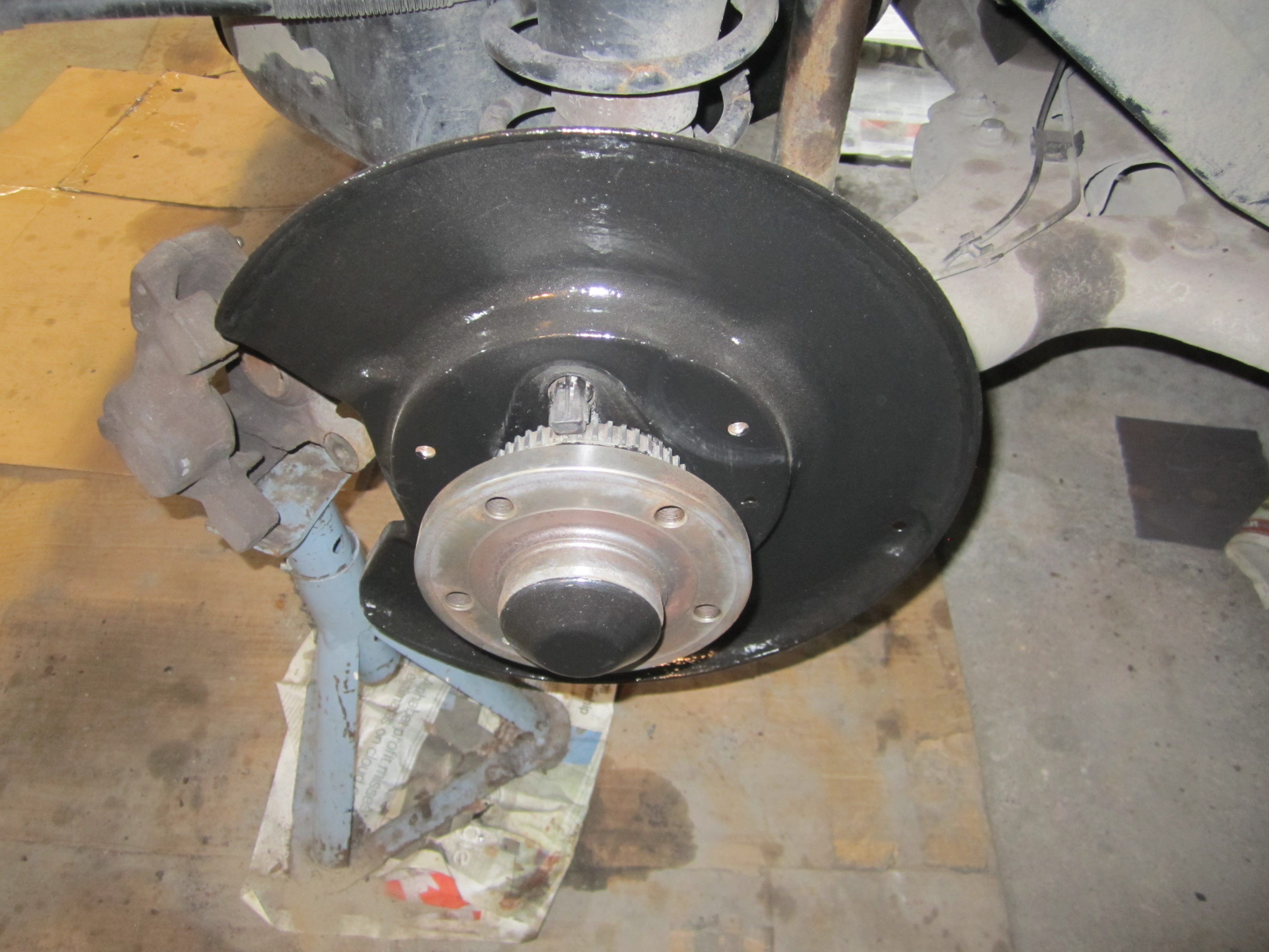

I had planned to remove the rear anti-sway bar and tow bar for powder coating, but having found you have to disturb the mounting bolts for the LH rear suspension alignment, I have de-rusted the bar in-situ and again it is getting 2 coats of POR-15.
Again, while under the rear I found evidence of surface rust starting on both rear chassis rails at the rearmost ends near the bumper mounts and all the way to the rear edge of the wheel arches. The car for some reason only has front mud-flaps so the gravel on the roads here in winter had ground all the paint and coating off behind and in front of the underside of the car by the rear wheels. This has all been ground back to bare metal, rust treatment used, 2 coats of primer, 2 coats of top coat (with built in clear coat) followed by 2 coats of anti-chip rubber coating. I did this on my 'R' when it was in bits, but n that case I used the body coloured paint over the anti-chip, but in this case the car has a lot of black protection badly splashed around under it so I have reversed the 2 last coats. Now looks great under there!! Actually better than new as there was only evidence of primer and a splash of top coat in those areas. Amazing it has lasted so well over the years!
Last things to do at the rear is to replace the protection plate to the rear of the fuel tank. This has taken some abuse and it totally rotten. OE part was fairly cheap so I'll put that in. Require one Torx screw to be removed and the tank supported while the 2 mounting straps are loosened so the plate can be slipped under the straps. Then the last job (hopefully for now) is to replace the rear shocks and springs. I have soaked the mounts in preparation for removal.

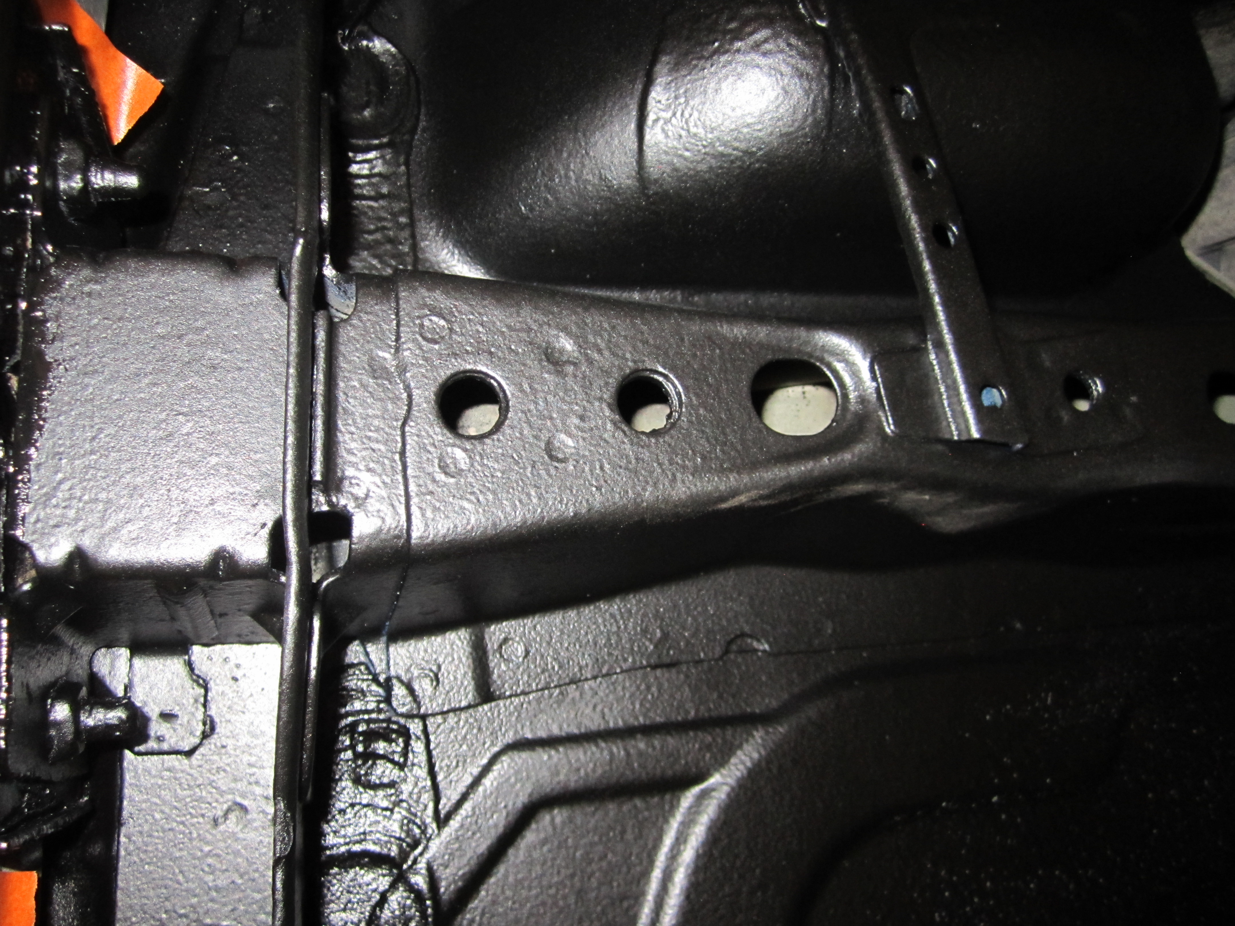

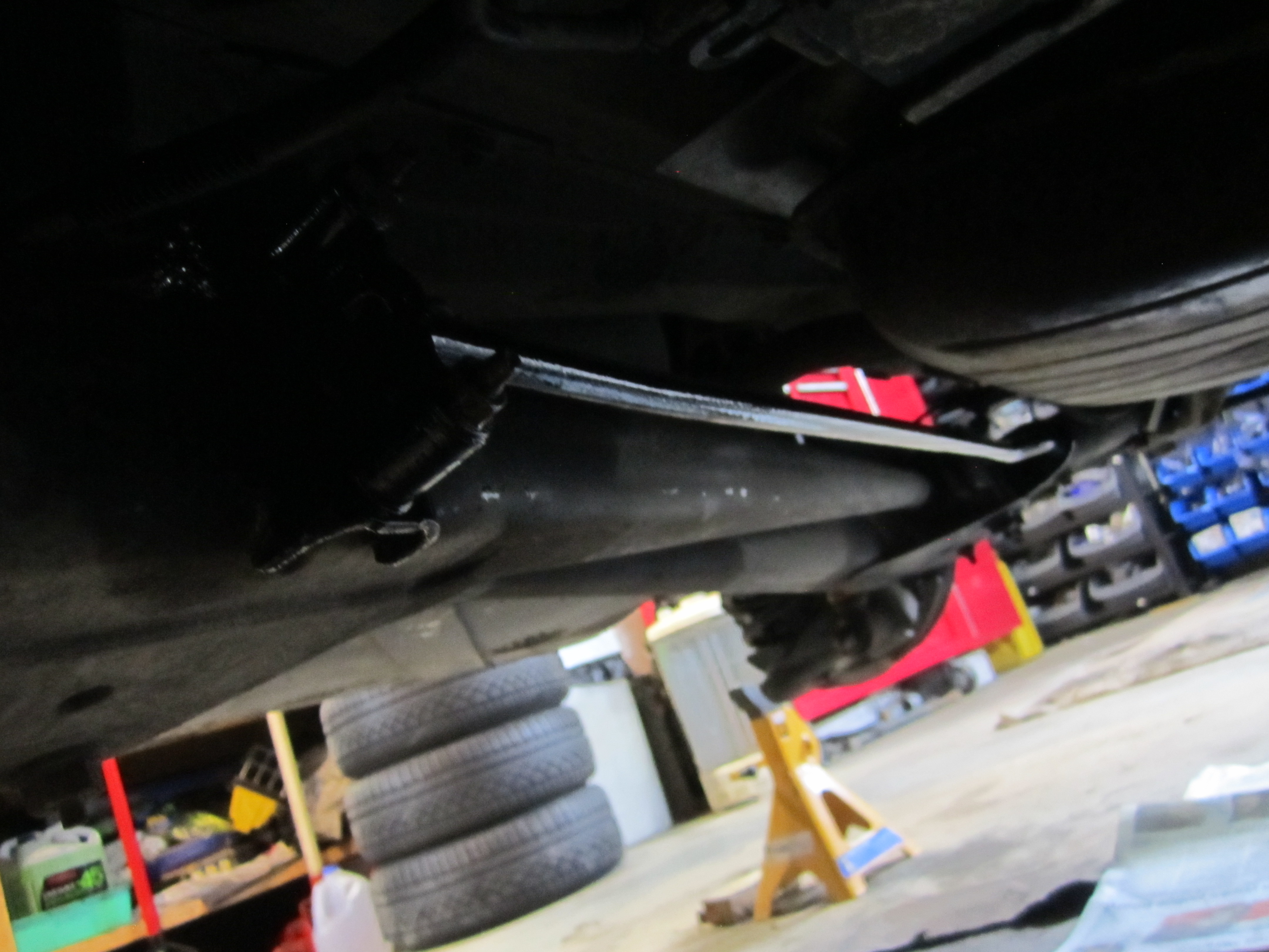

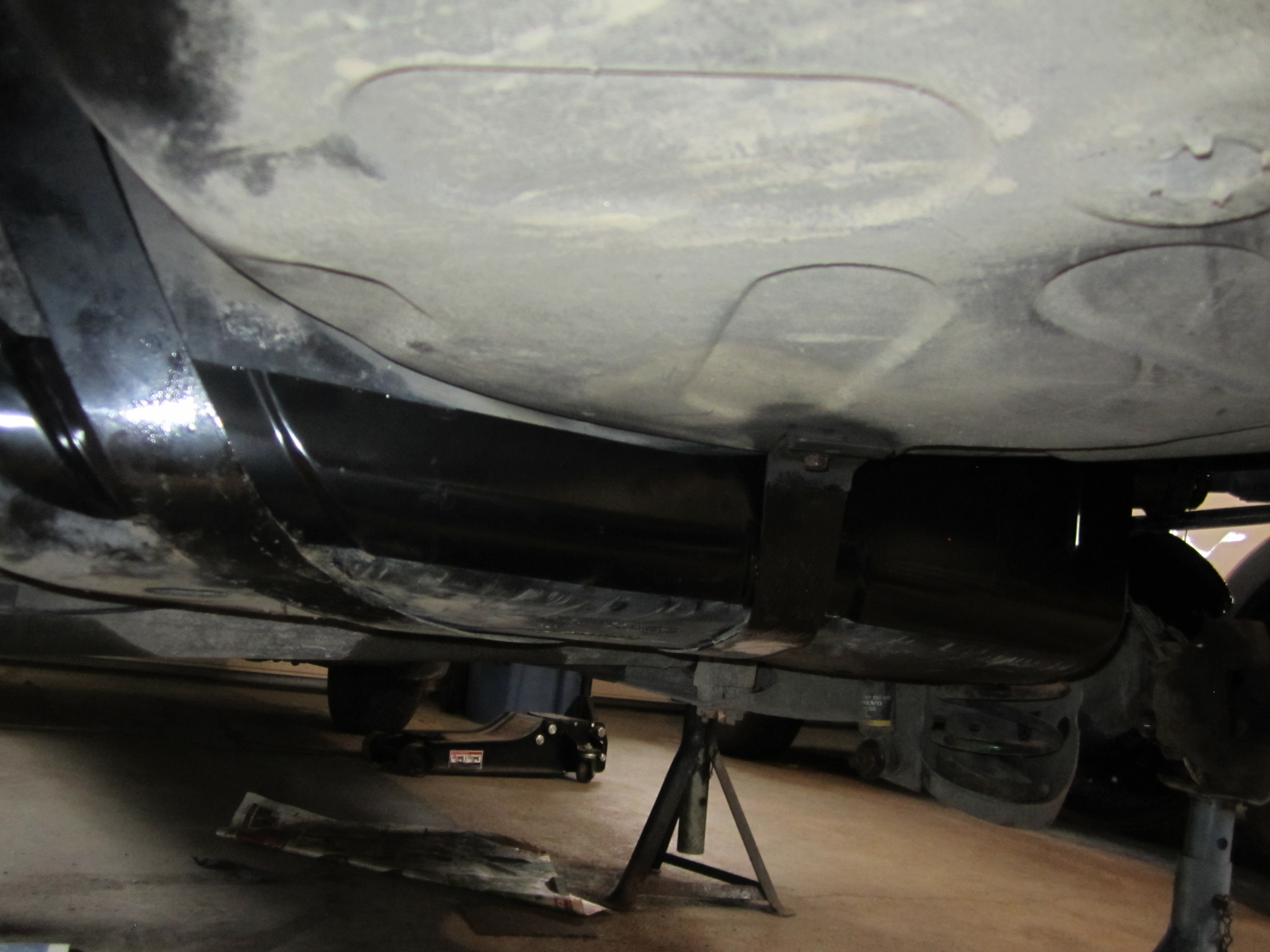

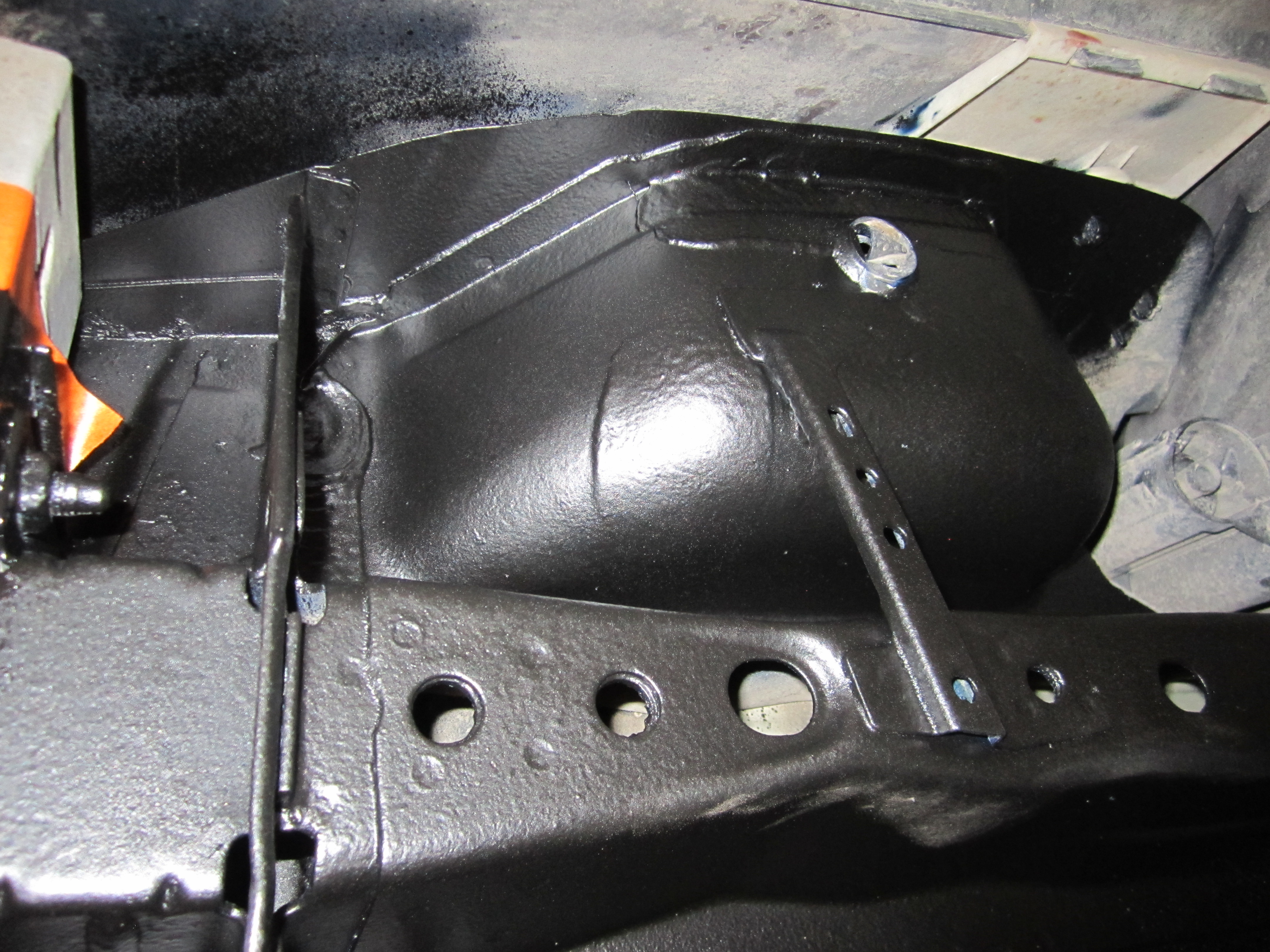

I've made some time to add some pictures of the (slow) progress. As I've said before, I always find it amazing how some vehicle owners manage to damage/break stuff that I'm not even sure how you can do so to!

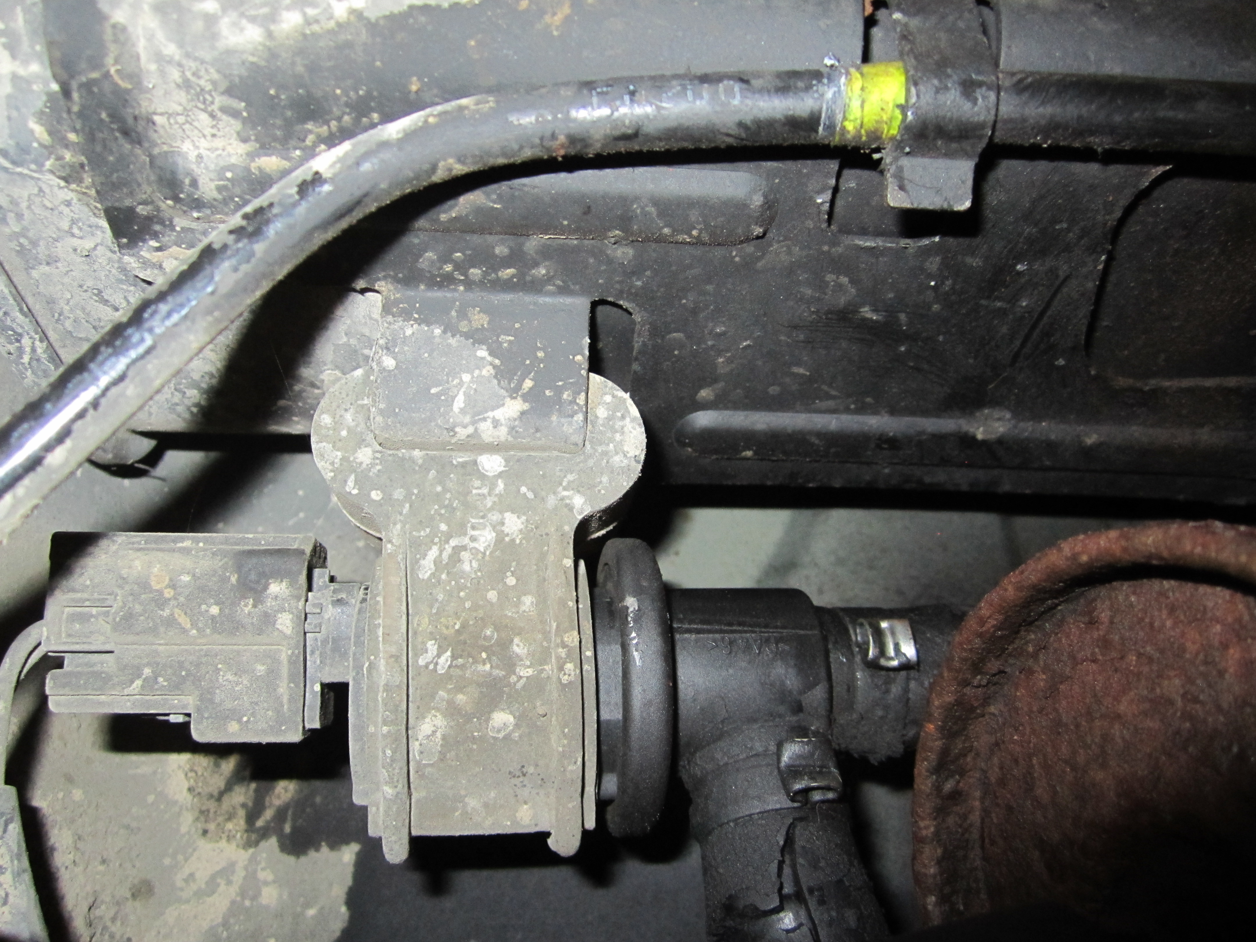

First couple of pictures are of what is called a protection plate for the rear of this V70 wagons fuel tank. As this is at the rear, how on earth do you hit this to bend it the way it has been?!:
The edge closest to you in the picture should be almost dead straight!!
What should have been a 15-20 minute job took over an hour as the one mounting screw in the top right of the 1st picture had been almost completely torn out of the fuel tank by the plate being hit. Had to clean and re-install using JB weld epoxy.
Then the 2 tank straps had to be carefully re-shaped so they actually were touching the fuel tank as the were bent on the rear lower edges.

One of the few mechanical jobs I have been able to get to so far is tackling the rear brakes, and in particular the parking brakes and cables.
The LH rear parking brake was not working, and not knowing what the issue was I ordered 2 replacement Pro-parts cables as part of a huge parts order to FCP.
On stripping the brakes, I found the brake pads were stuck in place which probably explains the strange braking the car had. The rotor was in good shape, as were the Volvo pads on the LH side. I had also bought replacement Textar parking brake shoes. I have had good performance from these in the past and they are fairly cheap. For another $9 or so, I also got a replacement hardware kit for the parking brakes from TRW.
Removing the rotor I found the reason the parking brake was not working was the smaller spring retainer at the top of the shoes was missing which meant the shoes were not able to be adjusted correctly. Removing everything, I found the spring behind the wheel bearing. The original cable was very rusty at the point where there is a retaining screw just forward of the rear tires. Pulling the cable was a pain as there is very little room to grasp the cable to pull it out at the hub. I drilled out the pop rivet holding the plastic protection plate from the rear of the dust shield to give more room. Also it would make cleaning and painting the dust shield a lot easier. The cable fought me and eventually the end at the hub broke off, but learning from this when tackling the other side I sprayed plenty of Deep Creep on both the outside and inside of the hub and worked it and the RH one came out intact.
I cleaned the back/dust shields with a rotary wire brush and then 2 hammers to chip the rust pieces off. The back plates were then stabilised with rust preventer and left for 24 hours, before cleaning it off with water and a sponge and allowed to dry before spraying with caliper cleaner and then coating with Dupli-color gloss black caliper paint. When dry the parking brake parts were cleaned and re-assembled with original parts and supplemented with new if required. With the rotor cleaning and de-rusted, it was re-fitted as was the caliper and it was also painted.
Below is a picture of the LH side completed:
RH side has all been repaired and painted ready for re-assembly but I am holding off fitting the new parking brake cable as it gives better access to the fuel filter and the 2 pipes that need to be replaced to the roll-over valve.
While working on the LHR brakes I found gravel wear had remove the paint and protection to the panel at the front of the wheel arch. This was cleaned treated and painted with anti-chip paint:
While under the rear I found the starting of surface rust on the 2 rear rails near the bumper mounts. These were cleaned back to bare metal, 2 coats of primer and color coat with clear, followed by 2 coats of anti-chip. This now has the rear of the under-floor area in better condition than new as there was only primer and a splash of top coat.
The wire is to hold the muffler in position until I can find a solution to the non-fitting repair mounting bracket for the rear of the muffler system. The repair part bought from FCP under the OEM brand has an I/D minimum of 2.25" and the muffler has an O/D of only 2". I have now ordered on OE Volvo item to see if it fits. I suspect it will be the same, and if so I will take the car t a muffler shop nearby to weld it in place. Volvo part shows same part # for both NA and turbo mufflers. I suspect the repair part may be for a turbo muffler system.
The RHR brakes are now on hold until I can repair the fuel pump bracket and the 2 rubber hoses above it to/from the roll-over valve
It took an hour to undo the 2 mounts for the fuel filter bracket as it is so badly rusted it is paper thin. I tried to order a new one but they are on back order. Typical!!
You can see the rotted hose below the roll-over valve. I will also replace the 'J' hose from the end of the roll-over valve to the carbon filter as these can only be accessed with the fuel filter removed. I may have to re-use the original fuel filer mount until a new one is available.

After the easy success of yesterday and the planned 20 minute job 'only' taking 1.5 hours due to extra damage to the fuel tank mounting straps and the torn mount on the fuel tank for the plate, I decided to tackle another 'simple' job. Most jobs for an old fat guy are a challenge under these cars and having taken an hour a couple of days ago to loosen the mounting bolt and nut for the fuel filter bracket (naturally on back order with no ship date forecast!), I decided to bite the bullet and remove the filter and bracket and see if the bracket can be salvaged for now and I can fit the new bracket when it arrives.
Naturally the fuel filter pipes were very reluctant to come off as probably on the original filter (see condition of the filter in last post!) I managed to spill only a small amount of gas on myself. Now to the straight forward part of replacing the 2 hoses at the roll-over valve. Naturally the position of the oetiker clamps made removal impossible while in place. Nothing else for it but remove the whole carbon filter assembly and repair off the car and re-install. All went well until trying to remove the smaller vacuum pipe on the rear of the carbon filter. The larger one I expected to be difficult as crap gets in the mechanism and it can be a challenge. But no! It came off fairly easily. Now to the smaller pipe. No way in $##@++@ hell would it release, no matter what I tried. Ended up having to leave it on and drop the carbon filter with it still attached and hope it doesn't break.
After more engineering words of encouragement I managed to get the rear 'J' pipe clamp off the filter body. and then remove the whole roll over valve for cleaning and it made it easier to get the 2 other hoses off. Cleaned it and re-attached the 2 hoses(both original hoses were split), and went to re-fit it to the carbon filter to find the Oetiker clamp wouldn't fit. I thought I had been smart as when I had to fit the 'J' hose on the 2000 'R' the Oetiker clamp at the carbon filter was way too big, and ended up fitting the same size at the other end at the roll-over valve. This time it is the reverse and the one at the carbon filter would not fit as it was too small. Bugger! No problem I must have the correct one somewhere from that debacle. Not to be found anywhere, and then I recalled using all the spares I had on the PCV system on the last project the 850 PCV system. So I'll have to get the correct one tomorrow when hopefully the muffler mounting repair kit may be in at the dealer.
This as actually taught me the to stop cursing the AWD P80's (some of the time) as this job is more accessible especially on the later versions. It is like the rear flexible brake hoses (all 3 of them). Totally in-accessible on the FWD cars and difficult but accessible on the AWD cars.
