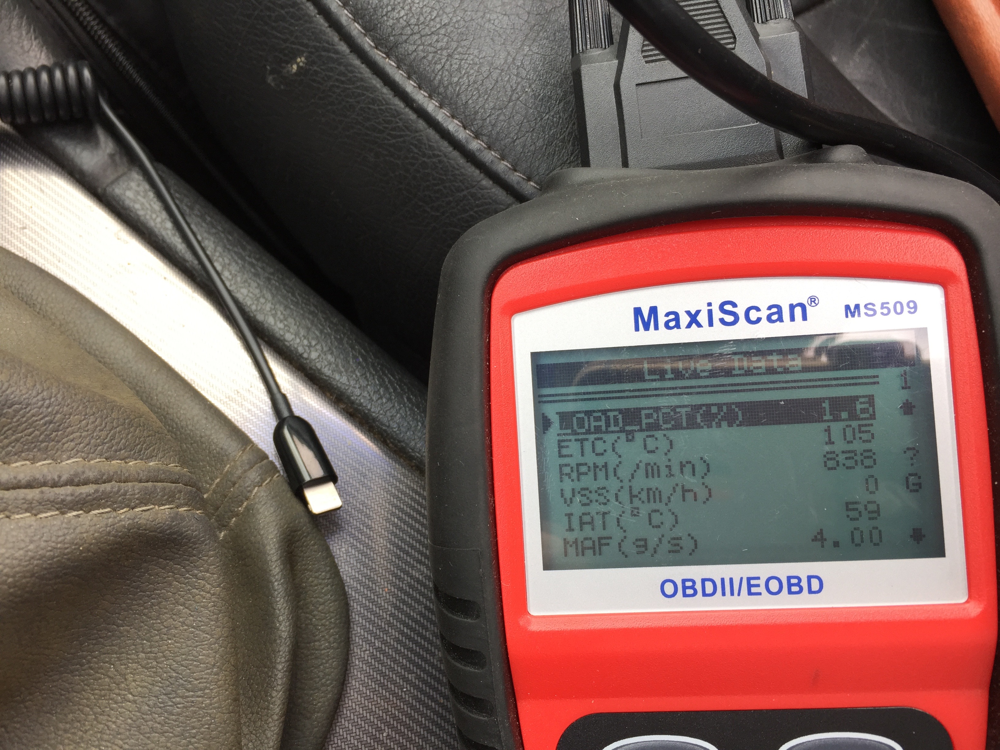

July 2015 - temperature about 80F perhaps?
Engine fan cycles ECT between 105C (fan turns on) and 85C (fan turns off) while engine idling.
MAF of 4 gram per sec at Idle
MAF 14.75 g per sec at 110 kph/2645 rpm
1999 V70 T5 ECT MAF readings at idle, at 110 kph
