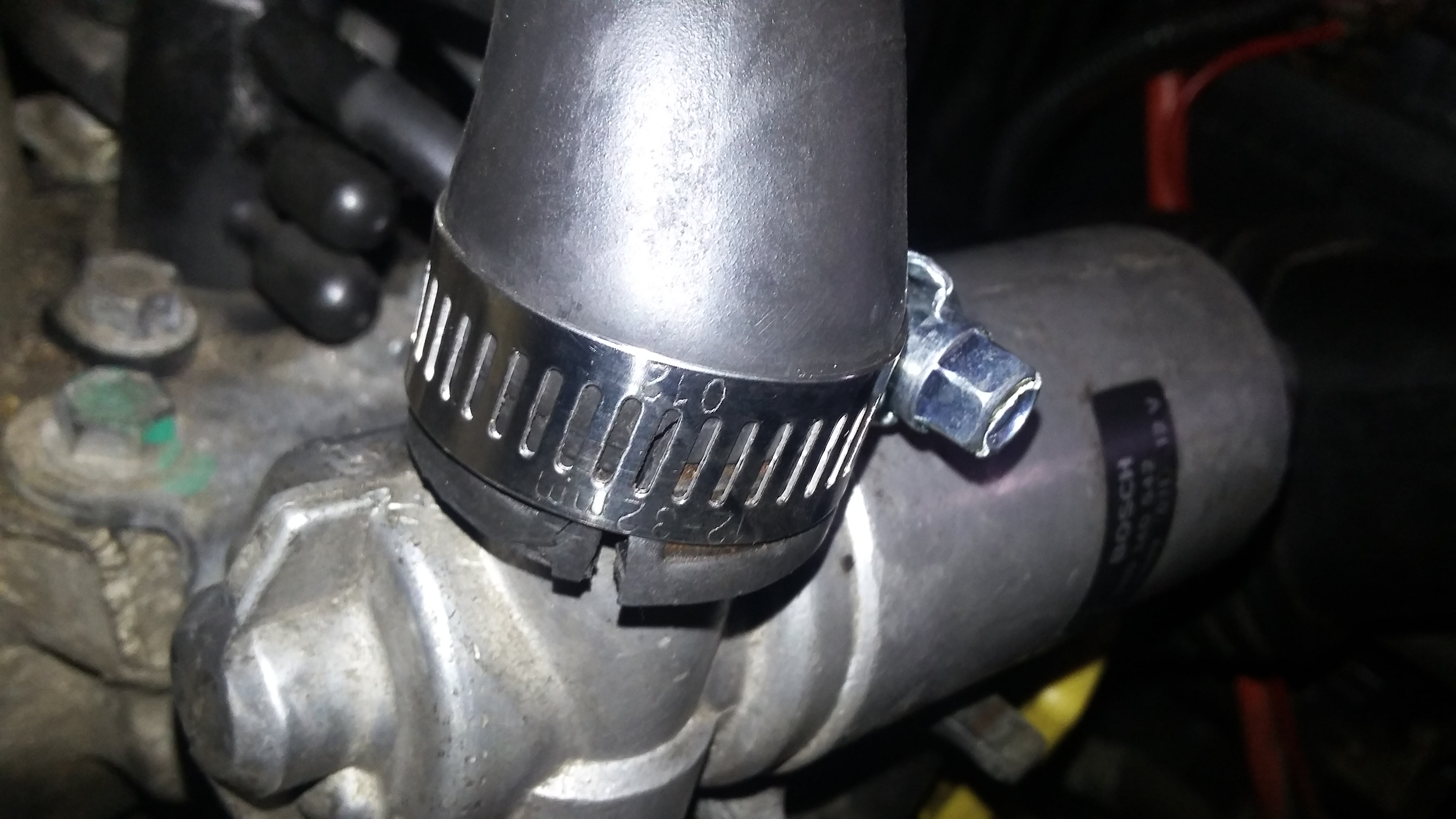

That hose shouldn't be a big issue, but you should replace that soon. As long as the crack isn't all the way up to where it can leak and it's over the fitting.
Still, it might be something to consider as the problem. Definitely a possible leak.
