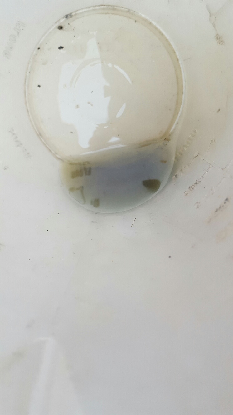

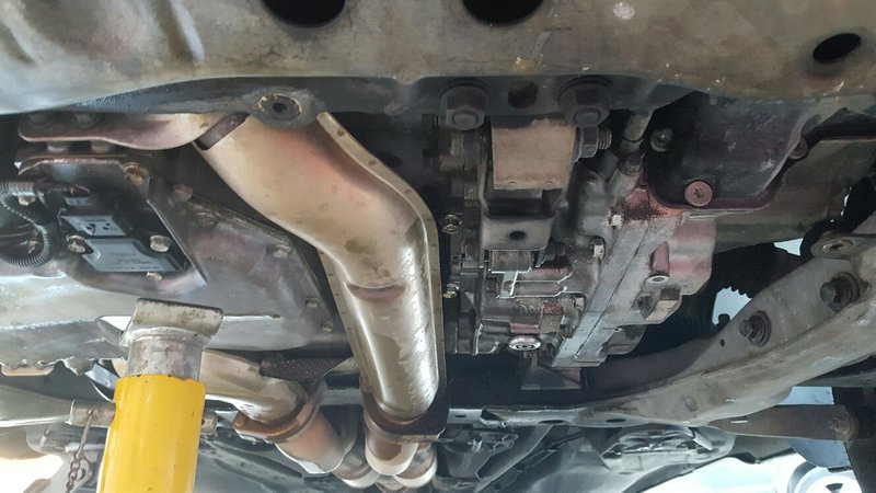

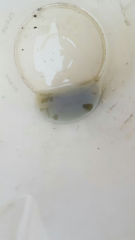

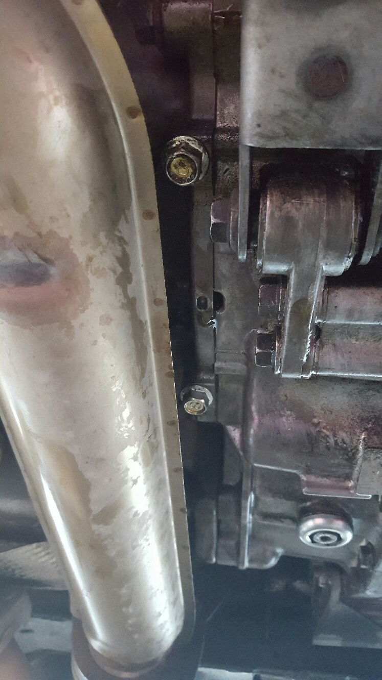

Everything has more or less been fine with the car till now. I do have a lot of air in the power steering when cold and when I went to try to find the leak today I noticed a HUGE puddle of fluid on the floor. It is dripping regularly from the little hole in the transmission casing. When I wipe it up it seems to start from the hole instead of travelling down the side of the casing. I collected some of it in a container and it looks to be a green color. The texture is also not like engine oil but more like power steering fluid. My power steering resevoir was either under pressure or vacuum when I cracked it open (it went "hiss"). So my current suspicion is a power steering fluid leak - which would align up with the source of air in the system on cold start. But I can't for the life of me figure out why it would be leaking from the location it is.
I am hoping the transmission fluid should be red and that this is not a tranny leak.
Can anyone please help me with this?
I have attached some pictures to show the location and color of the fluid.

I put some UV die in over night and it was heavily stained at the input to the power steering pump, I then found the die was also dripping from the same location under the transmission casing. Strange that it can travel so far. Thanks for the suggestions I will replace the hose and see if that cures it. Do you know if I can get away with getting a length of hose from Autozone? Is it possible to miss the aux belts without the factory bends in the pipe?
