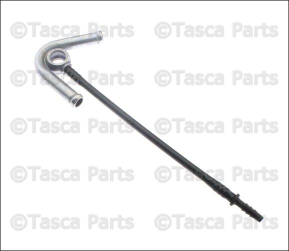

That's not the part I'm referring to chrism. That part number you quoted doesn't include the vacuum hose.
The part includes the plastic pipe and is a different part number 30731007 and includes the plastic hose in case it is broken during manifold removal.
I see that it's now listed as a 5 cylinder part and it should be. 3 years ago when I bought it for my 2001 XC70 it was officially an S80 or XC90T6 part. Nonetheless the part number hasn't changed. If you look it up on Vida 2012b it is only an S80 part so it must have been updated to suit other models after the "cheat" was discovered by 5 cylinder mechanics. If you look up any of the PCV components on Vida for a 2001 XC70 you would be buying the entire coolant pipe at about $160 in a genuine part (9470330) IPD USA has a cheaper non-genuine alternative though.
I agree with chrism about cracking the banjo bolt while the manifold bolts are still reasonably tight.
