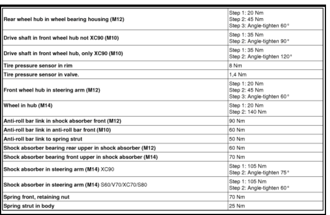

Could you please provide me with the toque specs for the top not and 3 small nuts that hold the strut in place.
Also could you please provide me the torque specs for the rear shock top nut and small nuts that hold the rear shock mount in place.

I'll look up those torques and reply here
