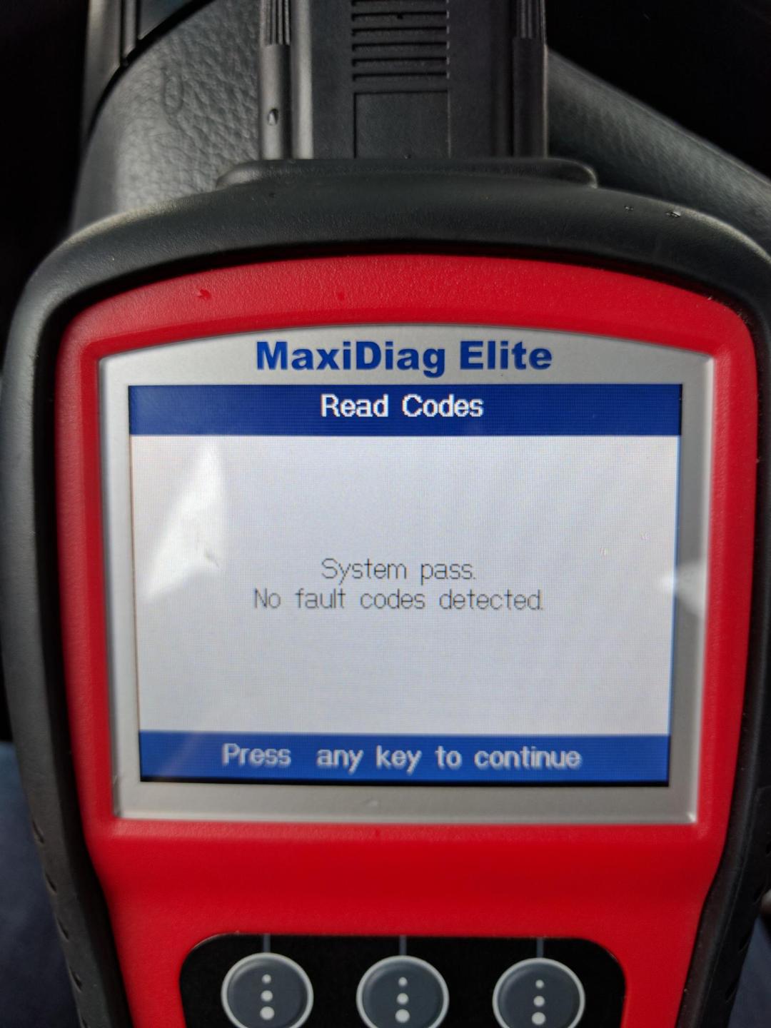

Low and behold, if obtained a used, undamaged, undeployed module in working condition with identical part number. You can swap it and restore communication in the system and raise no fault codes whatsoever. (No evidence that Vida won't show faults however. I will try and report back at a later date with my friend who has it.)
We got a module for $75 USD. Instead of $1000 new at the dealer.

I do agree, your totally right on that! With something like that it's best safe than sorry . However. On so many occasions I've had a friend use his Vida/dice software when needed right after using my own md802 tool when don't have time to work on a car due to work. And it produces no extra codes or faults. This is my experience so far... And I could be wrong, so I wouldn't argue there. So even then, take the secondary precautions and have the dealer double check the module after the fact if your worried. Or better yet, skip the SRS/airbag situation entirely and just look at what it means in the picture of the limitations claimed by Volvo to stop the potential repairs by end user.
