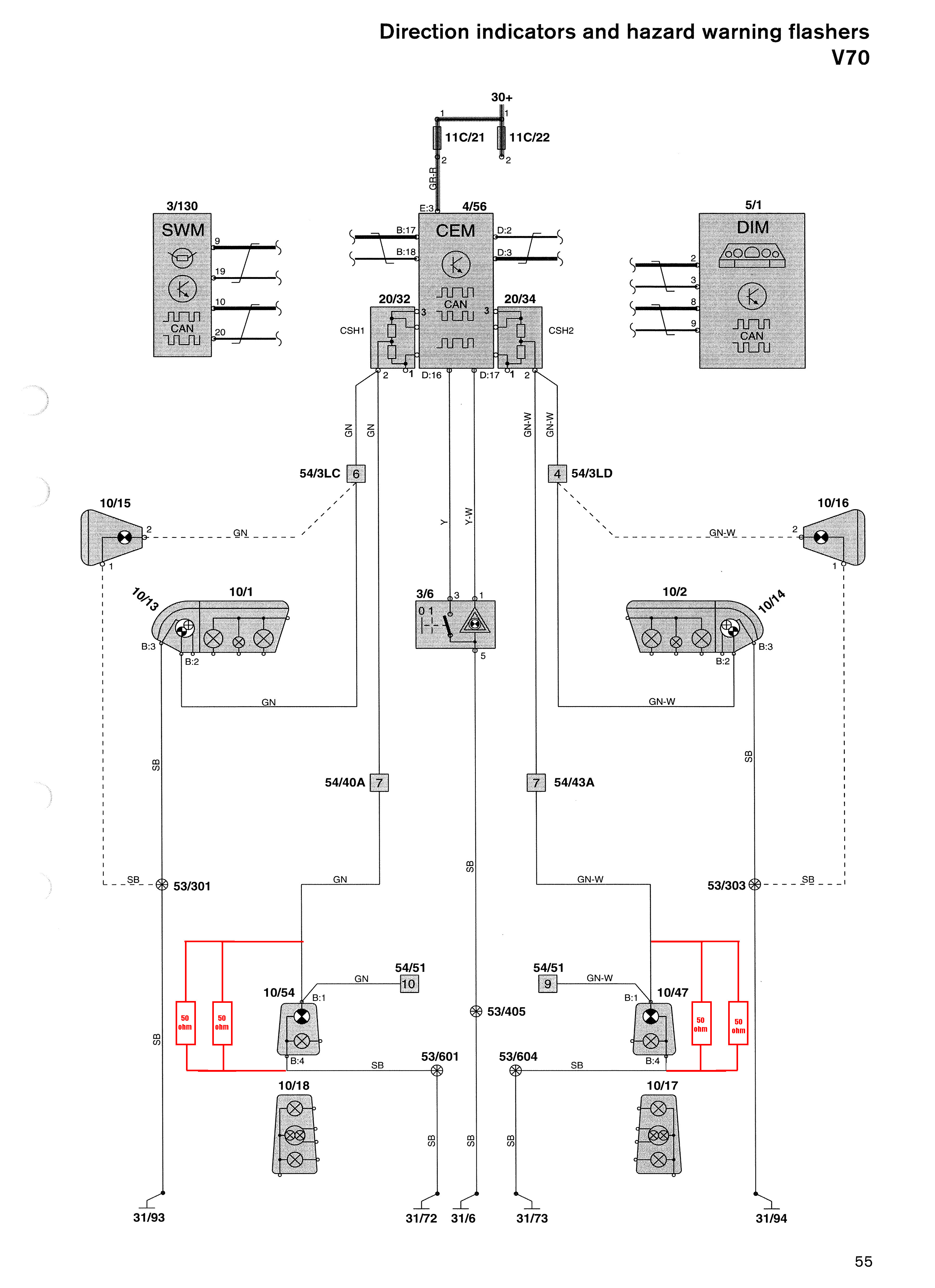

I did full LED conversion on my car.
I modified the shunts for brake lights and tail lights. I couldn't figure out a way to get the turn signals working by modifying the shunts so I had to use resistors. Resistors can be added anywhere in the circuit. You need 2 50 ohm resistors per side. I placed mine in the trunk cavity away from anything that could melt or catch on fire.
I highly suggest not using resistors for tail lights as they will get super hot.
Here is a video of my setup.
Here is a diagram showing how I wired my turn signal resistors.

Thanks, Moose. You've actually done exactly what I'd like to do with my '04, including the headlamp conversion - I love the projectors and need to try to source the lenses rather than using my fluted ones.
I did try your shunt method, but as I said above, when I drill through the shunt and break that arm completely, I get no current at all for some reason, I even tried a variety of resistors without luck. Did you completely sever that second arm of the shunt (drill through and cut it in half) or did you leave a bit of the original metal, thus introducing a small path for voltage? Maybe I have a bad shunt - I'll go back and try another.
In terms of the big resistors, how far up did you wire them in? Did you tie them directly to ground or use the small black wire that feeds each lamp? I guess I was hoping to have them much lower like you do, but want to avoid any long runs of wire to support them. Maybe I'll trace back the green and green/white wiring and bridge it lower.
W/r/t the actual wires, what threw me is that that green wire voltage varies when the directional is on and is stable when the brakes are on. So I was completely fooled by which wire was which.
Thanks again.
Thanks again.

I cut right through the shunt to sever the connection and then soldered a 10 ohm resistor in its place.
I actually replaced the wires that attached to the 50 ohm resistors with longer ones so I can hide them in the trunk. I attached to the black ground wires in the harness.
