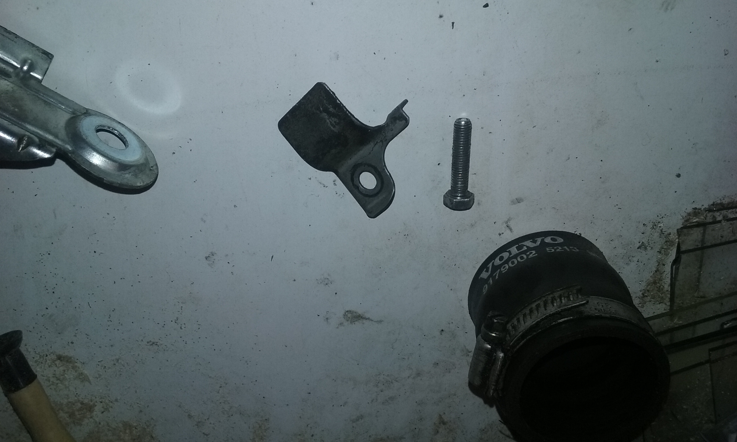

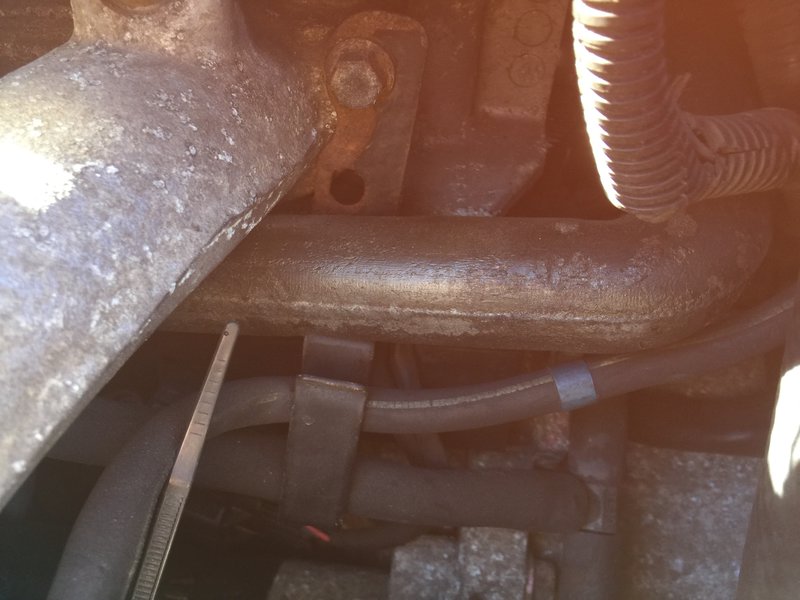

I think the intake manifold bolts are all the same. I think the upper rearmost one picks up a bracket for hoses too, I'll check in am. It's too dangerous to look right now, we have Canadian gangs down here looking for third seat parts marauding the ' hood
Upper rearmost (right side looking at engine, left side of car) mounts bracket per photo

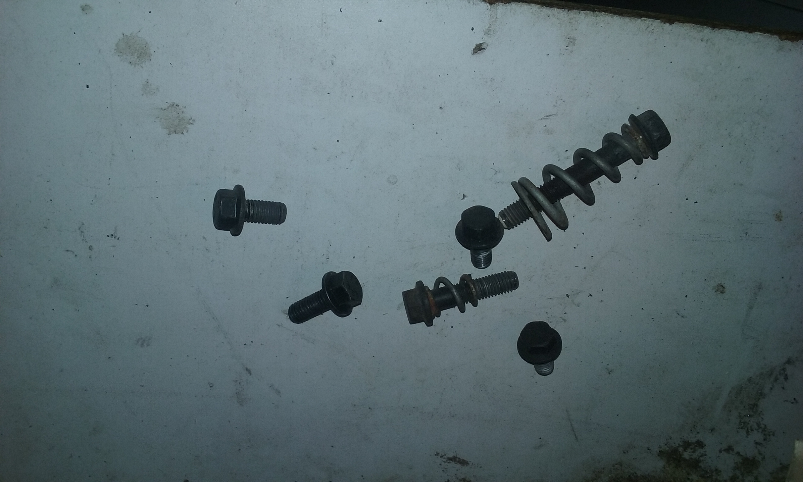

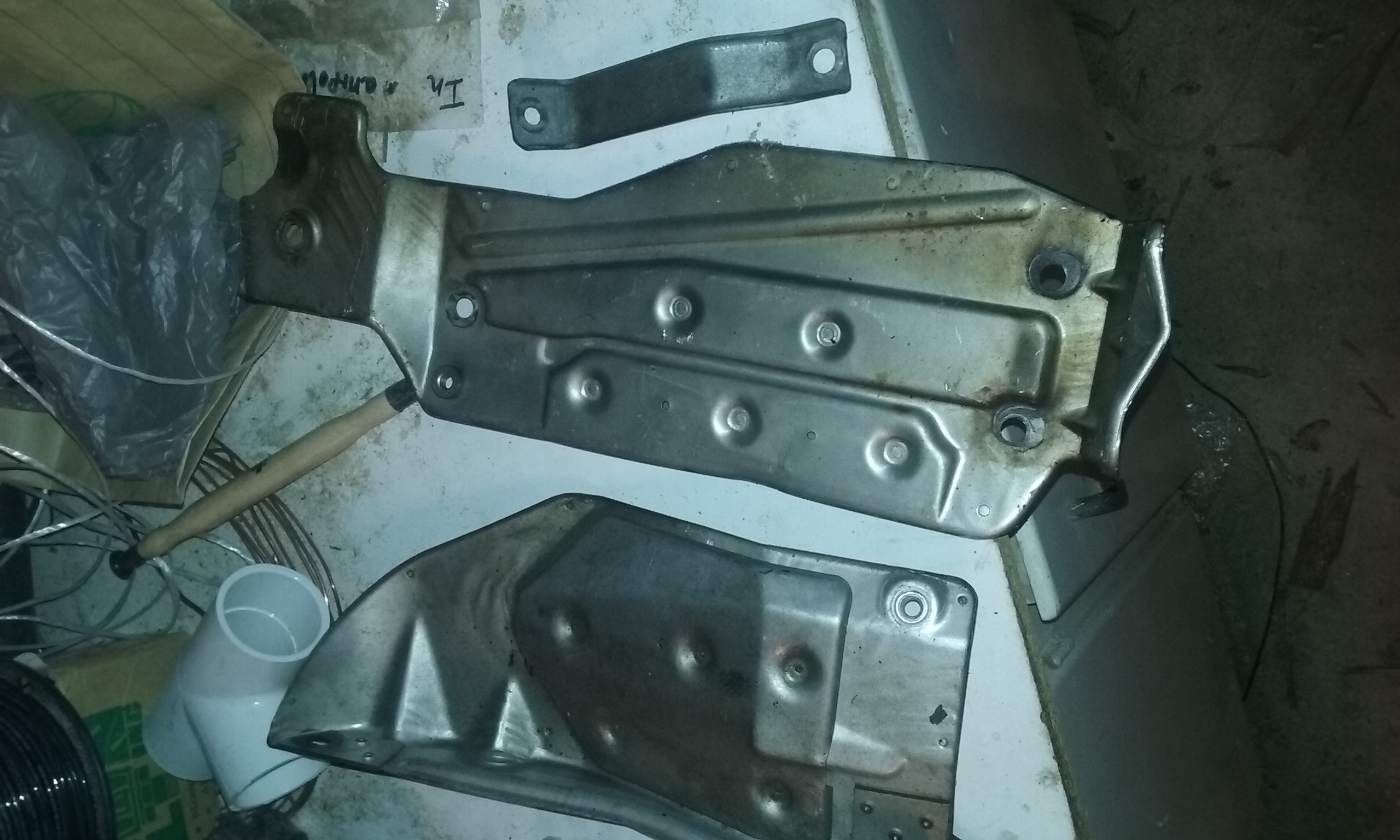

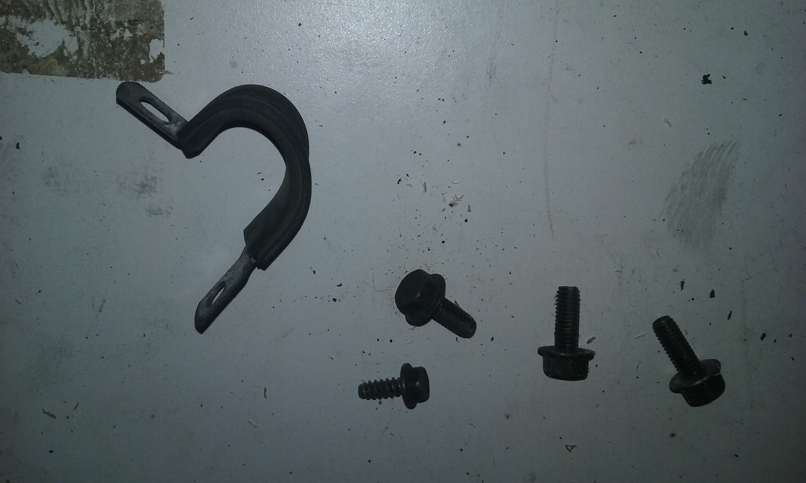

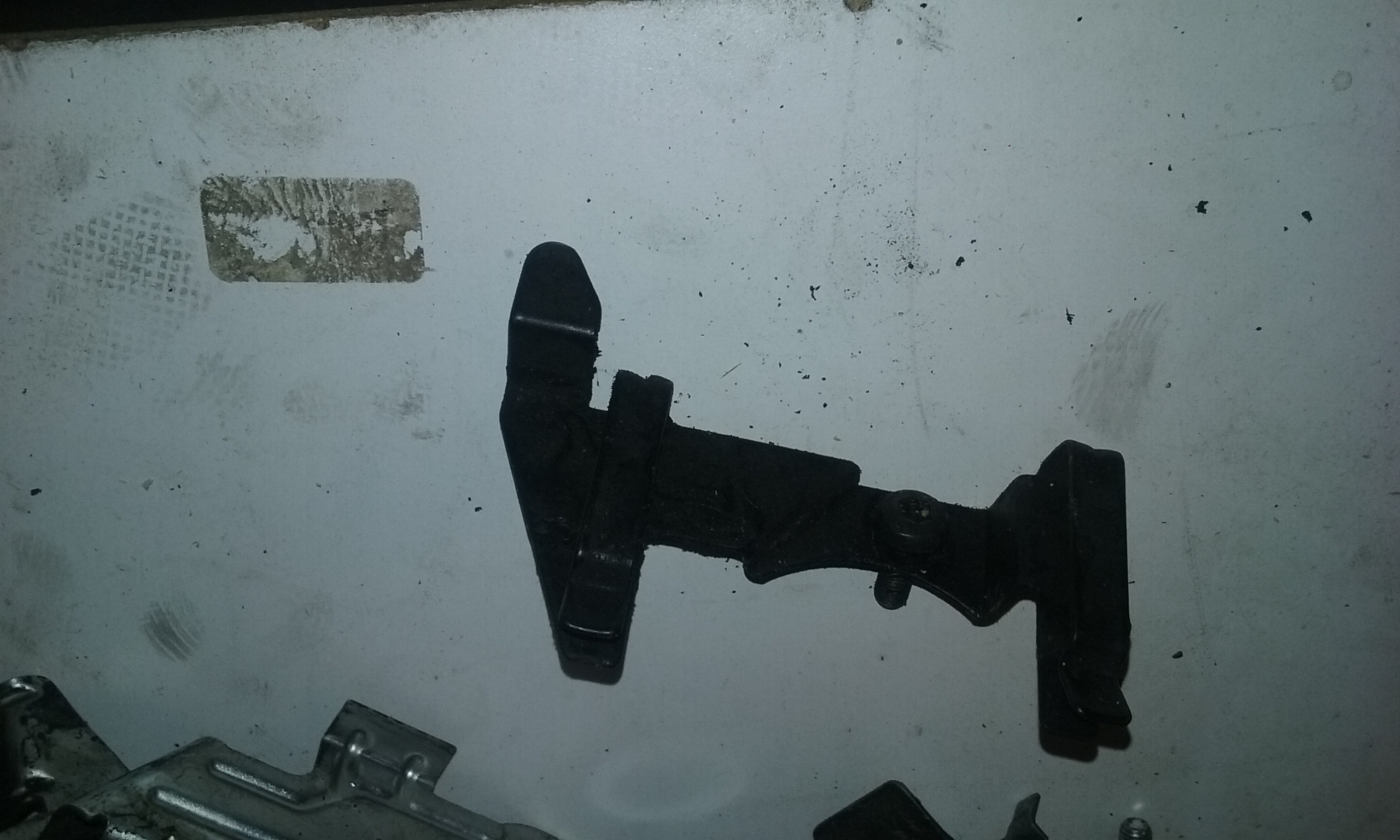

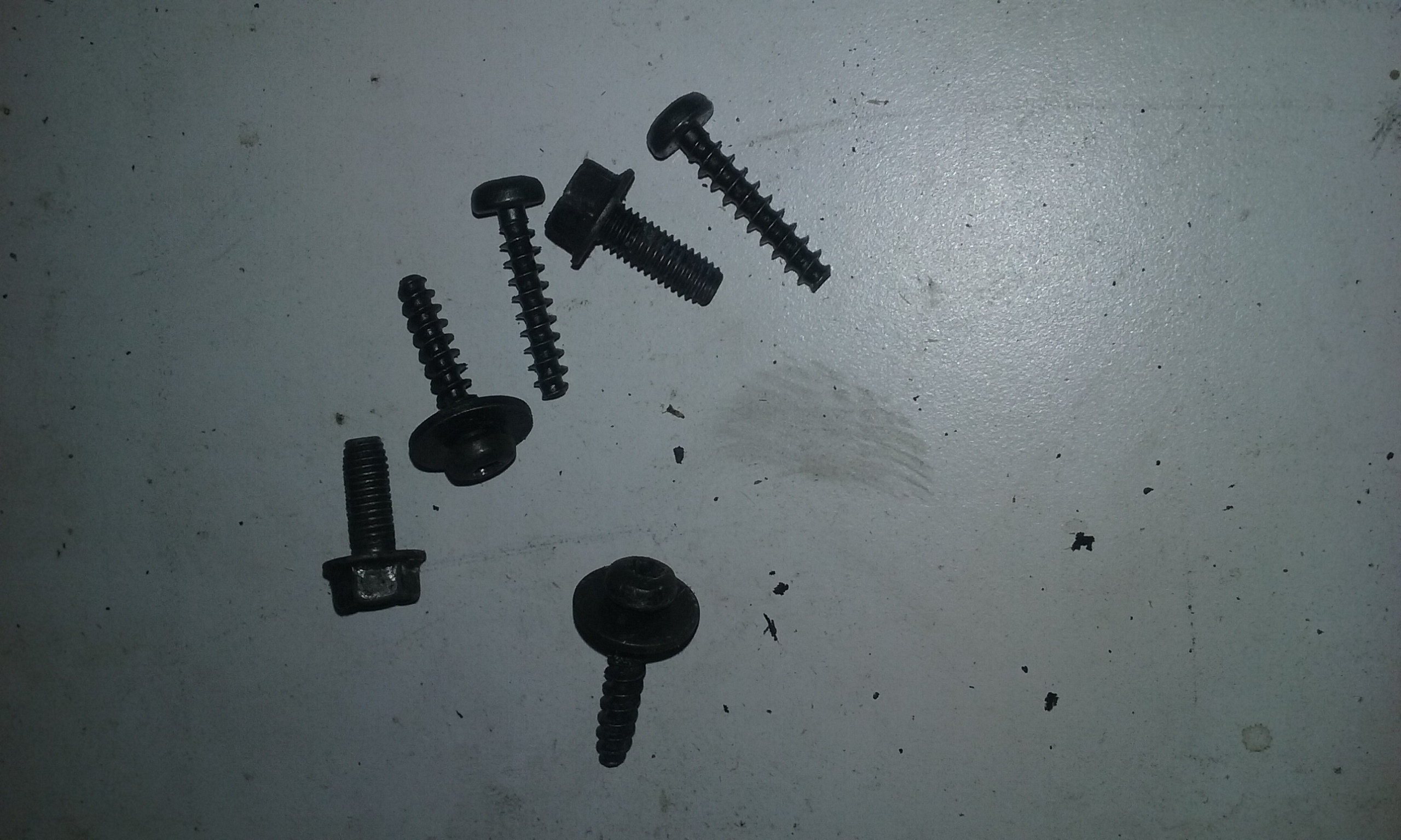

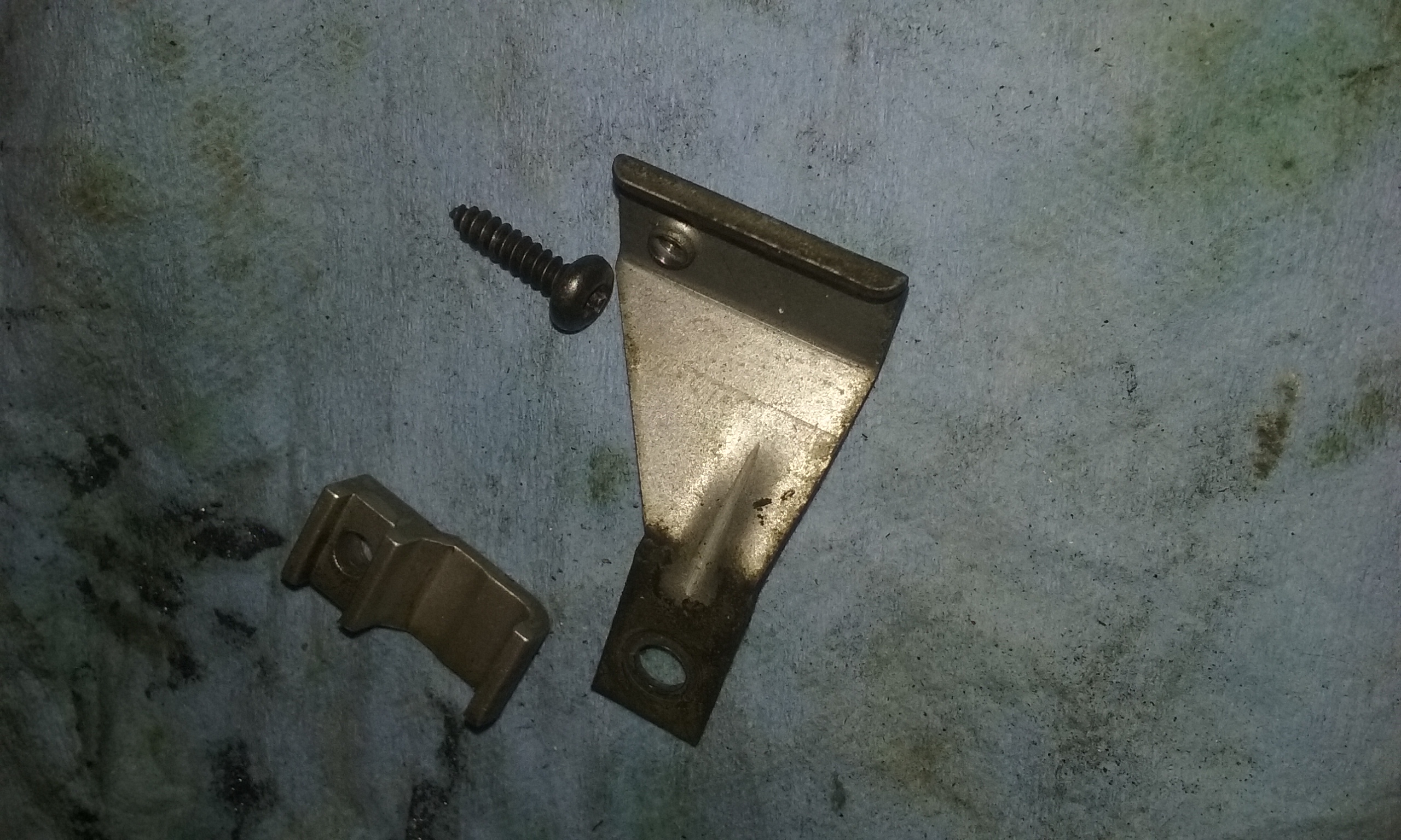

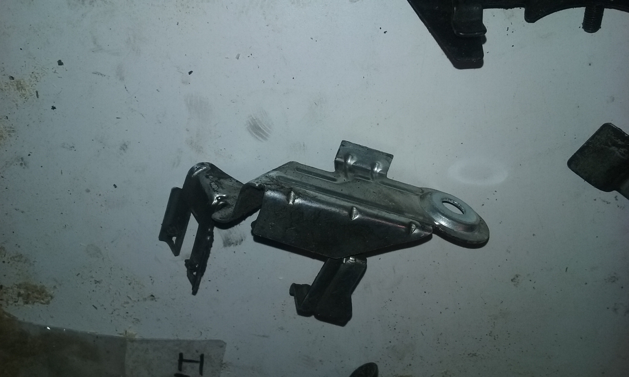

Back at it, so I started this project on the side a few months ago thinking I would have time to do it all at once and didn't label things as well as I would have if I realized how long I would take, some labels fell off of parts because I used scotch tape and it fell off. I bagged some components that seemed related in the same bags and the comments by a few pics are what I wrote on the bag. Here's the leftover parts, I included the heat shield because yes I know its a heat shield but no I dont remember how its configured. Also included is a pic of the leftovers from the head gasket kit, there's a pipe that goes in the back/exhaust side of the head and it has a oval gasket that I haven't got to yet but the other gaskets and seals I have no idea about, I figure the kit sells to other volvo models and they include stuff for all relevant models. There are some hoses as well but I think I can figure those out and if I cant I'll be back on here. Thanks!

The bolts with the springs on them go with the heat shield that goes on top of the turbo/exaust manifold.
