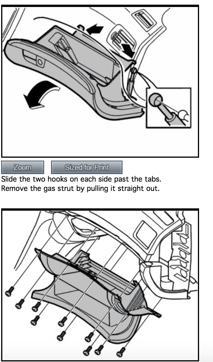

The glove box 'gas strut' just pops off the top end, its a ball and socket joint
You have to remove 10 screws to remove a P2 glove box - its easy to miss one or two.
