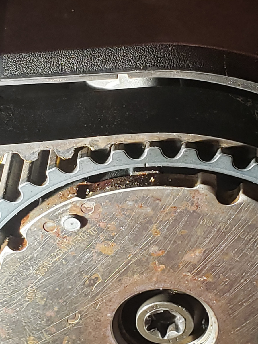

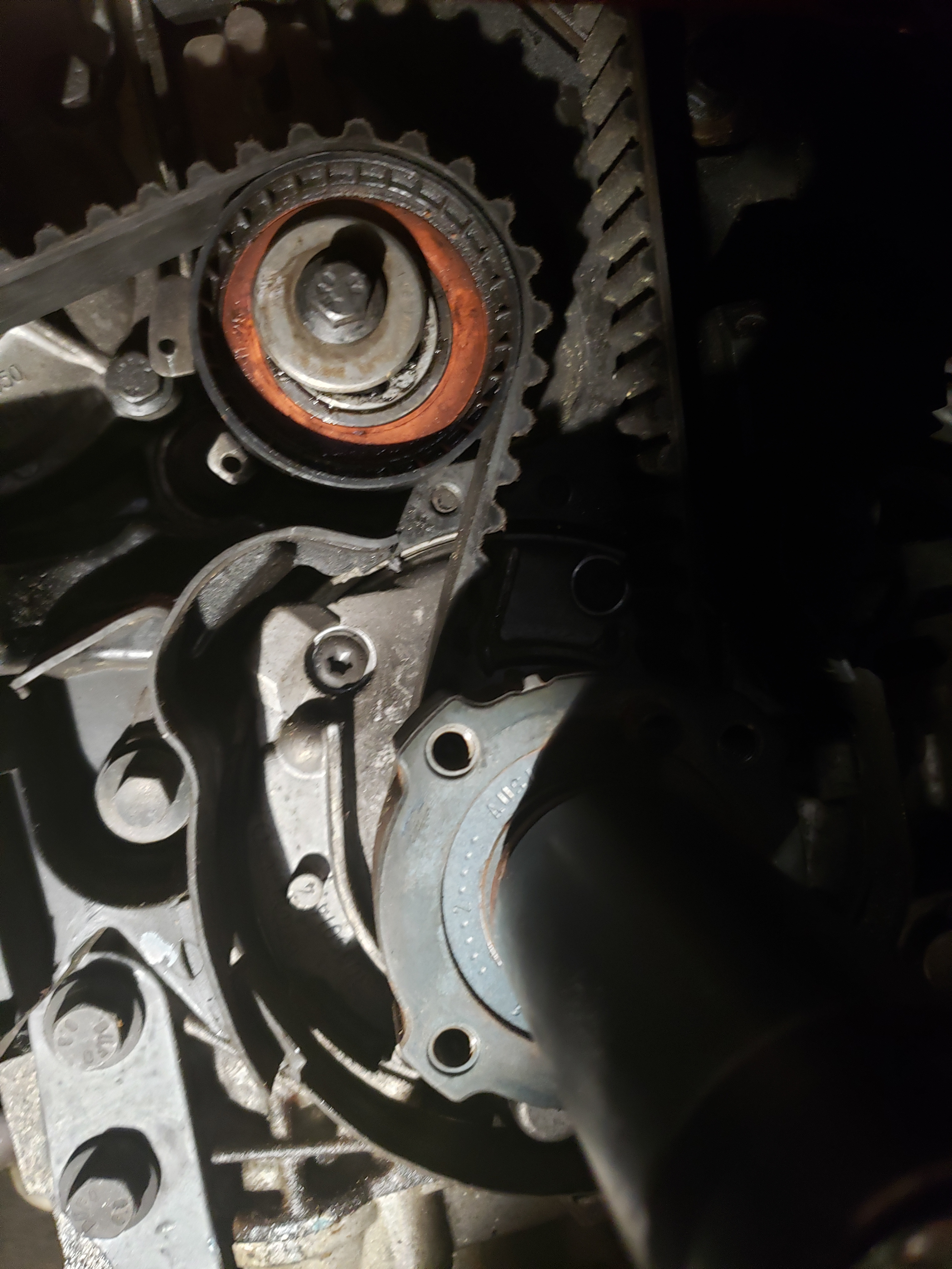

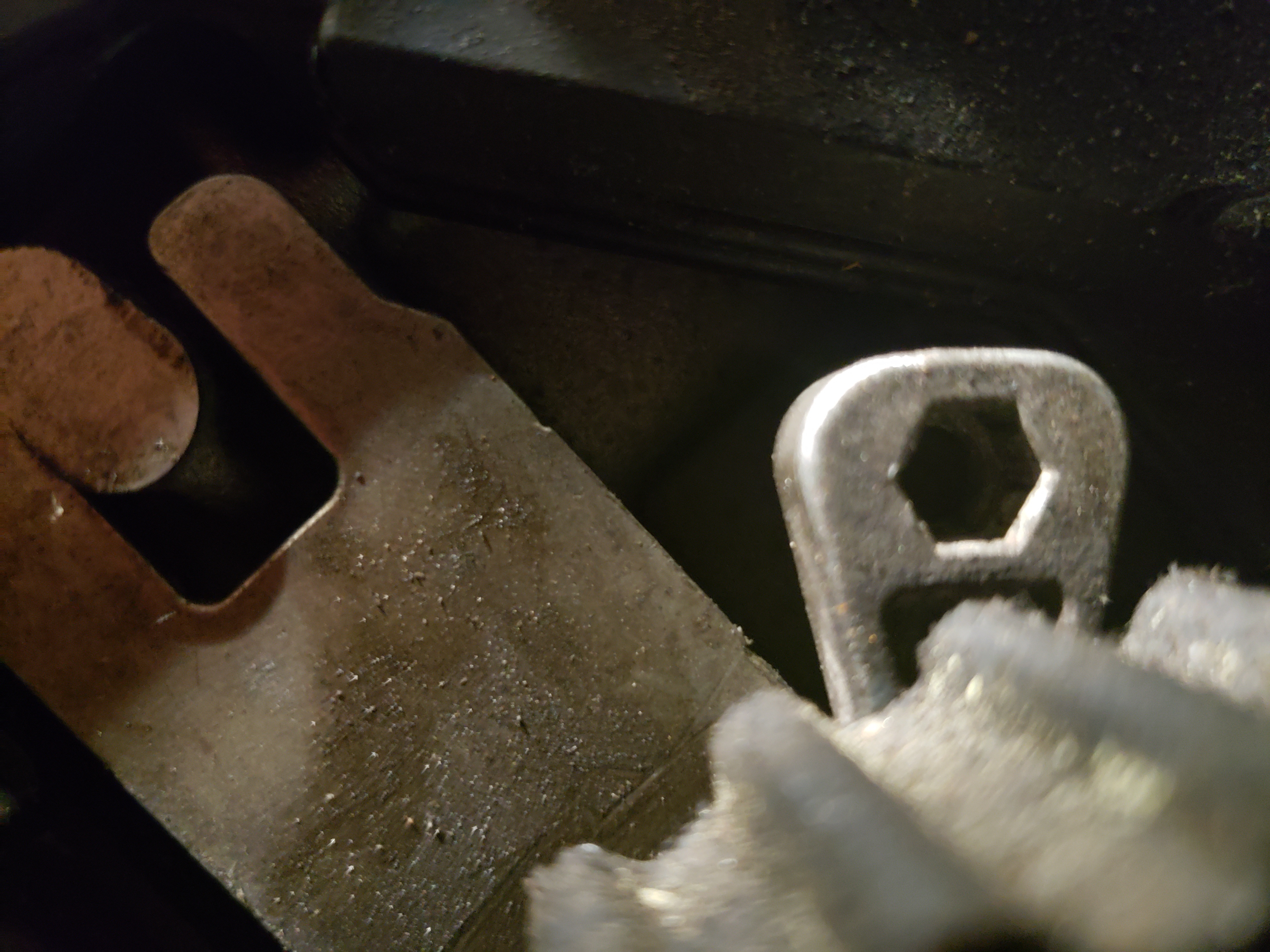

Some pictures of that automatic timing belt tensioner. 2.4i non turbo 2007. I just maybe have to center the fork for accuracy or something. Maybe i let go off the retaining pin too soon.

I went 3 full revs and intake cam is off by 1/2 a tooth. Hopefully that vvt sensor helps with the full sync. Otherwise i will have to loosen up the cam gear and move it a hair counter clockwise.
The marks are slightly off compared to the exhaust marks which are perfect.
