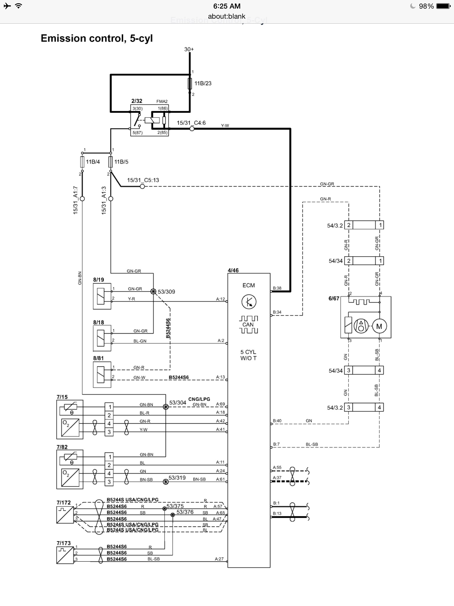

I have 2005 info for my NA and will post what I have. Do you know where this is located?
- Posts: 36145
Ah, unfortunately there is a big change from 2004 to 2005
The LDP oils above the tank, accessible after removing the charcoal canister
On 2005s, the ECU grounds it to run. You can test it for 12 V supply of course, pin 4 on the pump connector
On 2004 cars, the pump is run by grounding at the ECU, but the heater circuit is run by the CEM.

Thanks for the Pic. Now I just need the vent/vacuum diagram to figure it out.
