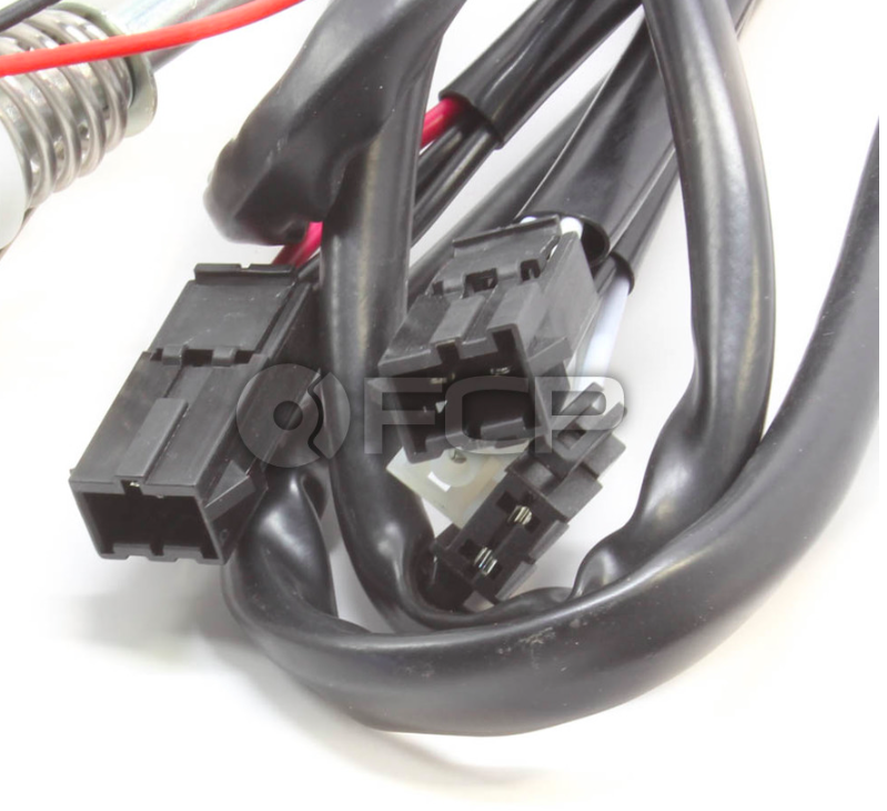

I got sick of the issue, so I ordered a new sending unit from FCP Euro (Pro Parts 9470674). But...The unit has an extra ground plug.
The is no receptacle for the white socket (kind of hard to see) on my V70. Everything else is identical, except for that. The wire is an auxiliary ground, it goes back from the fuel pump ground terminal. I figured it would be fine to just cap it, since everything is grounded already. But...Fuel pump is INSANELY loud, but goes down to a normal volume when I'm accelerating. It's really annoying, and I'm thinking perhaps it is spinning too fast at idle, perhaps because of this extra ground?
What do you think I should do? Ground the extra plug to the body? Leave it capped and hope the pump isn't overworking?
Buying an OEM fuel sending unit (~$450) is just not in the cards for me.
The fuel pump is always working at its max, the fuel regulator returns the un-use fuel back to the fuel tank. Some fuel pump is loud, some is quiet.

Hey all, thanks for the input. I drove my car around for a bit longer, to see if maybe it needed to "break in" or "warm up", noise never got better. And...Car developed a fuel-line leak on the driver's side, which has never been present before use of this pump. I think the pump was way higher flow/pressure than OEM spec.
I pulled the new sending unit, put my old aftermarket pump back in (which has been working GREAT for 6months), and put it all back together. Now I have to chase down a new fuel leak though...
FYI, DO NOT BUY THIS: https://www.fcpeuro.com/products/volvo- ... -9470674-1
Horrible quality, wrong pump, plastic connectors broke when plugging in.
