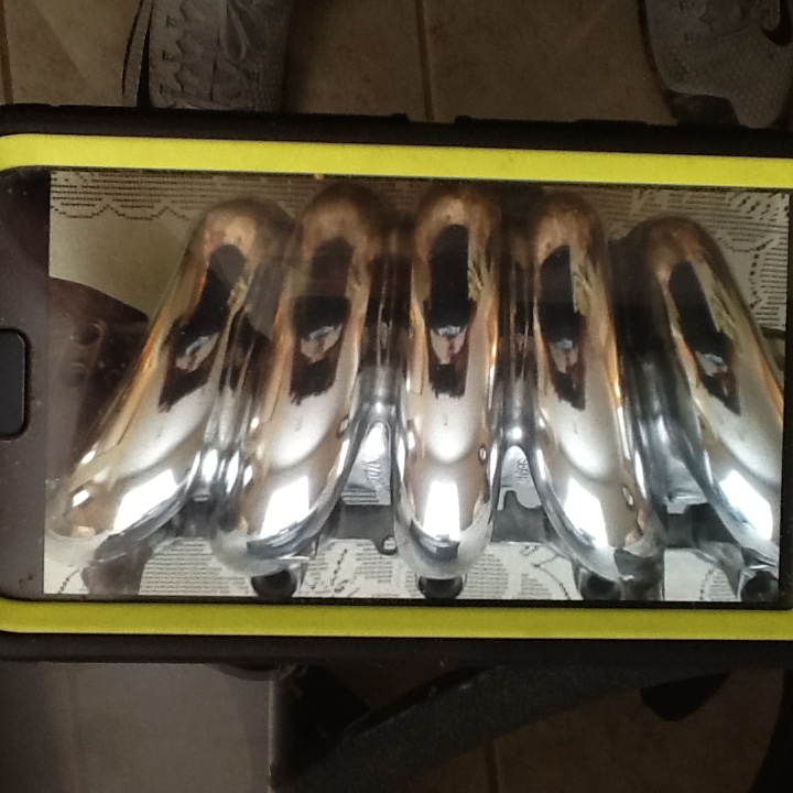

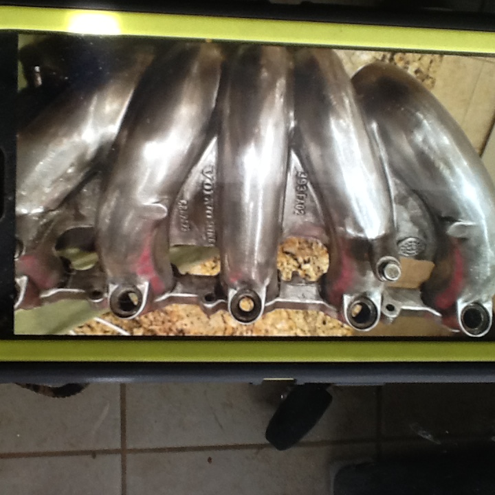

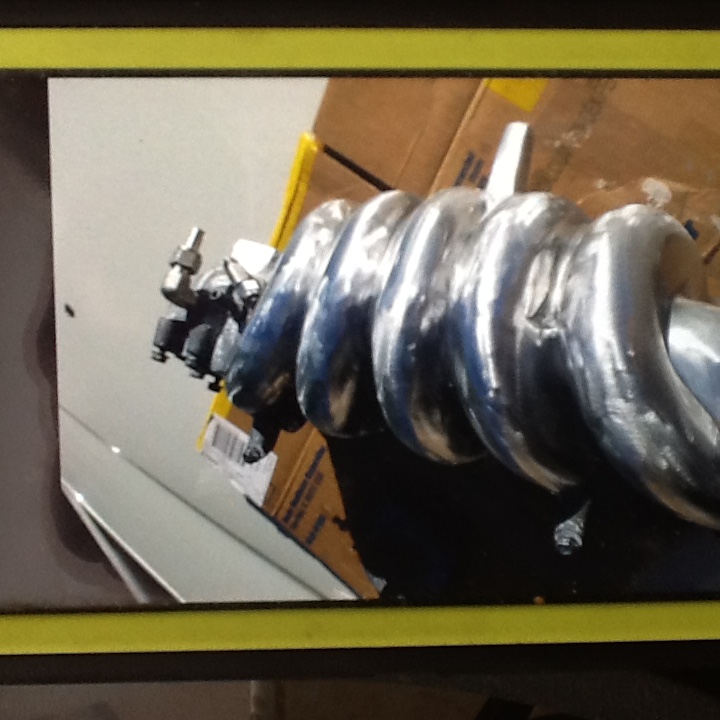

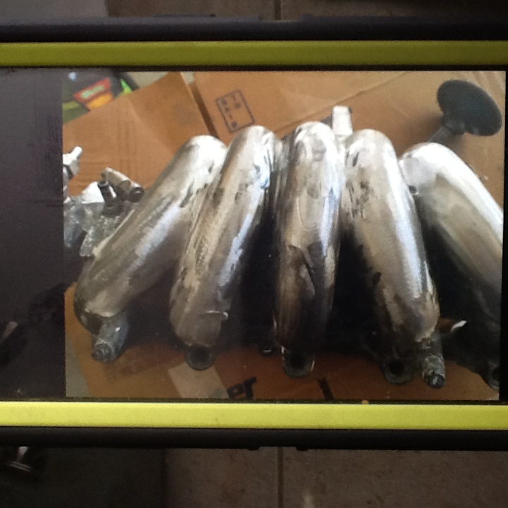

Okay, so being new to the site/forum etc. I thought I would show you guys what I've been working on in my spare time. The rough one is obviously what I started with, and the one you can see my reflection in is the finished product. All casting marks/lines were removed, as well as all radiuses smoothed.

Wow...
- Posts: 36142
Buried in the cryptic terms and conditions of MVS is an an agreement to provide free services for the first 100 posts
Beautiful work...welcome aboard!!
- Posts: 14800
- Joined: 14 Sep 2002, 11:03
- Has thanked: 2856 times
- Been thanked: 1332 times
Gorgeous!
- Posts: 6357
- Joined: 30 Dec 2014, 10:45
- Has thanked: 316 times
- Been thanked: 531 times
Wow, that looks awesome! Very nice job!

The process I used was starting with a pneumatic angle die grinder, remove rough casting with 80 grit discs...then to 120 grit. From there its all hand sanding starting with 220 working all the way up to like 400...then polishing compound on a angle and straight die grinder...
