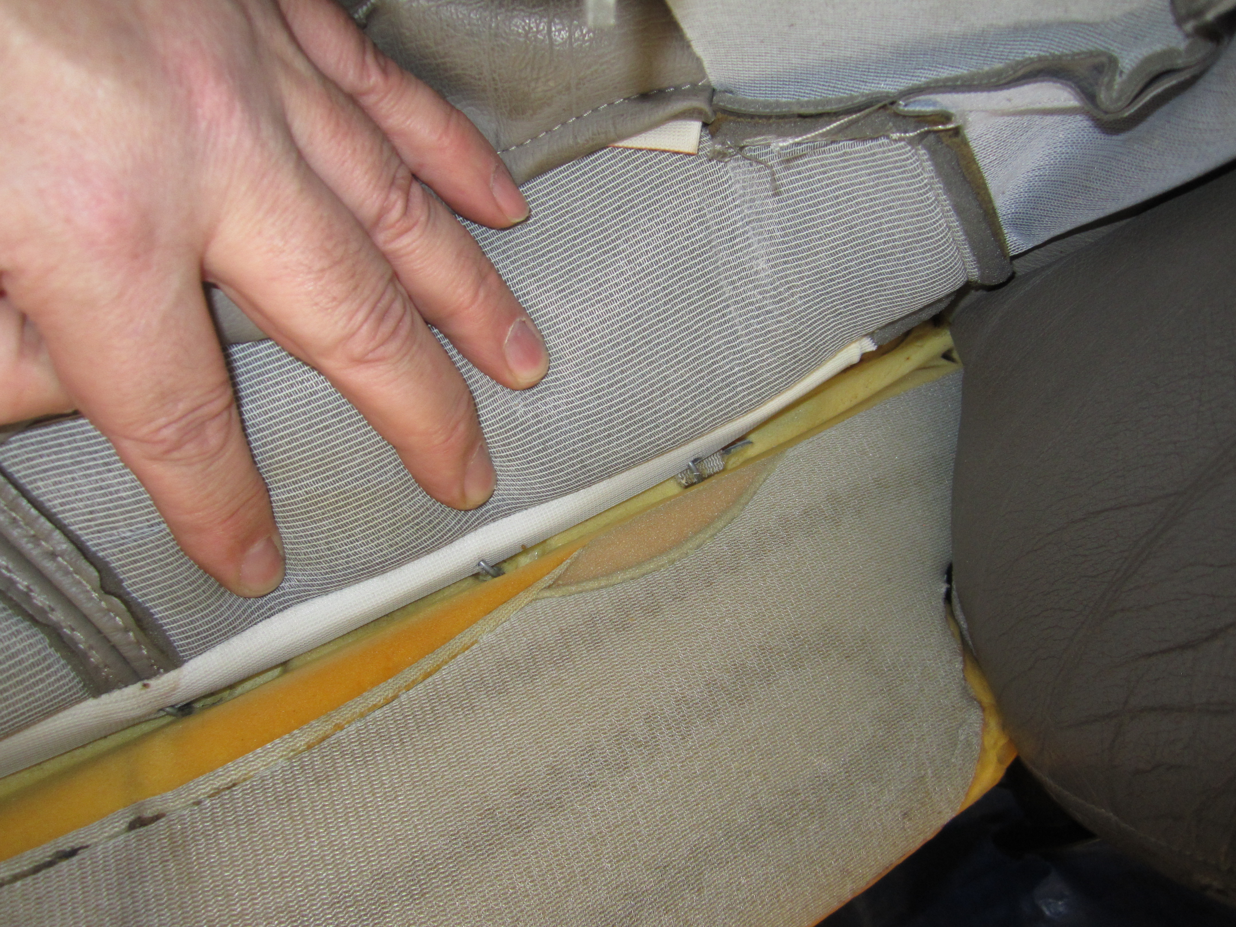

I have watched Robert's video on the subject, but I have hog rings and pliers so going the old school route. I have one question though. There are 2 wires that run across the seat that run between the front to back wires. I took photos when dis-assembling, but can't figure out if the ends of the cross wires which have a hoop in them are to be hog ringed to the front to back wires. I'm almost certain they are not and Robert's video is not clear on it. I would think if the hoops were tied to the front to back wires they may pull the wires out when the seat is sat on.
In my defence, I could not see where the rings were fitted in this area as they were tight down and only cutting the old rings revealed the end hoops but by then it was impossible to say where they were and if they had hog rings in.
The picture above shows the hog rings in place for the front to back wires, but I just can't tell if there was a ring through the cross wires where the seam is to the left of the picture.
HELP!

Scott, what is the year of your car? There were a lot of variance in the P80 chassis related to seats. 93-97 is one (850's), 98 is its own thing and then 99-2000 is another due to airbag changes.
I did this job on my 98 drivers seat last summer. I think the side to side wires are not connected to the front to backs, but don't the side to sides have loops at both ends? I looked back through my photos and I can't zoom in enough to see. The primary function of the side to side wires is to anchor the middle of the seat to the cover while the front to back prevents it from shifting. The hog rings around the perimeter on the bottom are really what hold the cover in place on the seat frame.

Thanks for replying guys.
Seat is back in the car with repaired cover in place. I went the route that if the cross wires were hog-ringed to the front to backs, there was a danger they could pull the front to back wires out when my big ass sits on the seat. Now feels a whole lot better than when the car was bought. Seat stitching was re-done and had to replace the seat foam from a spare seat as it was split front to back and the wires were pulled out for the hog-rings.
Car is a 2000 V70 base. Differences as listed by Sonic Adventure, but the differences are not too huge to prevent some cross swapping of parts from the 98 spare seat to the 2000.
Seat base foam can be swapped only difference is the 98 used 5 tensioning springs at the rear of the seat base foam and the 2000 had only 4. Oh, and the seat heater connector under the front of the seat on the 98 includes 2 pins for the seatbelt warning light. The 2000 has a separate wire. The 2 connector pins can be carefully popped out of the connector on the 98 and then transferred to the 2000, or added to a 99-00 connector if used on an earlier seat
Seat heater unit is the same and connects the same way under the seats.

Basic tenet... If the "stay"(the wire) sits in a groove in the foam, such as to hold a cross seam and the cover tucks down into the groove, then hog ring it down, that will hold the cover in place and keep it from shifting or bunching.
