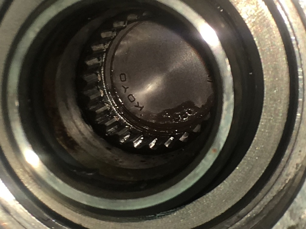

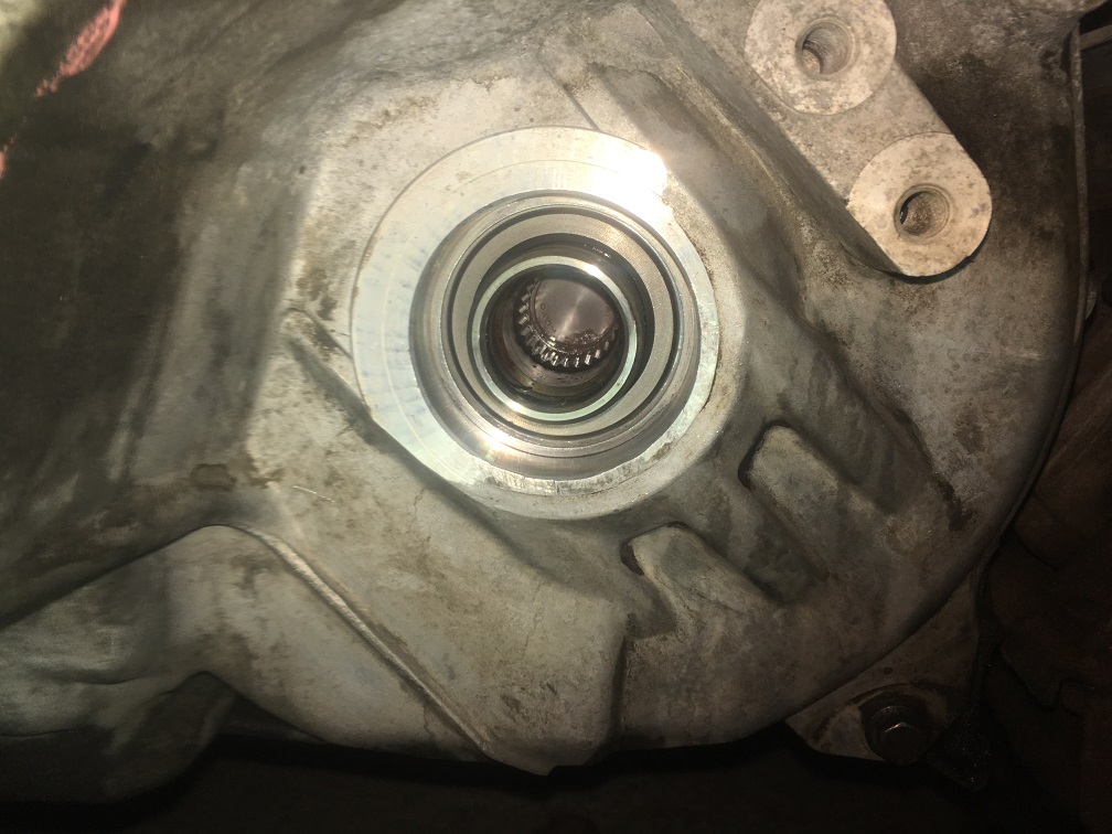

I figured it out. Thanks for the feedback and advice. Yeah, the old axle shaft and the new one are the same diameter. However, in my inexperience, I was looking for a seal around the axle and now I realize that the seal actually goes around the moving sleeve that the axle goes into. What I thought was part of the seal was actually the metal sleeve that the seal was around.
So I am alright with that seal, but now I notice a damaged O ring on the inside of the sleeve. See the 1st pic closeup. It looks removable, but now I have to find it somewhere. Probably with the dealer again, because they are close by. However, it might be a common O ring. I will check with your suggested supplier for a size. Thanks.

I called the dealer for the o-ring and they gave me the part number #8632036. $6, and they have to order it. In next Tuesday. I went for it. I couldn't find it at RMEuropean.com, but another O-ring they had listed was about the same price and the shipping was $8, so the dealer is best here.
