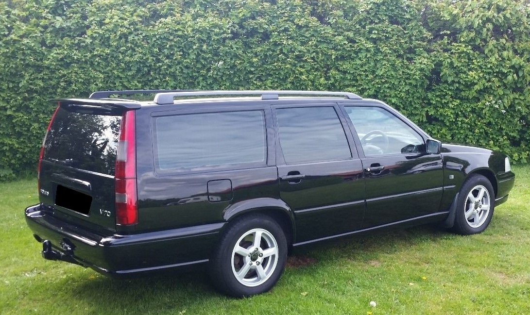

Want it to sit like a V70R or an 850R - 30mm? Pic below...
Don't want the ride to be too hard though - any recommendations on kits?

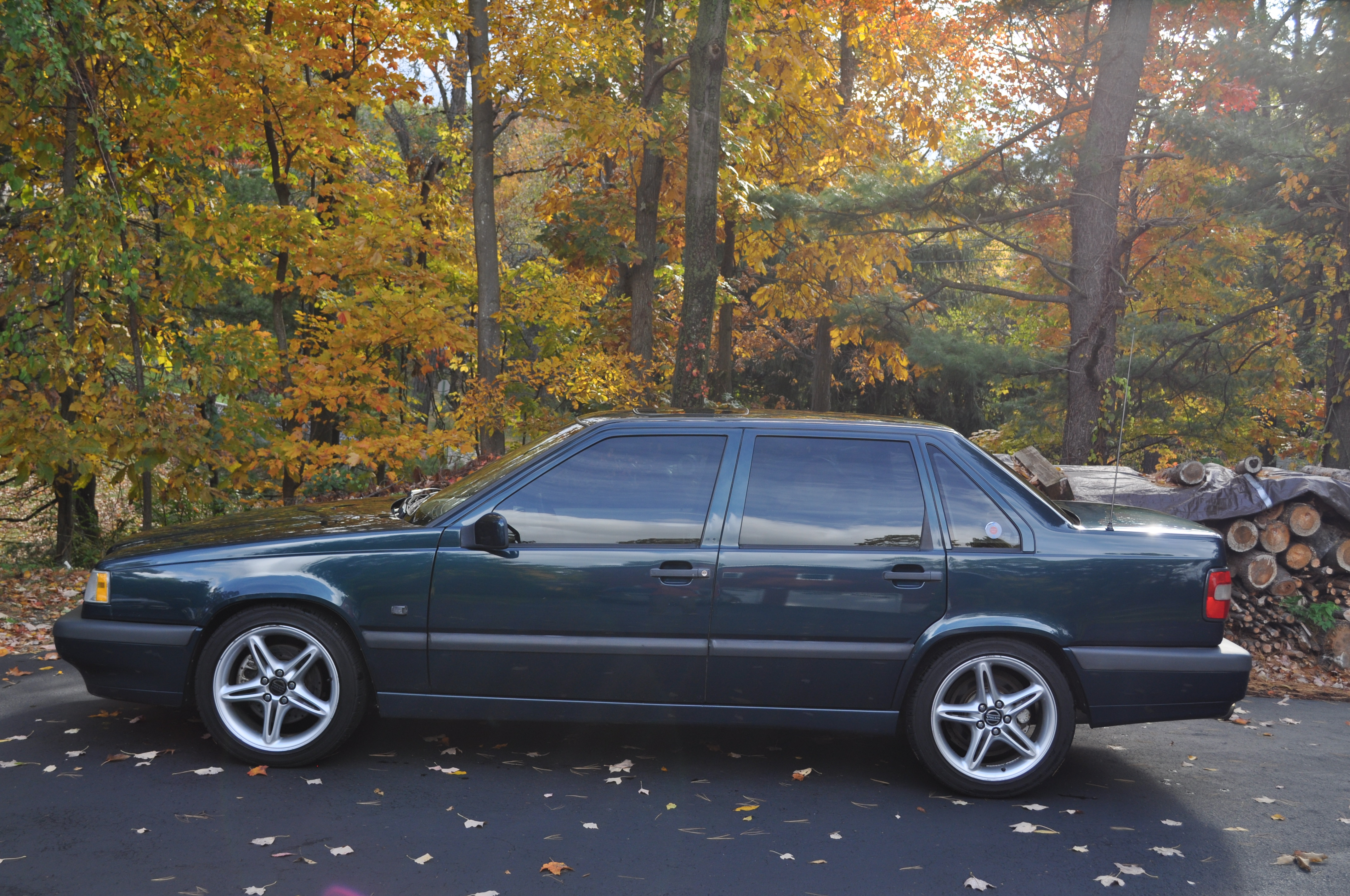

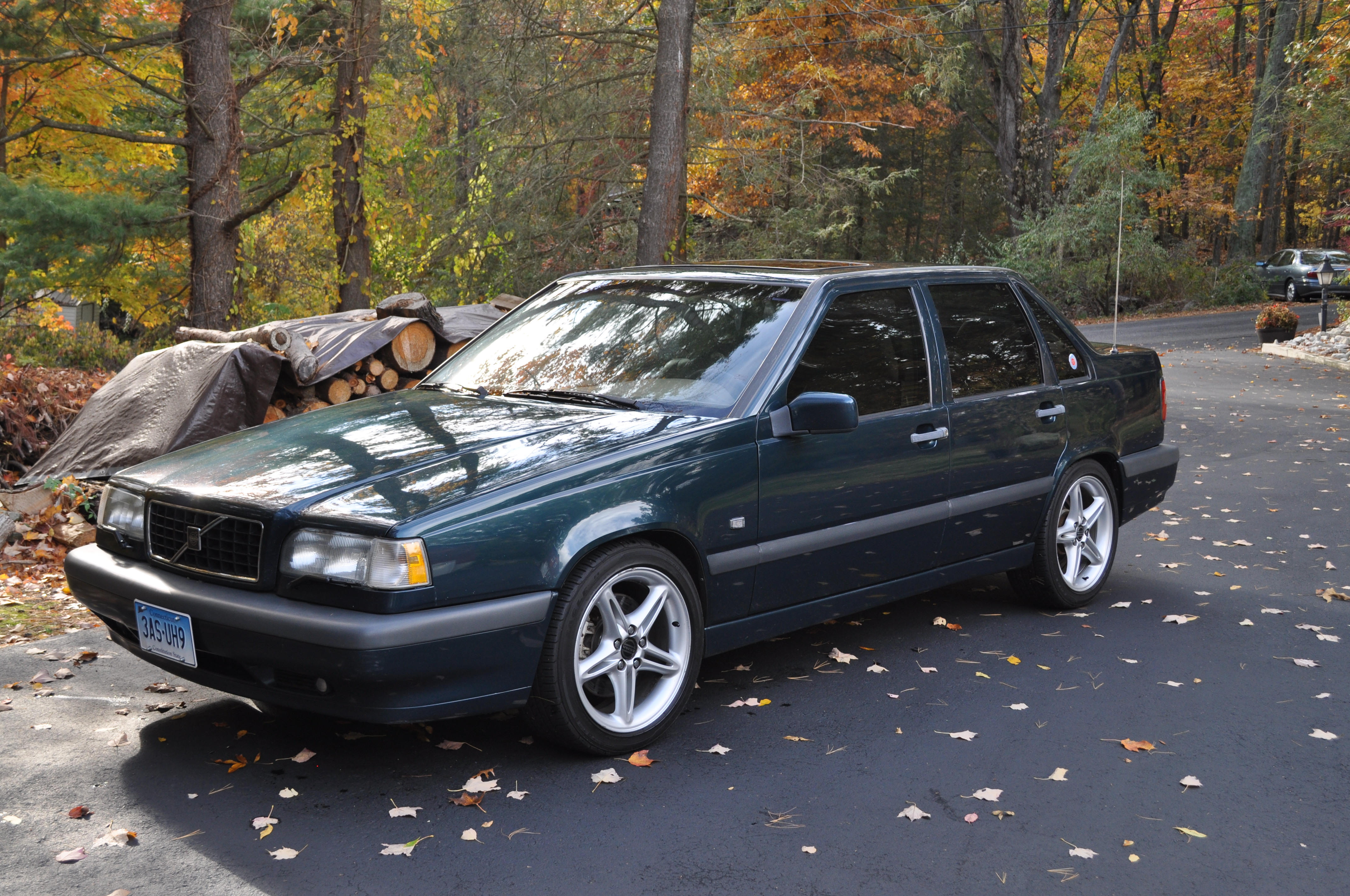

My old 850 was lowered with H&R springs (popular kit here) and had Canistos with 225/45/17 tires on it installed. It was way to harsh for me.

This is what the combo looks like:

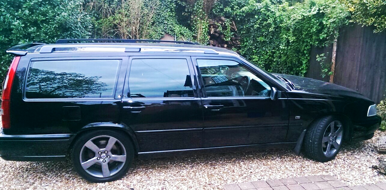

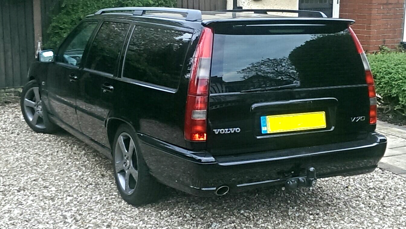

So - Result, I actually got hold of a set of much more modern wheels from a V50 - Cratus R Design and much later.
They needed a little light grinding to clear the hubs but I think look pretty cool - I lowered it too with R Type suspension...

How did you put v50 wheels?
They have different(WRONG) offset ET 52.5 and center bore of 63.4.
850,s,v,c,xc70 have offset ET 43!...but everything between 35-49 is acceptable.Also...center bore is 65.1.

Very pretty! I put this photo on the MVS Facebook Page. If you're not down with that, let me know and I'll remove it.bluebossa wrote: 06 Jun 2017, 13:20 So - Result, I actually got hold of a set of much more modern wheels from a V50 - Cratus R Design and much later.

Looks like you have slightly decreased the track width of the car with those wheels. Any decrease gives twitchier handling at speed unless you use spacers. Careful with that.
Also you mentioned you grinded the centre hole to clear the hubs. Without accurate machining you may have vibration issues at high speed due to in accurate centring of the wheel.
However they do look great.
