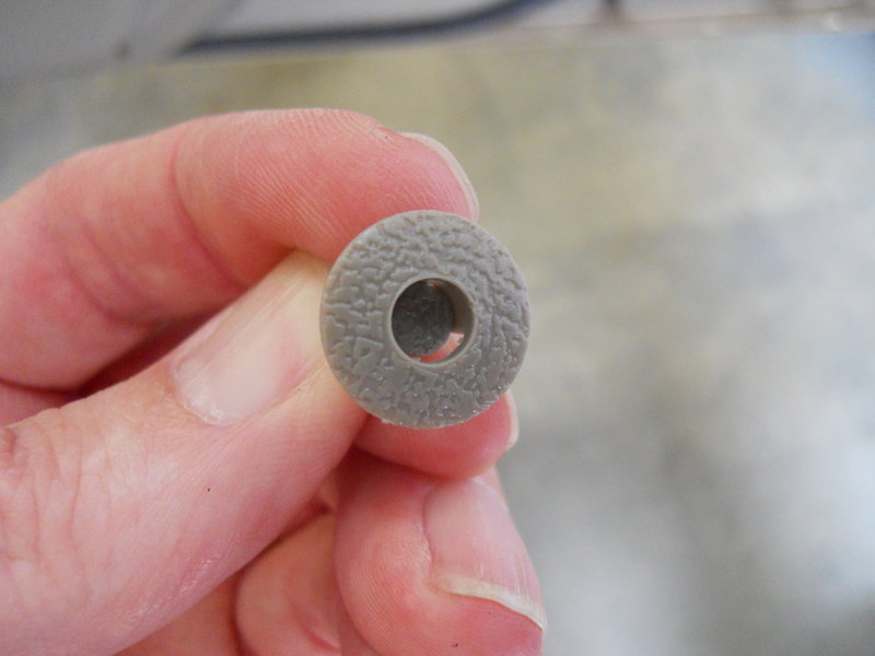

First take the door panel off. Very good video from someone on YouTube, but here are the basics. The door has a bunch of these plastic pop rivet things. Just use a T25 to push in the center about as far as the photo shows, it will pop in, then you can pull the rivet out.

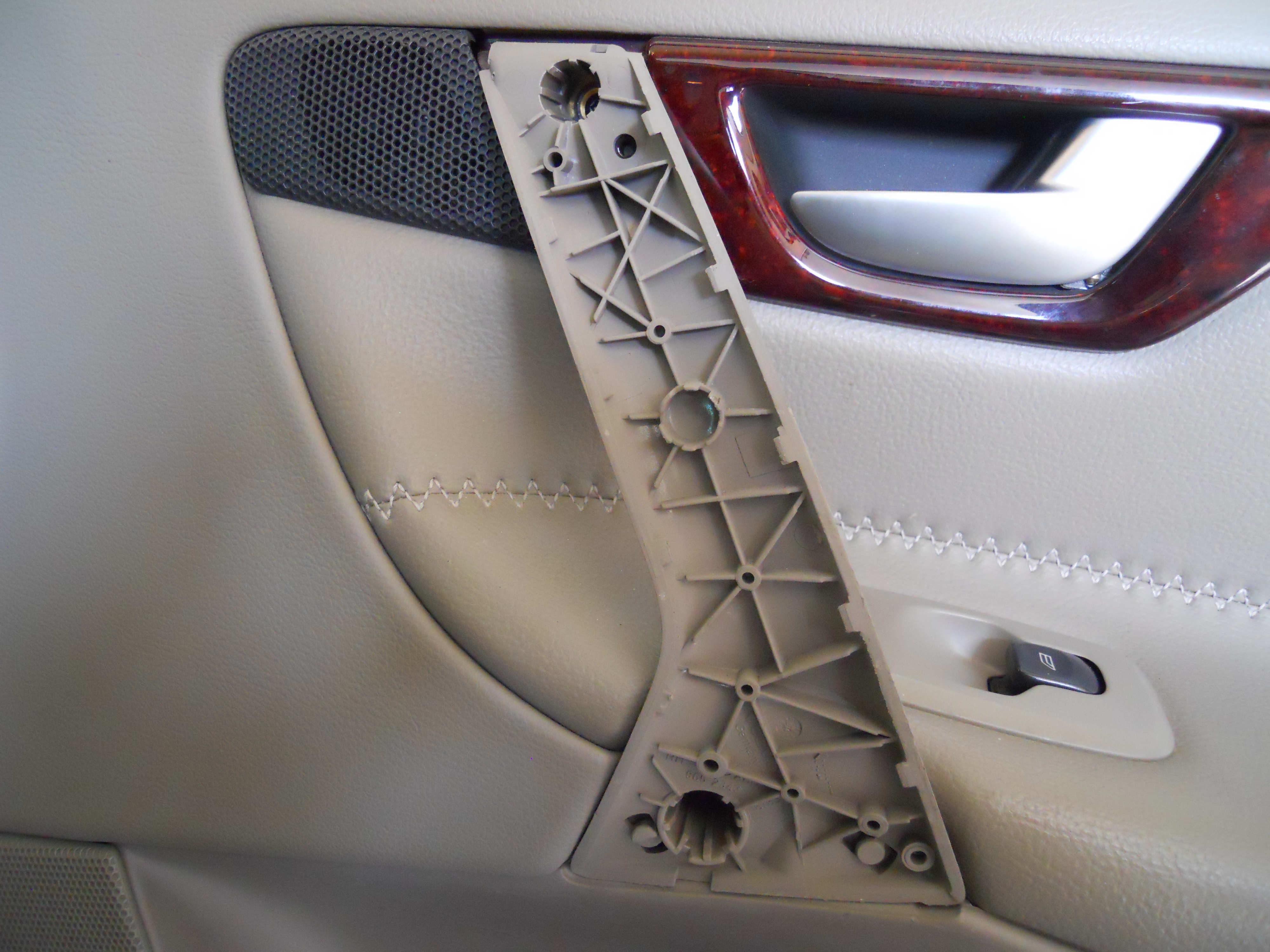

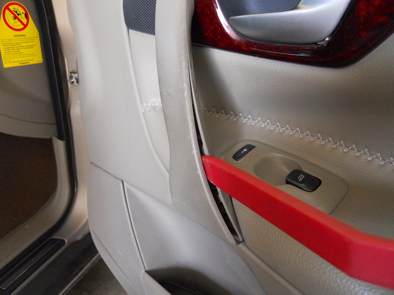

You also have to remove the plastic trim triangle at the upper corner of the door. Pry it out, and buy glue, because you will break some, if not all, of the ball ended stalks which plug into the female door bits.
Now you can pull the door panel up, and disconnect the electrical plugs. Each one has a bit different push detent, but you can see them. You also have to disconnect the interior door opening handle cable. Just pivot the connection away from the door panel and it will pop loose. Now you see this:

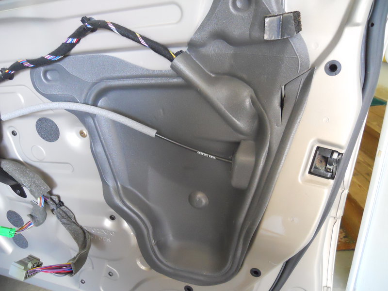

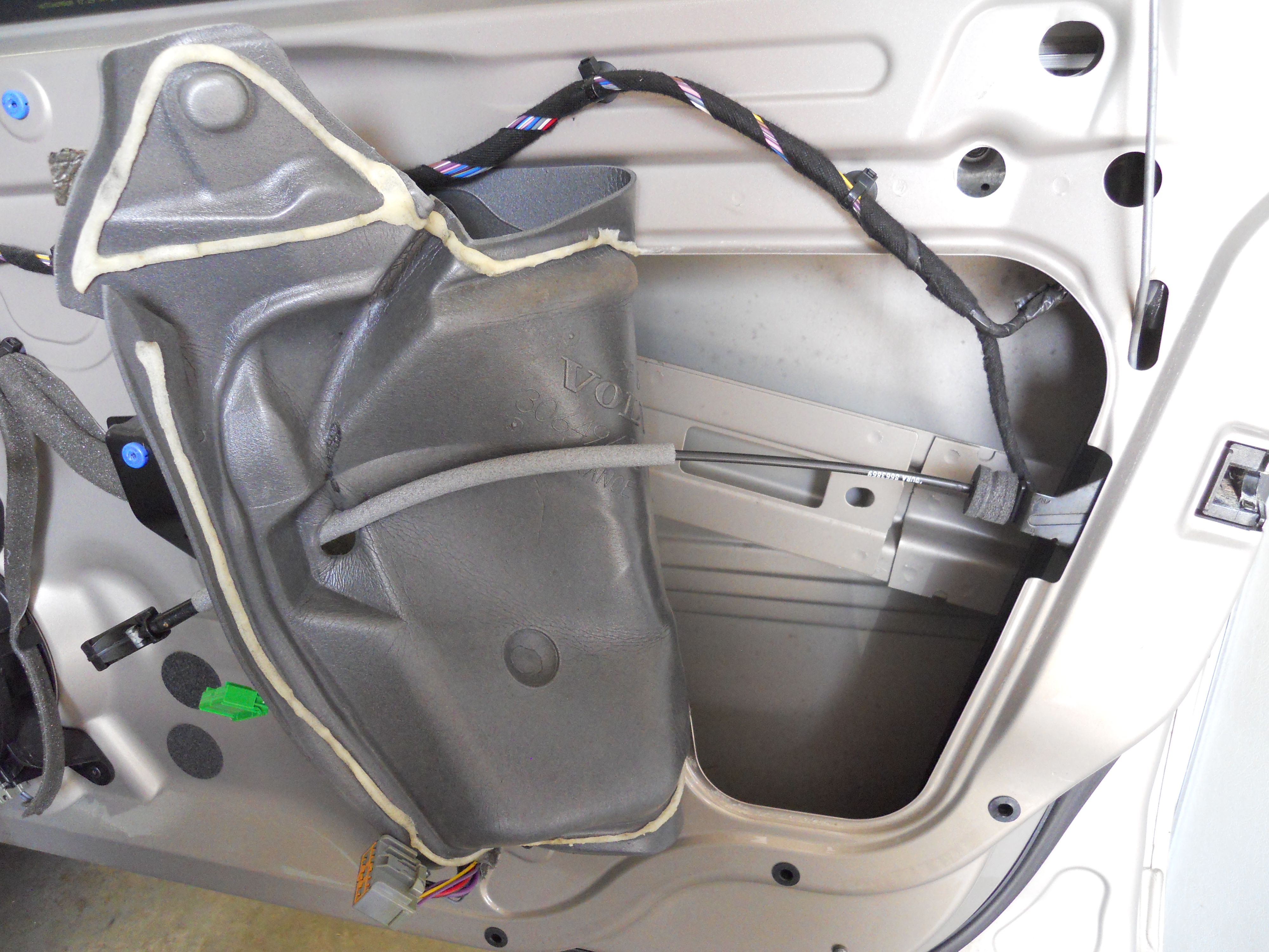

OK in that photo above you see that the lock plunger rod is behind the gray foam cover, it actually rides in front (outside) the foam cover and over that foam guide block with the dent in it. Now carefully peel back the foam cover, taking care not to tear it. That yellow adhesive is more or less reusable. Now you are going to really need a headlamp and good lighting to see into the door. PITA factor increasing.

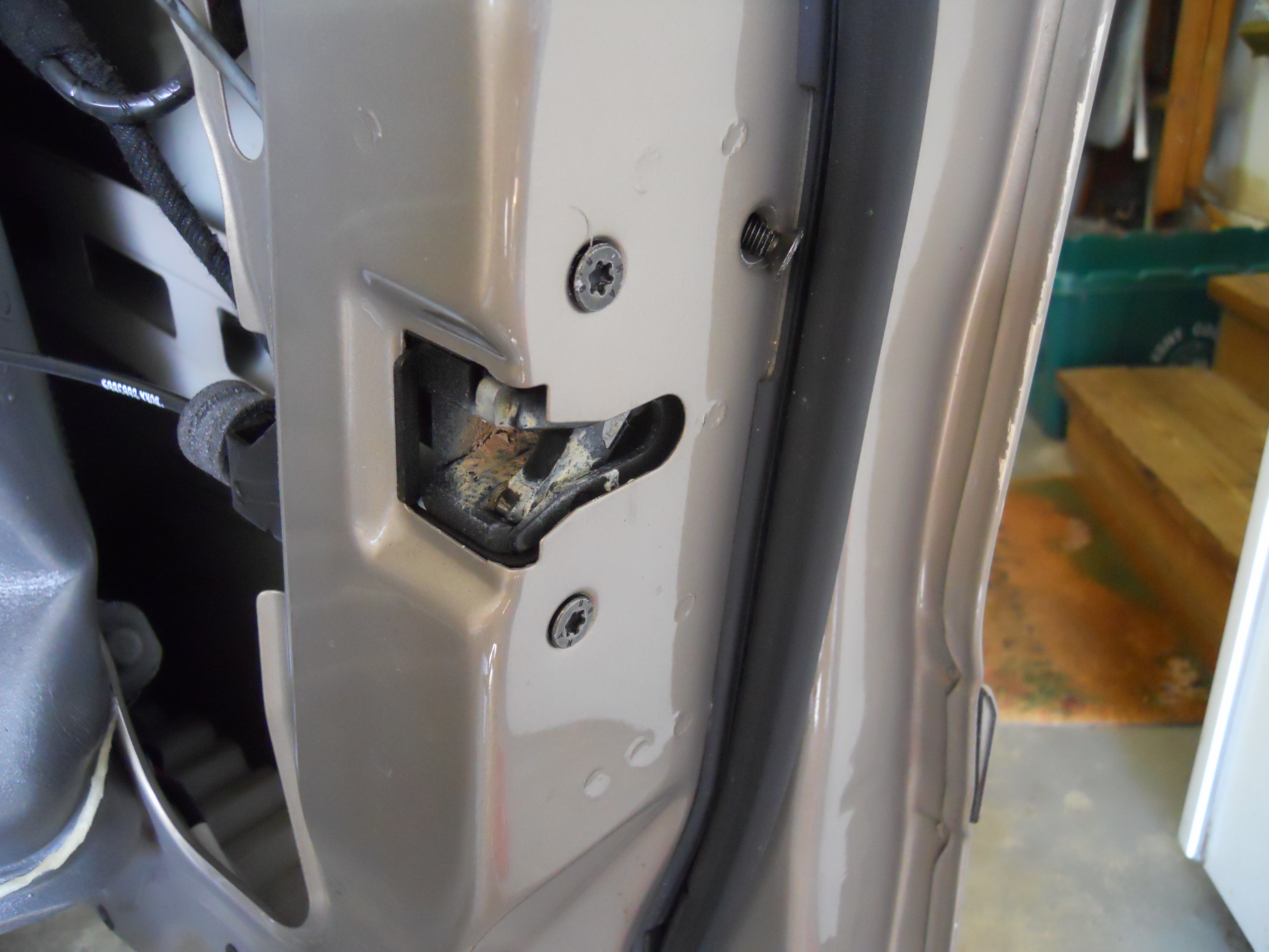

There are 3 torx screws holding the actuator to the door.

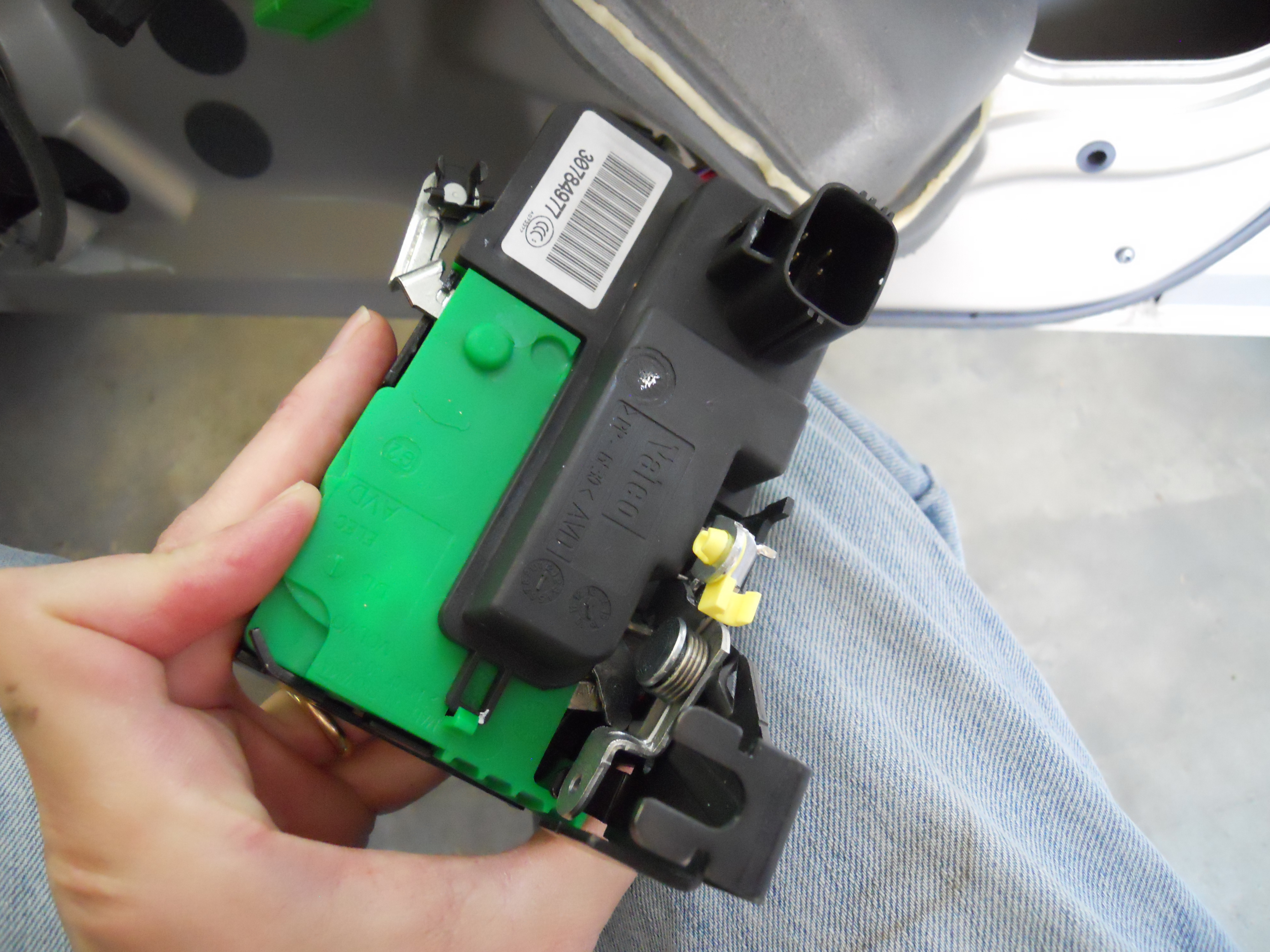

And here is what you are replacing. This is the new one.

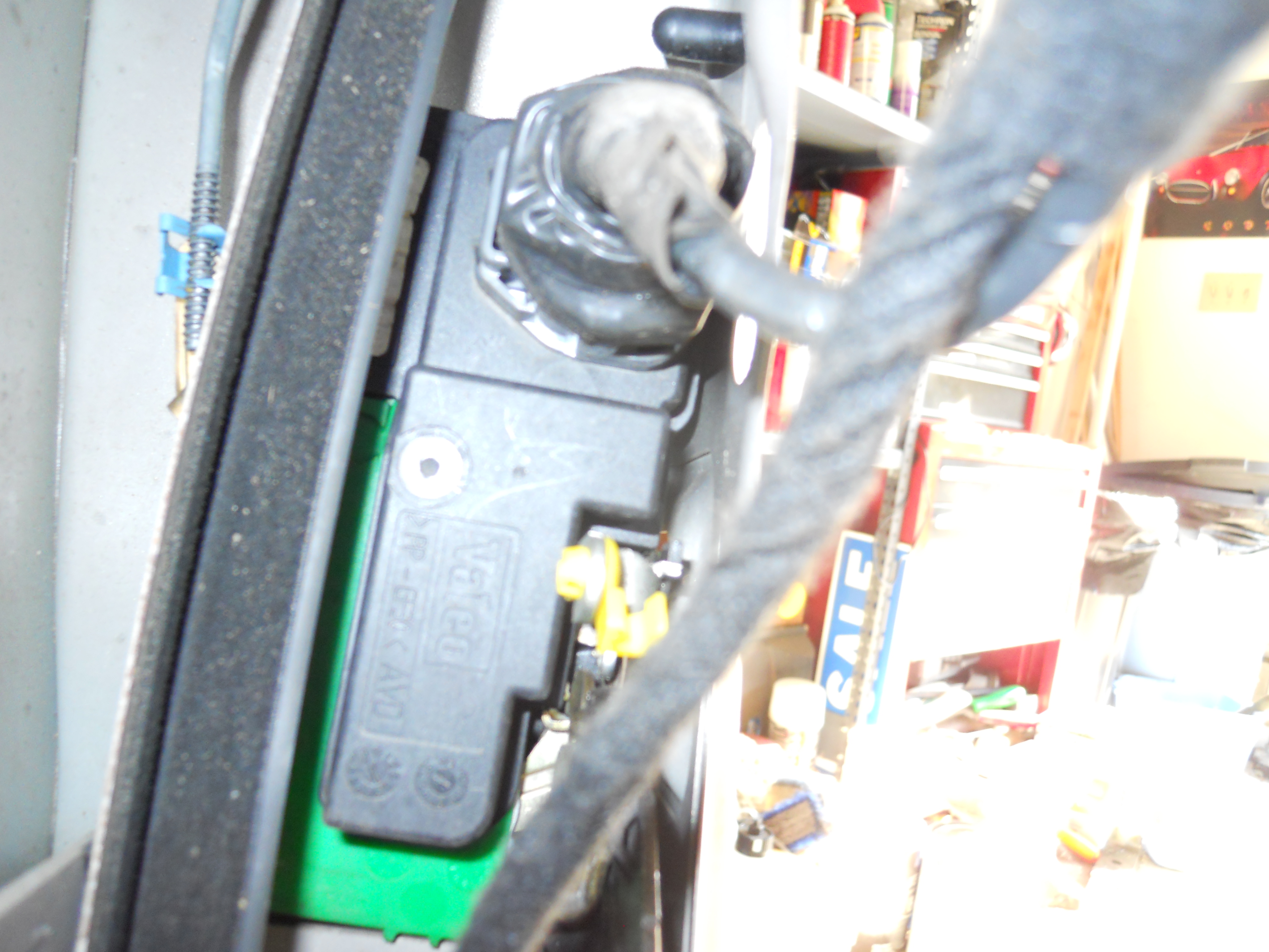

You have several things to disconnect. This is where the job starts getting to be a PITA.

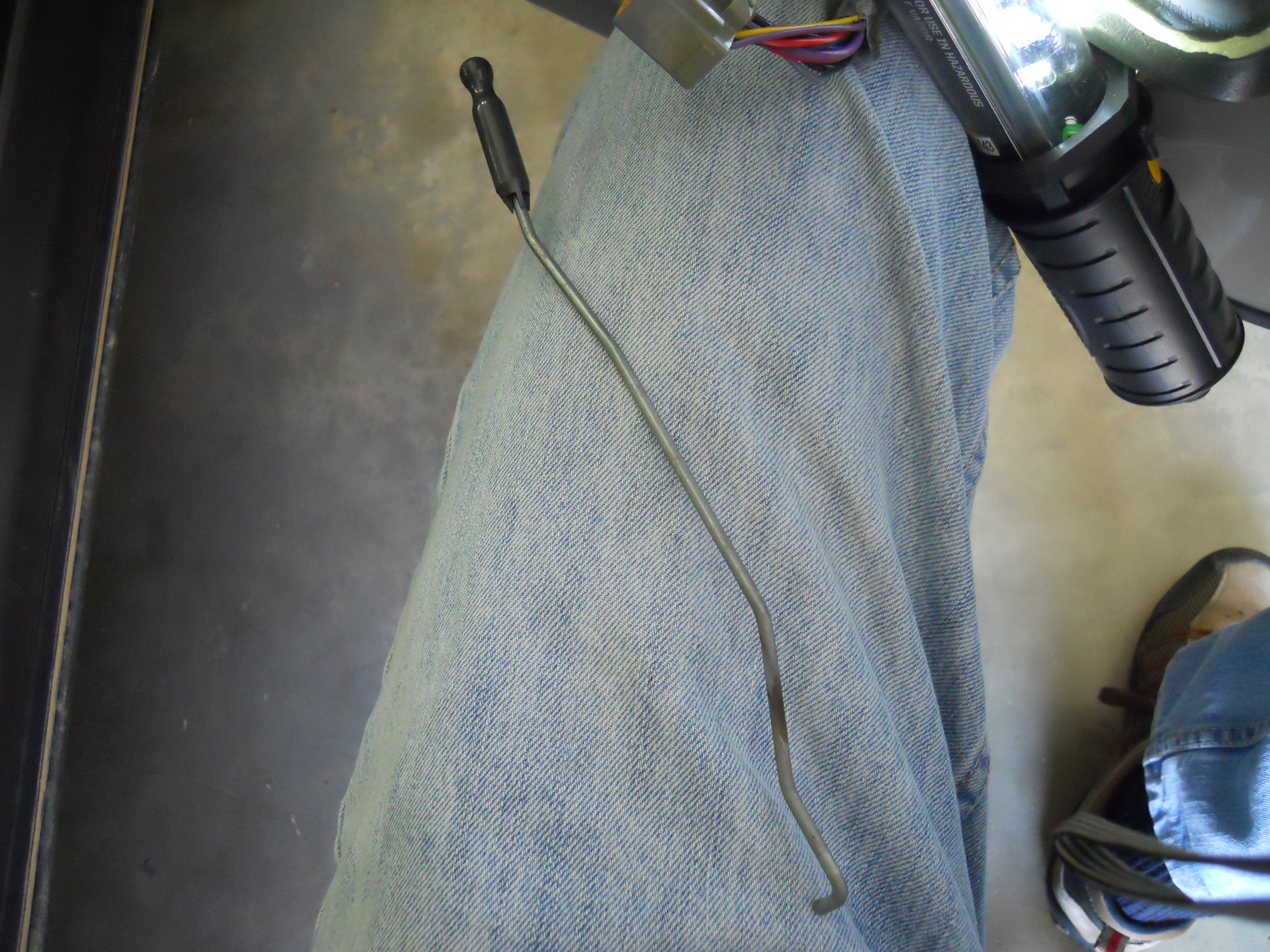

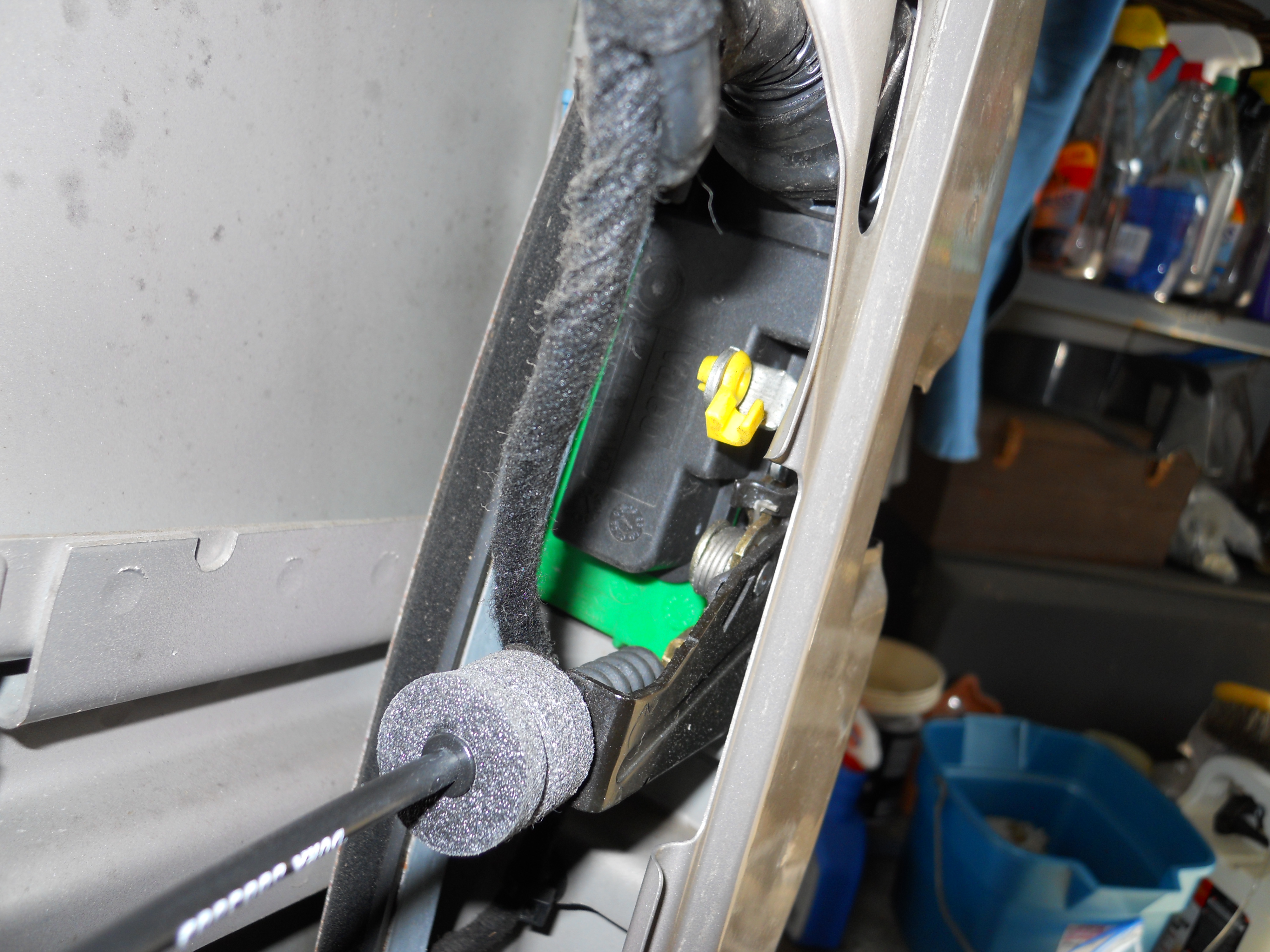

1) The lock rod. This is easy. Pivot the yellow clip and this frees the end of the lock rod. Here is a shot with the old assembly in the car. The yellow clip has been unclipped and the lock rod removed. The rod is below.

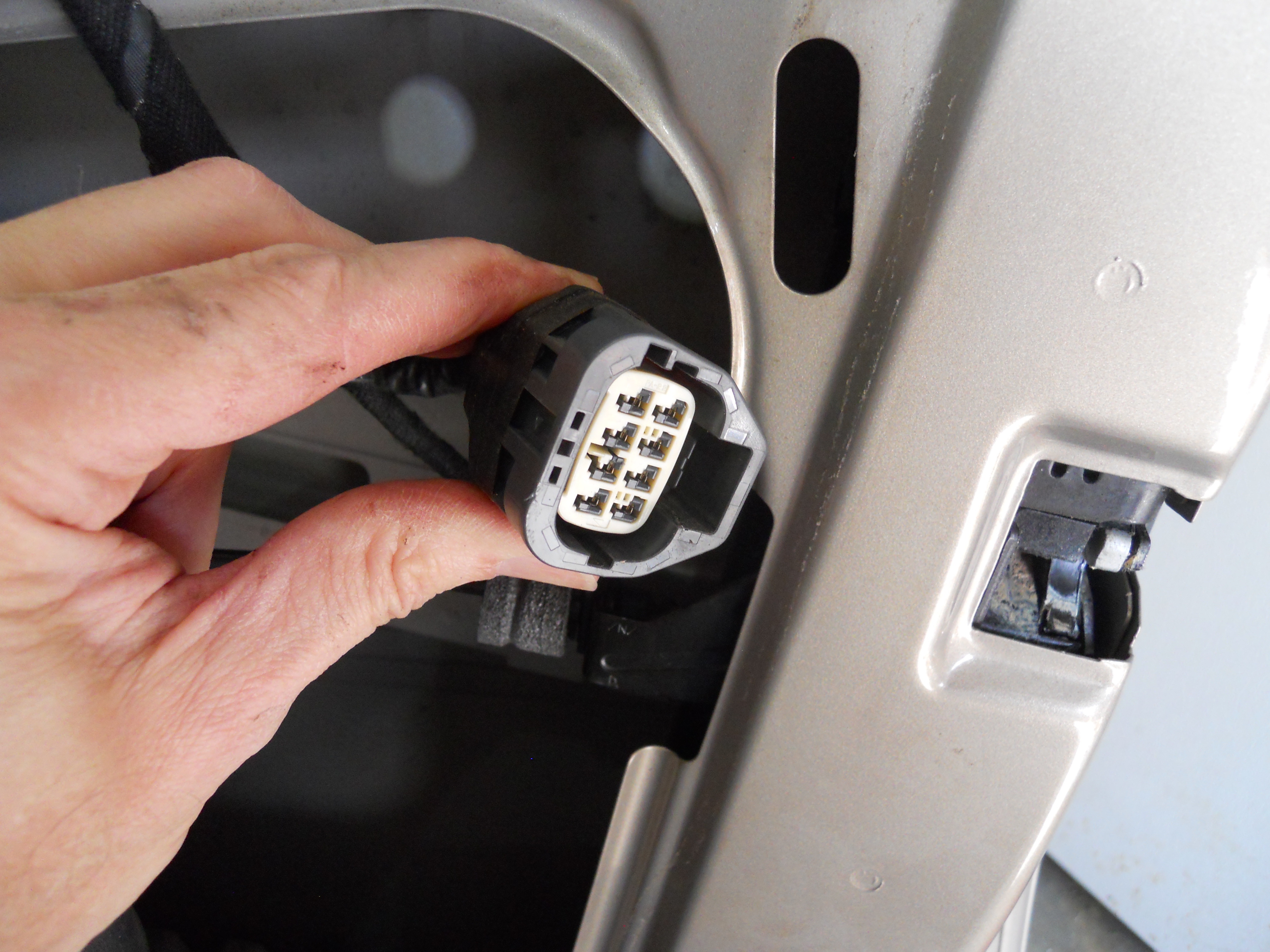

2) The electrical plug. With lousy photo showing it before being removed. Just have to lever it off the actuator using a small screwdriver to get it started.

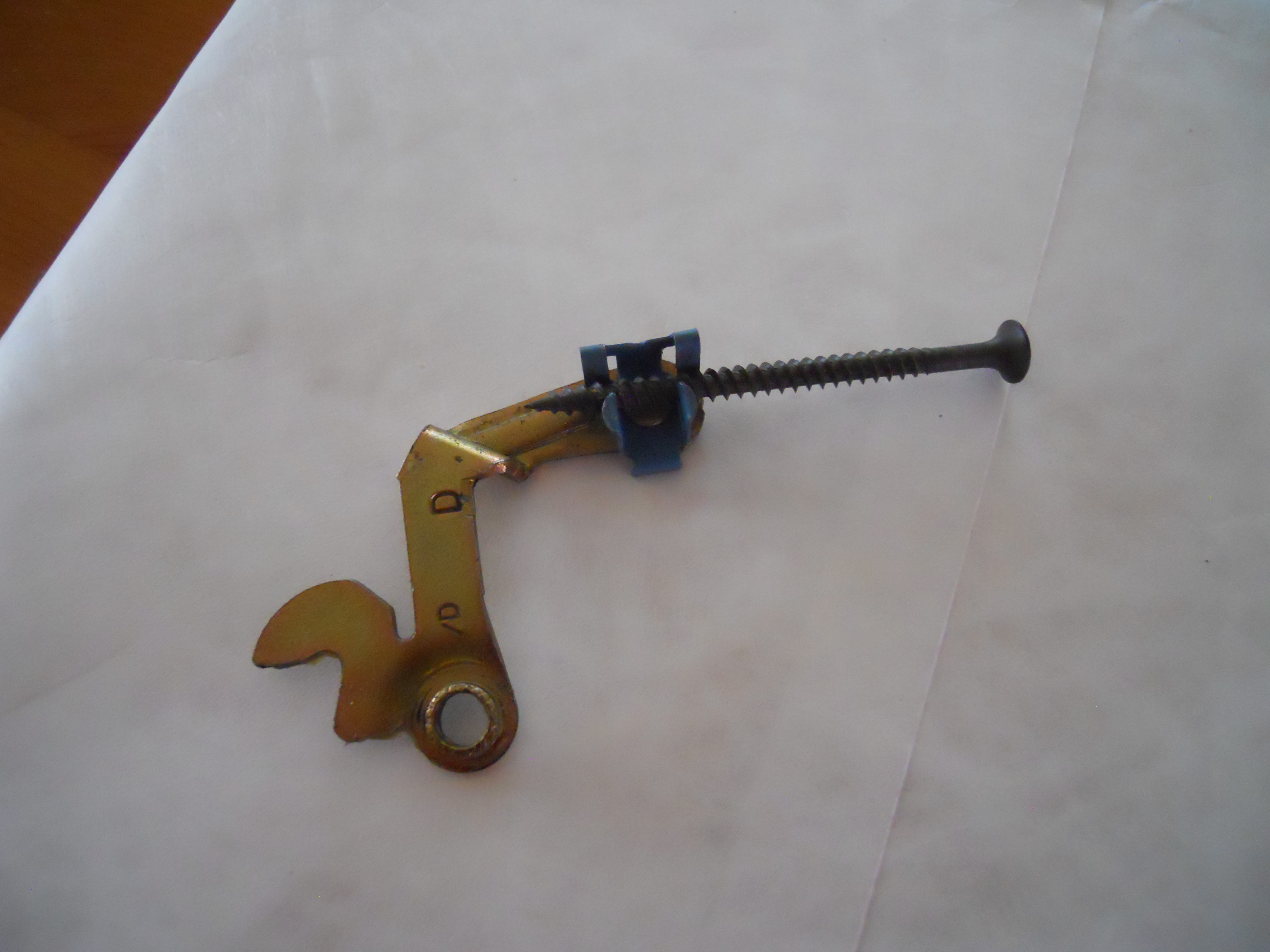

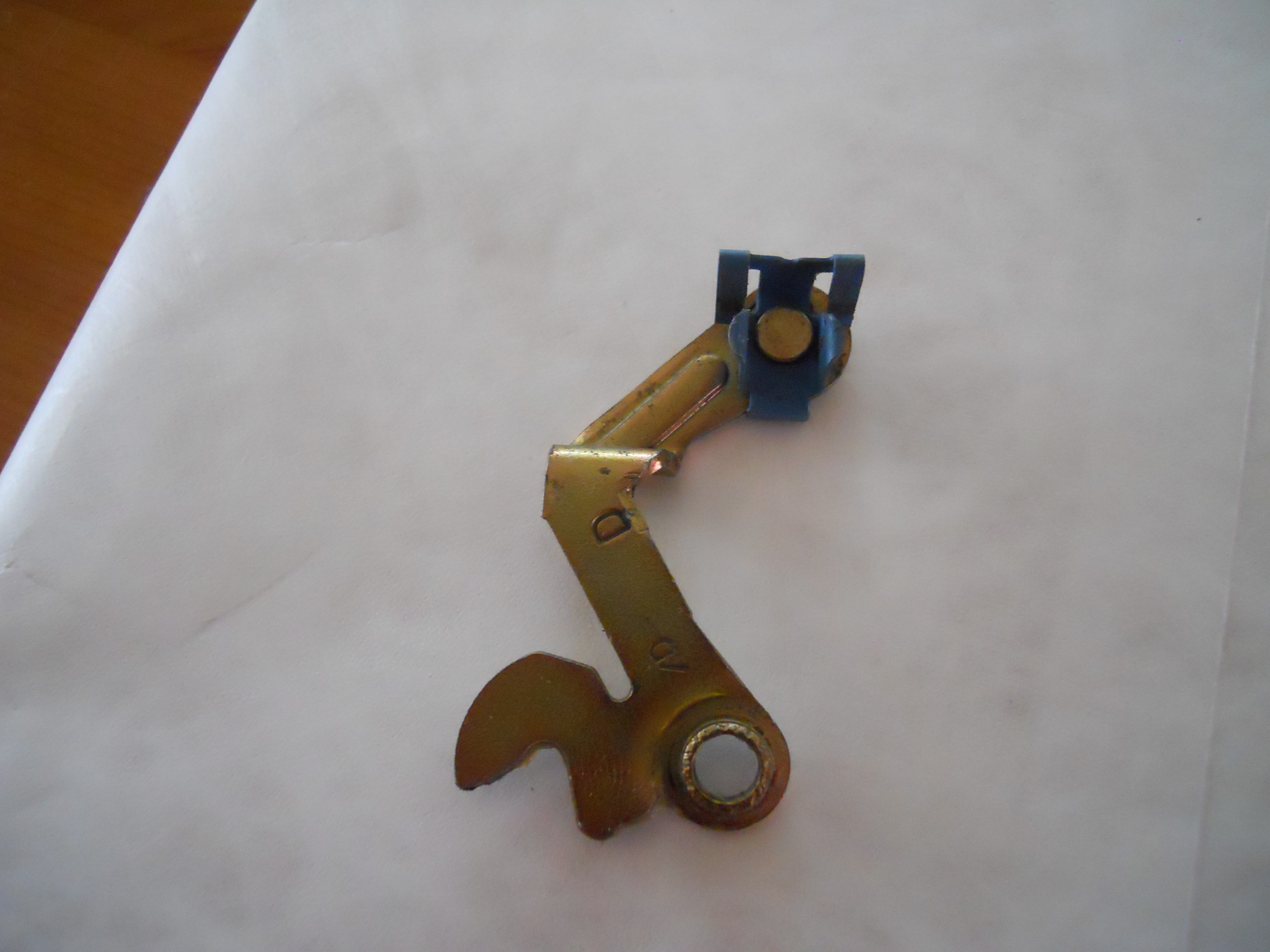

3) The exterior door handle rod. This is a PITA. Look back up at the photo of the new actuator assembly. You see the silver colored arm next to the Part Number sticker? That receives the rod from the exterior door handle. The rod is clipped into the arm in a funky way. Hard to describe, but hopefully you can see in these photos below of the old arm after I dissected the old actuator assembly. The end of the arm is threaded and tapered to a point. The threads just sort of clip into the clip at the end of the arm. I used a drywall screw to demonstrate, but that is pretty much what the end of the actuator arm looks like. The old unit had a blue clip, the new one was black.
Oooh, I just noticed! In the fuzzy picture of the electrical plug, you can see the end of the exterior door handle rod! Perfect shot of this!
I used two needle nose pliers, one to surgically squeeze one side of the clip and the other to pull the rod out of the clip. It just pops out. No unscrewing needed, it just unclips and the threads locate the rod in the right place on the clip.

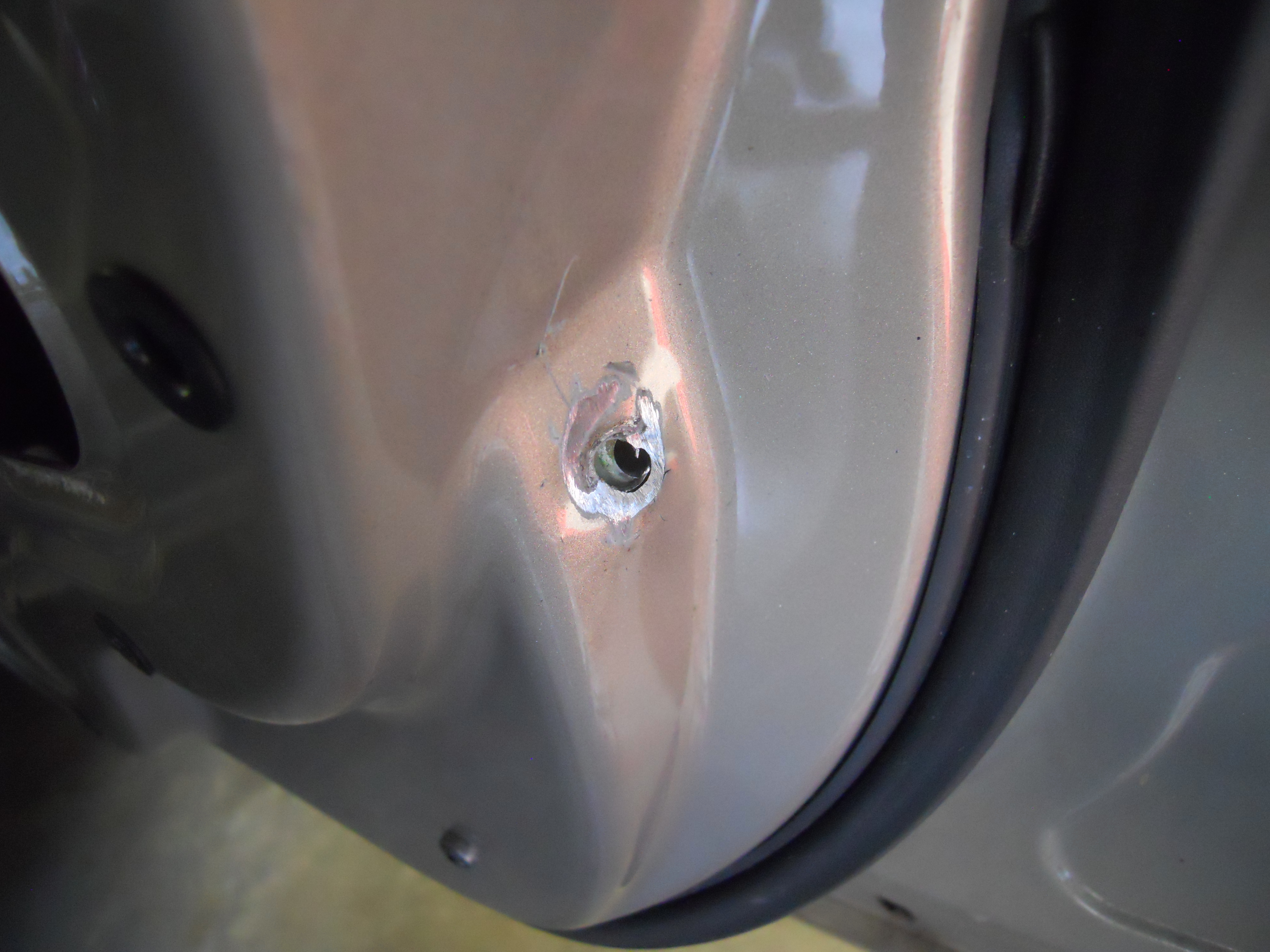

Now the largest PITA. There basically isn’t room to remove the blasted actuator from the door, unless you do one thing. And even then it’s painful. The window track is the culprit. The bottom of the track is riveted to the door. You have to grind off the rivet, to free the window track inside the door, to be able to move it enough to maneuver the actuator out of the door. Get out the Dremel with a grinding stone on it and get busy. Don’t bother to try to chisel the rivet head off. DAMHIK.
Grind it down and punch it into the interior. Now the window track can move a little and with much swearing and oathsaying, and levering with screwdrivers and taking breaks to reconsider your sanity, you can maneuver the actuator out of the car.

And oh yes, the rivet you drilled out. There’s that too. So I have a pop rivet gun, and a million different size rivets. Picked one, applied same, and the end of the track is still a bit loose and rattly. I will probably grind my rivet off, and use a small bolt with some washers next time, when I recover from the alcohol induced haze after this job. And yes, I did prime the interior and exterior of the door which I had ground with the Dremel, to keep it from rusting.
