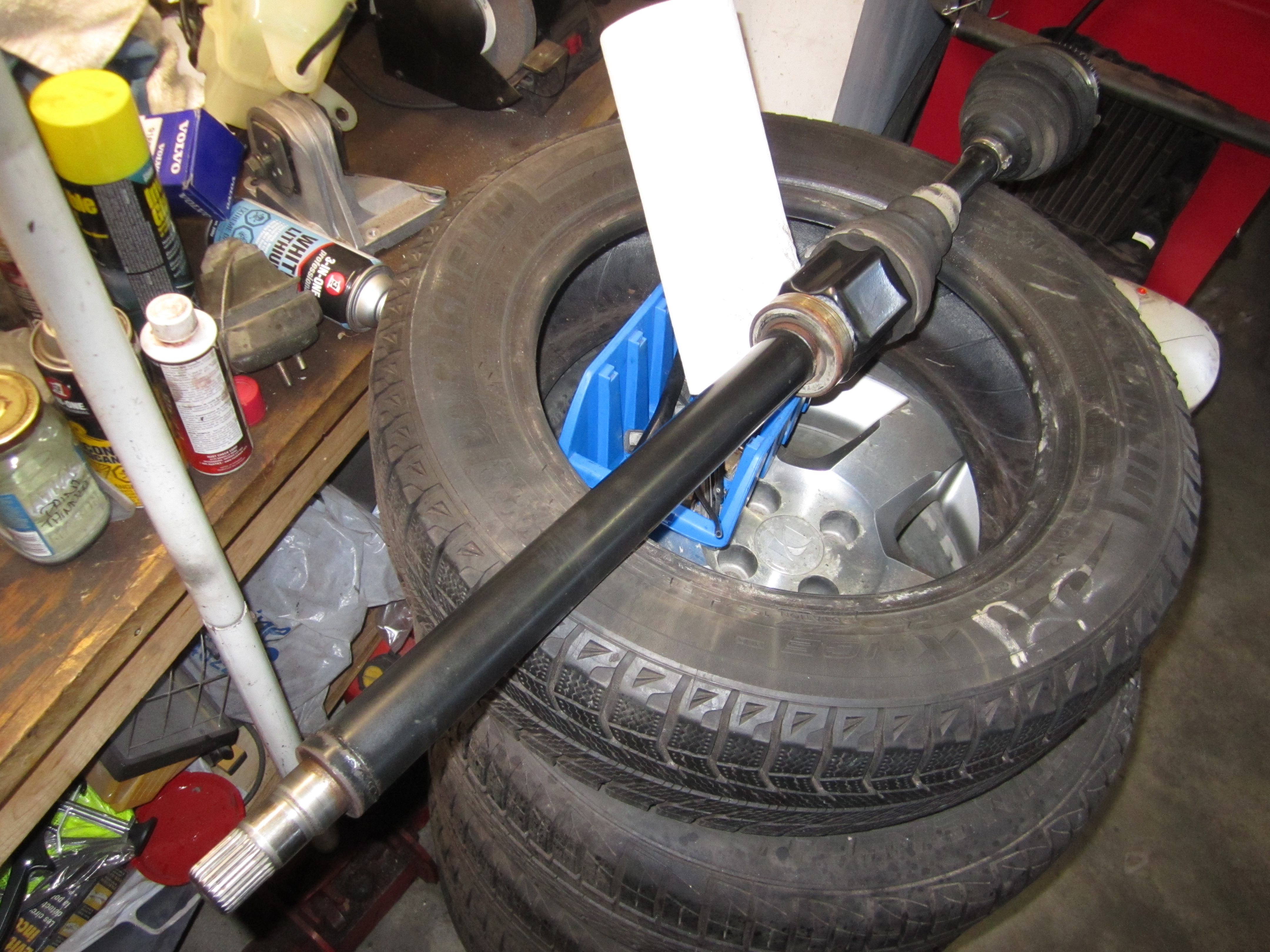

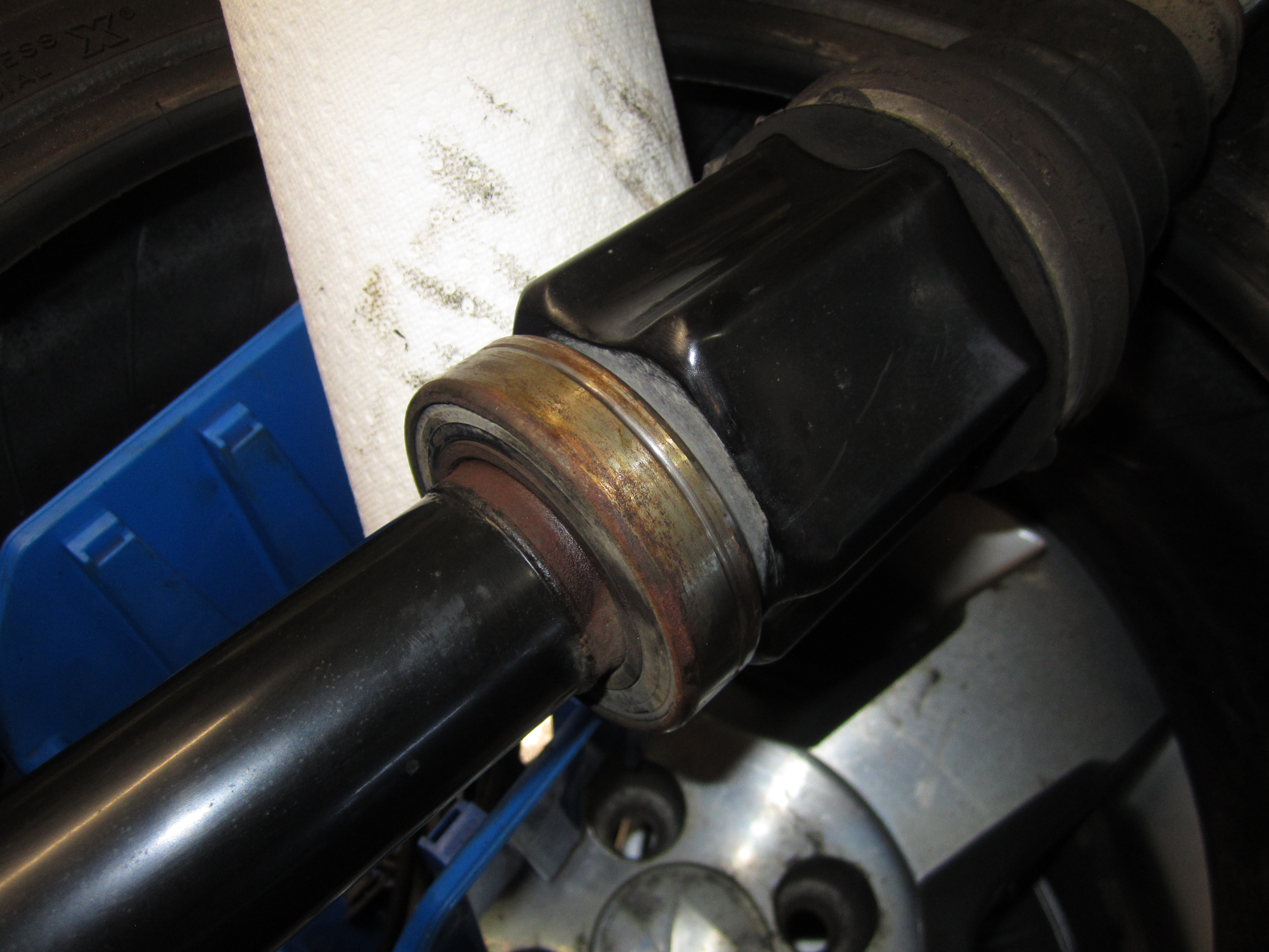

Naturally, any car I own has to have an issue that is difficult to repair as I can't find a how to or even the carrier bearing needed to complete the repair. FCP has a carrier bearing for up to a 98 but can't find anything listed beyond that. Vida doesn't show the part separately either so no part number there.

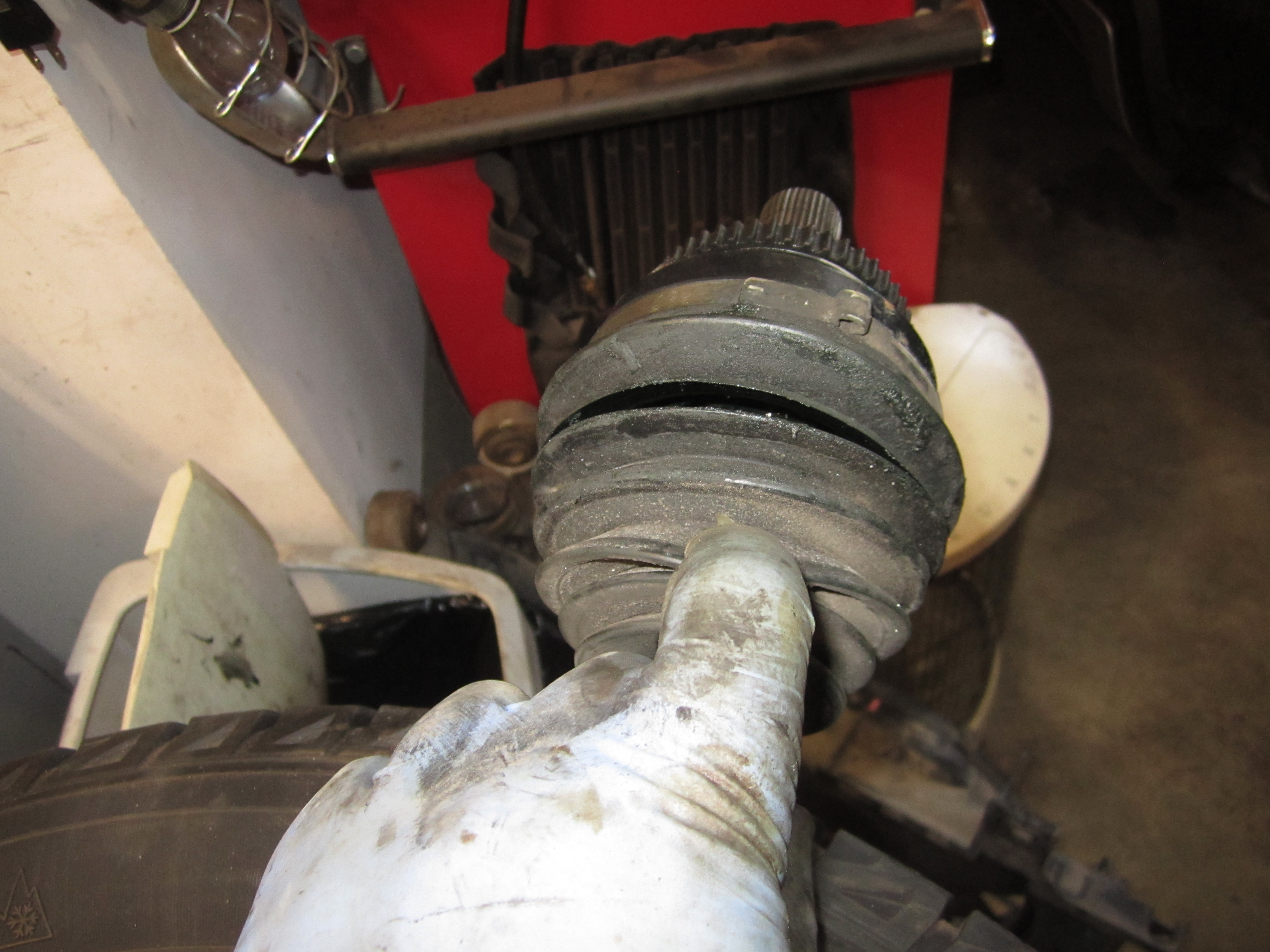

To replace it do you have to pull the inner CV boot and remove all the bearings to access the carrier bearing, or can it be pulled off towards the transmission end? I'm not convinced that is possible as the shaft welds look too high for the bearing to slide over them.
The only other issue is the outer CV boot has split and as it is a Volvo axle I'd rather keep it than fit a re-manufactured item.
I know how to pull the outer CV joint to replace the inner and outer CV boots, but if you have to remove the inner boot how does the axle dis-assemble to allow access to the carrier bearing?

Go to youtube and search "axle support bearing", you will see some videos using dremel (or angle grinder) to cut the old bearing out.
Installing new bearing (make sure you get quality bearing) is easier, just slide it down, tap equally on all sides (tap ONLY on the INNER race part) bit by bit.
The bearing PN should be right on the bearing itself.

Thanks for the thread info and Youtube link. The Toyota axle looks almost identical. Only part I am not sure on is the fact that the bearing slides to the inner end of the axle at the transmission end as there is a welded seam just inward of the bearing and it looks thicker than the bearing I/D.
The bearing is super expensive (approx. $150 + US or about $200 +CDN). I looked into the Febest brand listed but everywhere lists it as un-available. Did find another brand in the UK for about 16 pounds. May look at picking one up when I go over in a few weeks!

Go to ebay and search "45x75x19 Bearing", you will see one from Turkey for $12:

I used the link that cn90 gave and ordered one of the bearings out of curiosity. The bearing is used by Ford on the Transit and Fiesta from the info on the manufacturers website and used as a carrier bearing. The manufacturer is Dutch and have a good name.

Gopher Bearing in St. Paul, MN has a 45 x 75 x 16mm bearing. They quoted me ~ $45.00. They don't typically supply automotive bearings but they do tend to carry a good variety and can match by dimensions. You probably could use a 16 mm wide instead of the 19 oem. For others in the s.w. Gopher also has a branch in Texas.
