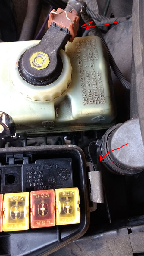

2. Disconnect the brake pressure sensor electric connector, disconnect the (brake fluid sensor?) wire on top of the master cylinder. And move the relay box away. The extra room will be welcomed!

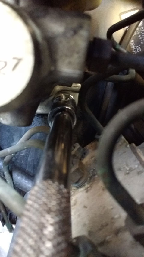

5. Crack the brake lines with a flare nut wrench. I used these great little Gearwrench Metric flex flare nut wrenches. The 11mm worked great. It flexed just enough to allow me to crack the nut without banging against the reservoir. Here's a picture of when I installed the new (wrong) master cylinder. I wouldn't remove the lines entirely until the bolts are removed so you can try to quickly remove it and quickly get the new master cylinder in there.

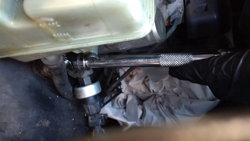

6. 13mm flex sockets will be your friend. Along with a six-inch extension, and a flex head 3/8 ratchet it's pretty easy to crack the bolts that secure the master cylinder to the brake booster. There are two bolts securing the master cylinder to the brake booster. I'm sure you could do this with short sockets and wobble sockets, but ever since I started using flex sockets stuff has just been so much easier. (I recommend a set of Metric Gearwrench Flex sockets.) NOTE: the napkins here are NOT ENOUGH.

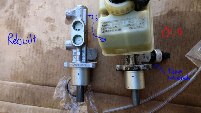

7. OK, wiggle the old master cylinder out. It'll come out pretty easily. Try not to put to much stress on the brake lines. Once you have the old master cylinder out, swap some stuff over: take off the sensor with a 14mm combination wrench and disconnect the brake fluid reservoir by removing the T25 bolt that secures it. There are two gaskets that press into the master cylinder. They looked fine so I left them. I don't have any leaks right now so things should be alright...
