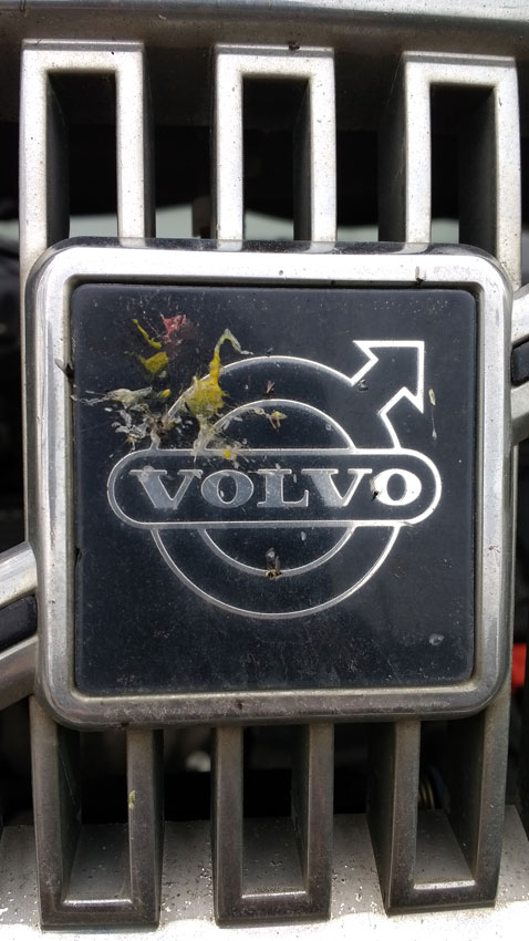

Did a drive up to Montreal for a wedding this weekend. Then drove down to the Jerse and then back into Queens...
This was our first trip, post-airbox mod, 89 Octane all the way, one tank with 4 oz of Lucas...I also got an alignment the morning before the trip after swapping out the control arms and changing the sway end links.
We averaged around 28 mpg... hit speeds of up to 85mph. (But kept the car mostly around 70mph the whole drive). For all you N/A folk out there, if you haven't gotten around to doing the airbox mod, what are you waiting for??? Our car now has pep at 65mph+!!! I'm not going to lie, if boost feels anything like this, I might be sold...
Many thanks to all of you who've helped me get to Stage 0.00003!! Now I need to rinse off the car tomorrow... :lol:
