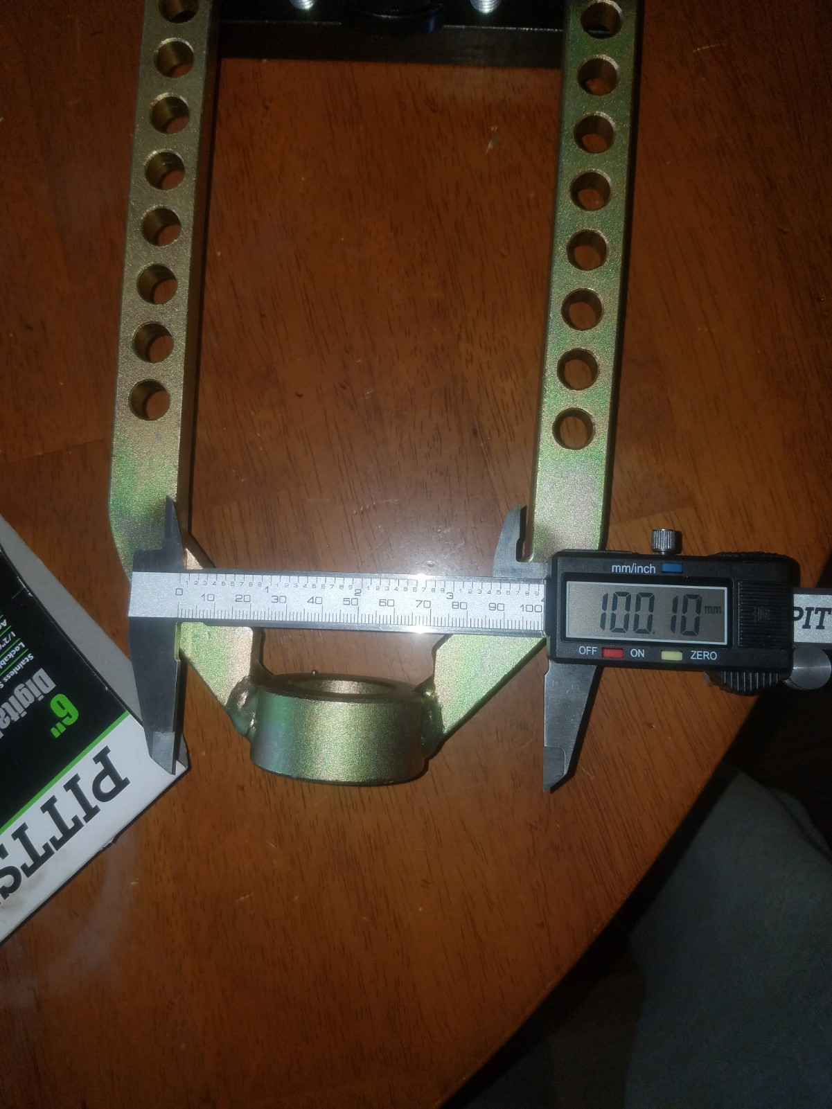

There are a bunch of these to choose from on eBay but choose carefully, make sure to get the tool that specifies the inner diameter is 100 mm, like the one cn90 showed a pic of.
Some ads say 100 mm, some say 95 mm, some don't say anything. Given that the turbo outer CV has 92 mm diameter, the 100 mm tool might be the best choice.

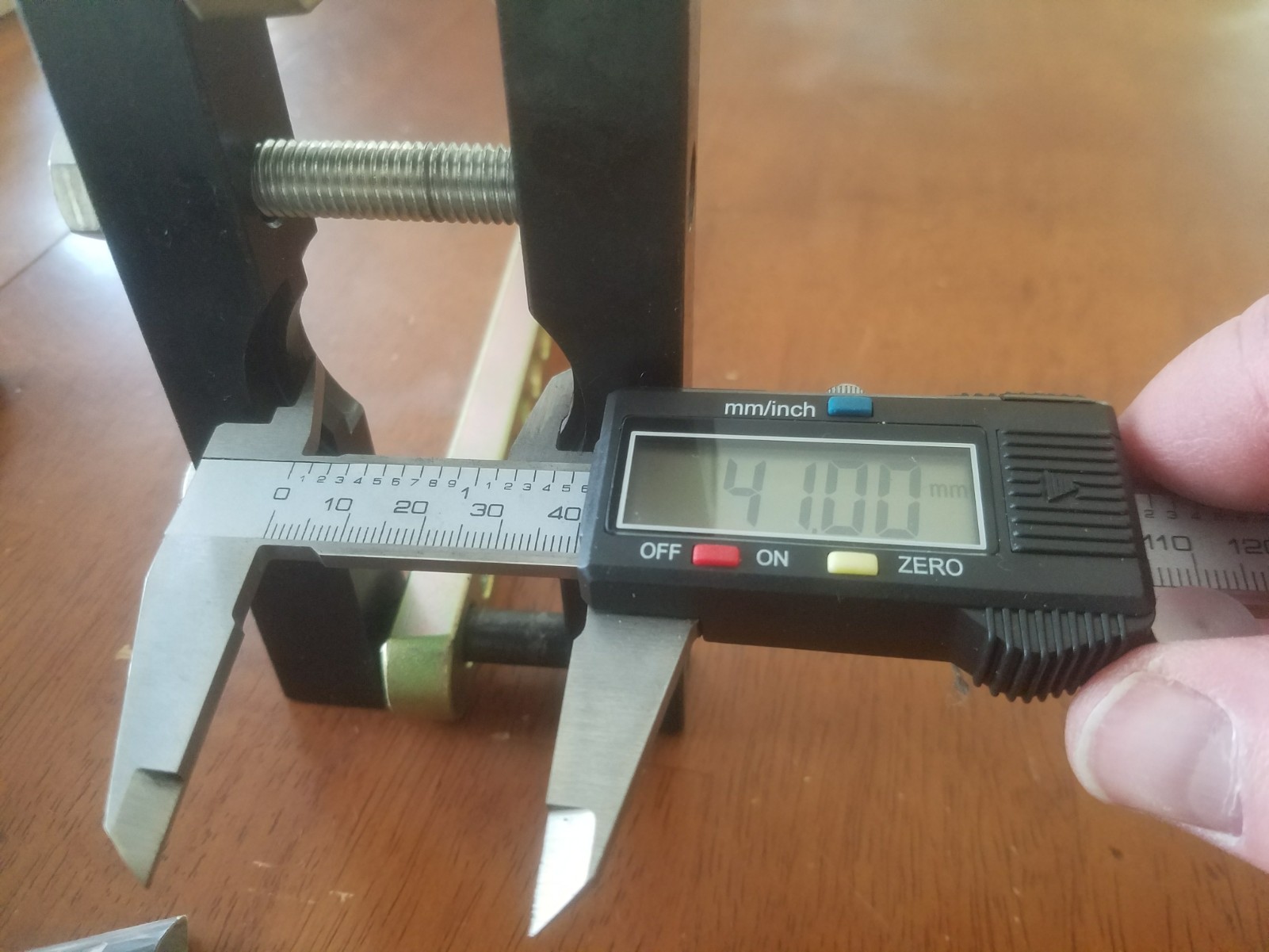

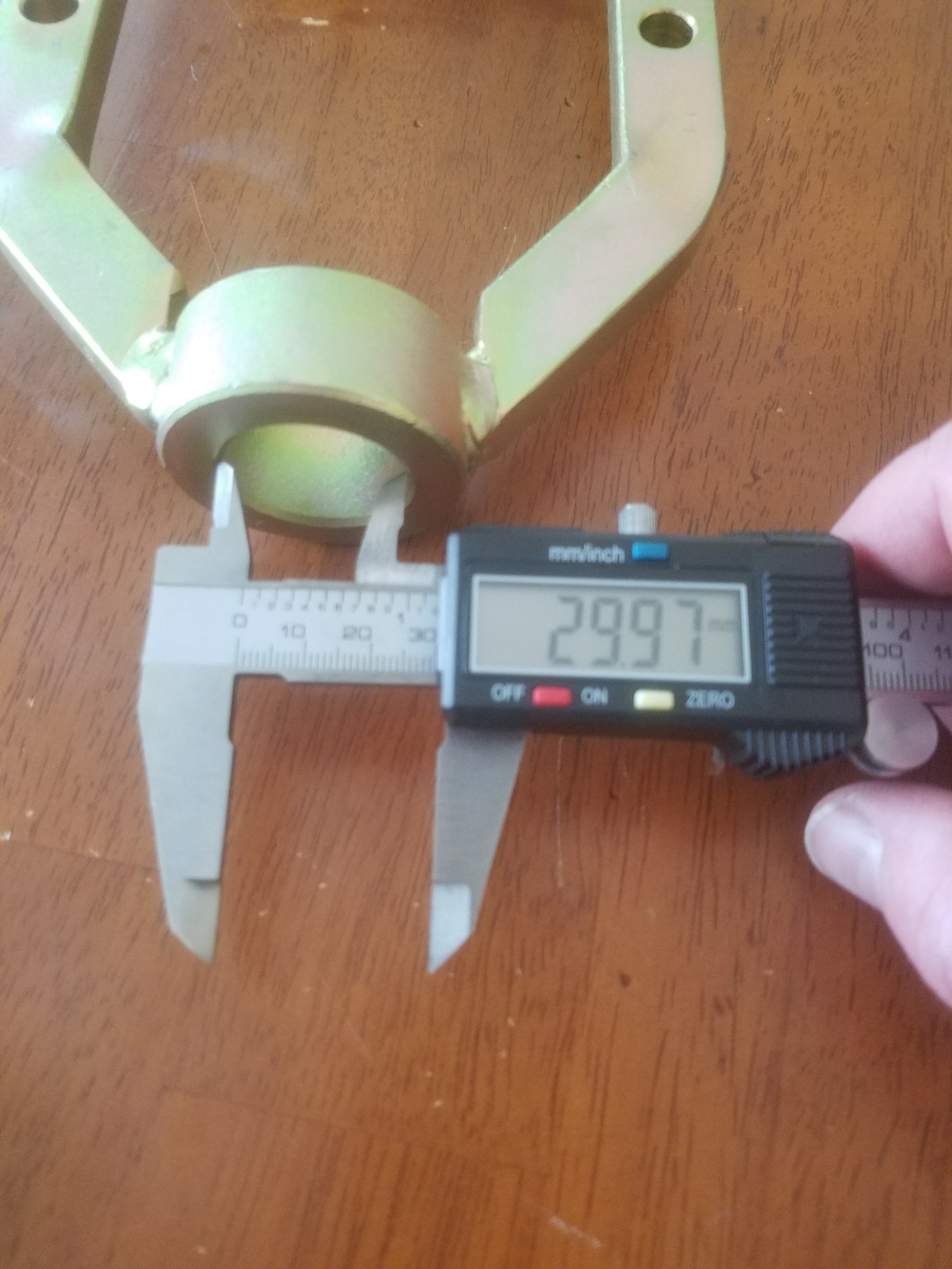

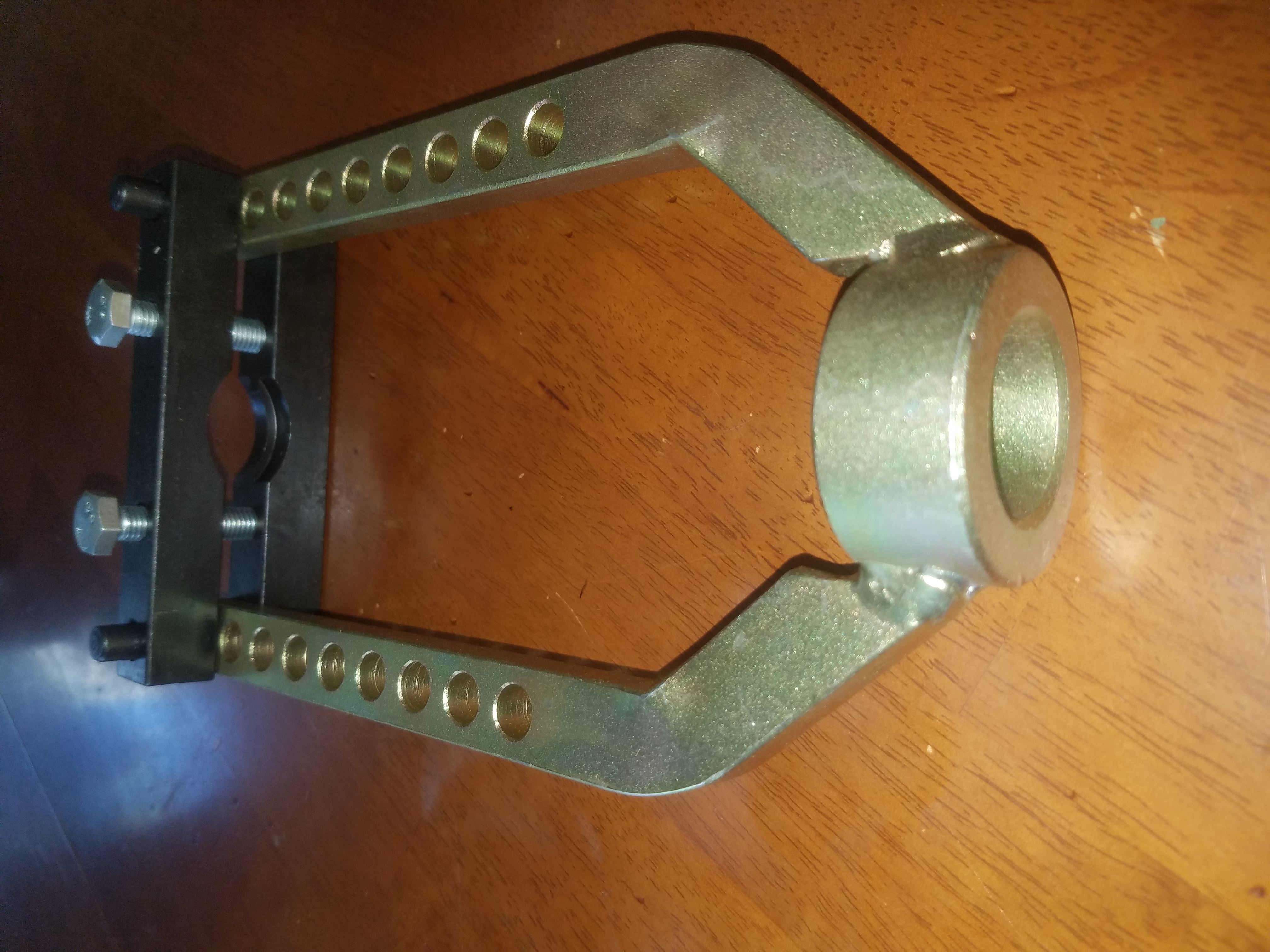

I had a humorous exchange with one of the ebay sellers:
I asked if the internal diameter was 100mm on the puller being sold, he quickly replied & said no, sorry- he measured it to 9.99cm.
I bought it.
I bought it.

Once you receive the tool, could you post a photo with measurements (just to confirm what they say) and also the name of the ebay seller?
Thanks!
Thanks!

Will do, it's being shipped from NorCal, so I should have it shortly. I'll post up a pic with measurements.cn90 wrote: 28 Apr 2017, 18:37 Ha,
Thanks!
