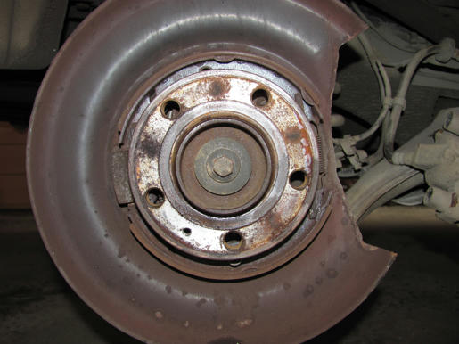

During the last few days, driving my car at 45mph or more I could feel the car vibrating.
Slowing down it disappears but when I stop the car, lots of reddish dust and heat comes out of the rear right wheel.

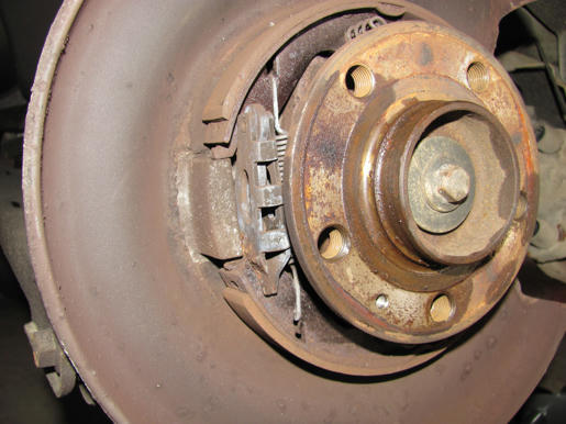

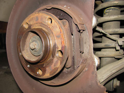

I have just removed the rotor but I do not see anything wrong with the parking brake shoes and relative springs.

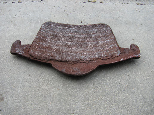

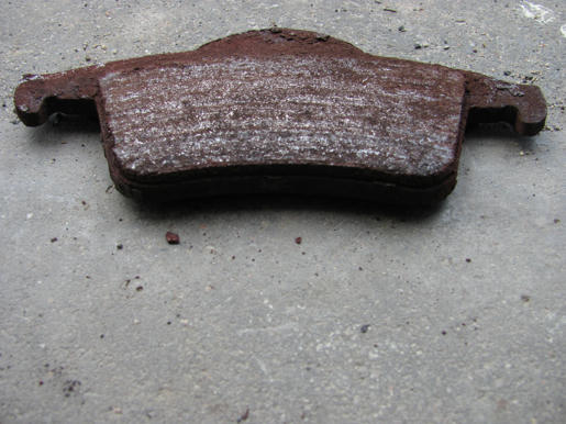

However, I found the pads to be completely gone and with uneven wear, but still I cannot understand where the heat and the red dust is coming from, unless you tell me it is caused by the friction of a completely worn pad with the disk??
How about the vibration with the speed then??
Could it be the wheel hub which is creating the vibration above 45mph and the uneven wear?
Please take a look at the pictures:
Thank you for your help!
