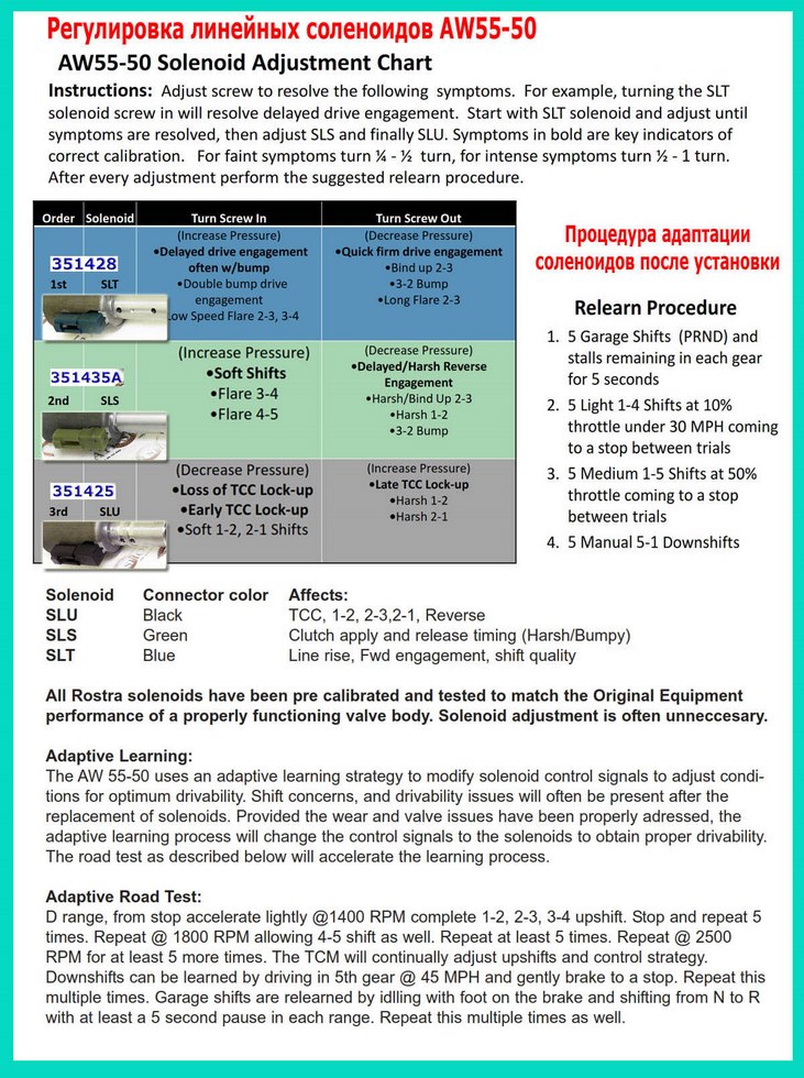

I show a little how the relearn procedure works at the end of this video. In short, the transmission needs to light the triangle for each up-shifting and downshifting, so in total it has to learn 8 shifting points. Only, it can take many tries to make it learn one or more of these shifting points. Remember to do this repair ONLY in summer time.
Note that I kept the my original valve body and only did replace the solenoids with new ones. I do not recommend trying to 'refurbish' the old solenoids.
And I have to say that in my case the results are not perfect. The shifts are a little bumpy when cold, but perfect when warmed up with a few exceptions (when I hard brake to a stop on a downhill I get a transmission kick). Either there is some wear in the valve body or the new solenoids did not had the same adjustment as the original ones - Volvo says the original solenoids are adjusted to match each valve body when the car leaves the factory.

I tried replacing solenoids with "pre adjusted" ones and can say this is complete BS. So I found a way to service (or refurbish, or clean, etc. whatever you call that) original solenoids without opening them up. It helped, but I guess re-learn is still required.

The only thing I regret after the solenoid job, is not measuring the adjustment on the old ones and check the one in the new ones. It would have taken 5 minutes. Rostra says they are all adjusted the same, but I have a little doubt.

I would recommend trying the suggestions above (I also put in the video the whole Vida procedure - in the video description), then for the other gear changes that had not adapt this way, really go with your feeling, try plenty of variations of acceleration and slow down. I can say, count at least 2h driving in an area where you can reach a good speed, and obviously without much traffic. I'd also keep in mind that replacing only the solenoids, does not mean the rest of the transmission is new. These adaptations are meant for at least a complete valve body replacement, so replacing only the 3 main solenoids may well mean that some shift points will not be learned quickly by the transmission, no matter what. I would not worry, and do the best with the adaptations, then just drive that car normally every day. The best is to drive the car inside the city for a longer period to get the transmission to do often times gear changes (driving on highway for long distances without a proper adaptation may not be that good for the transmission). The transmission will slowly adapt by itself, after a longer period (perhaps several months or so). The idea with the adaptations is to 'help' the transmission learn faster to work with the newer parts.
