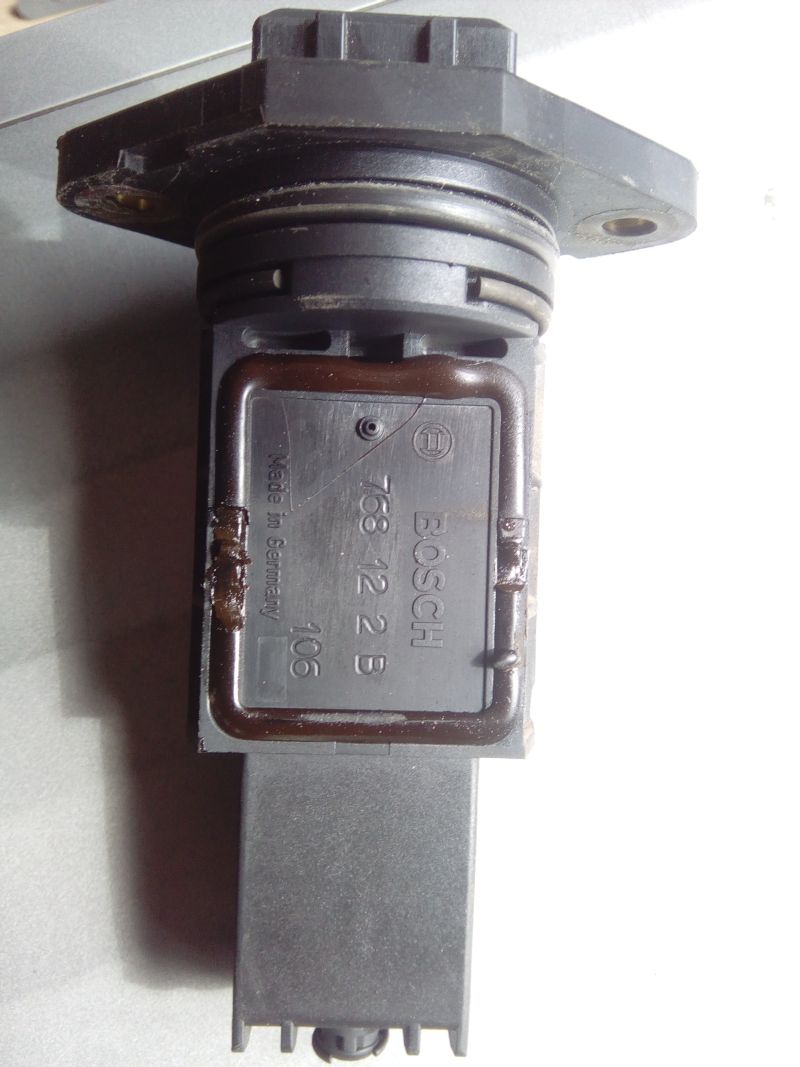

But after taking it apart, it has a different bosch partnumber.
Even though it came from the same engine: the b5204t
Does anyone know if these still do the same?
I once found a pdf with all the bosch mafs.. But I cant find it anymore.
the part numer is: bosch 207 02 1 A and then 105
Mine is: Bosch 569 29 2 B 103
I hope it could work, since it looks brandspanking new... ;)

ah its a 6 at the end not a 5..
So bosch 207 02 1 A and then 106
And its from 2012. And my old one from 1995

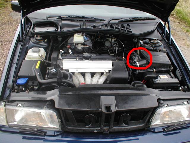

'92-'95 Maf sensor:
850 engine bay 2.jpg (67.93 KiB) Viewed 3724 times
'96-'99 Maf sensor
850 turbo engine bay.jpg (135.49 KiB) Viewed 3724 times

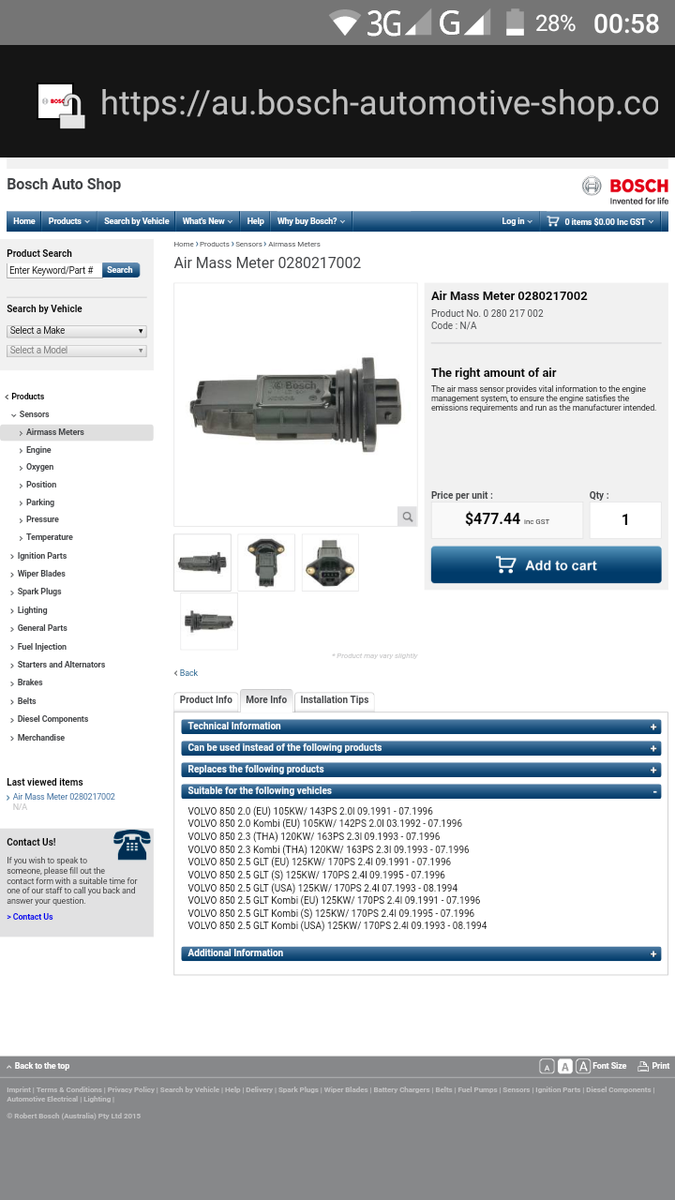

However,i believe that MAF inserts are the same for both,earlier and later 850 along with s,v,c,xc70 up to '99 and that insert part # is Bosch 0 280 217 002,
but you would need to remove it from it's housing,read the Bosch number and search by that info.
If you search for '91-'95 Maf sensor you would get JUST an insert from both...Volvo dealership & Bosch.
If you search for '96-'99 Maf sensor ,you would get it along with it's housing ONLY from both...dealership or Bosch.
Every Bosch part have 10 digits part number.For example 0 280 xxx xxx,or 0 260 xxx xxx and those numbers you provided means nothing.

After a bit of research i found this:
I would be interested to find out are they really interchangeable or are they totally different parts.

Perhaps, I was not quite accurate, English is not my native language.
Inserts for Jetronic and Motronic are different! They have the same dimensions and connector, but their characteristic maps are completely different, so they are not interchangeable.
You are right, 0 280 217 107 is a number of MAF assembly. It incorporates this:

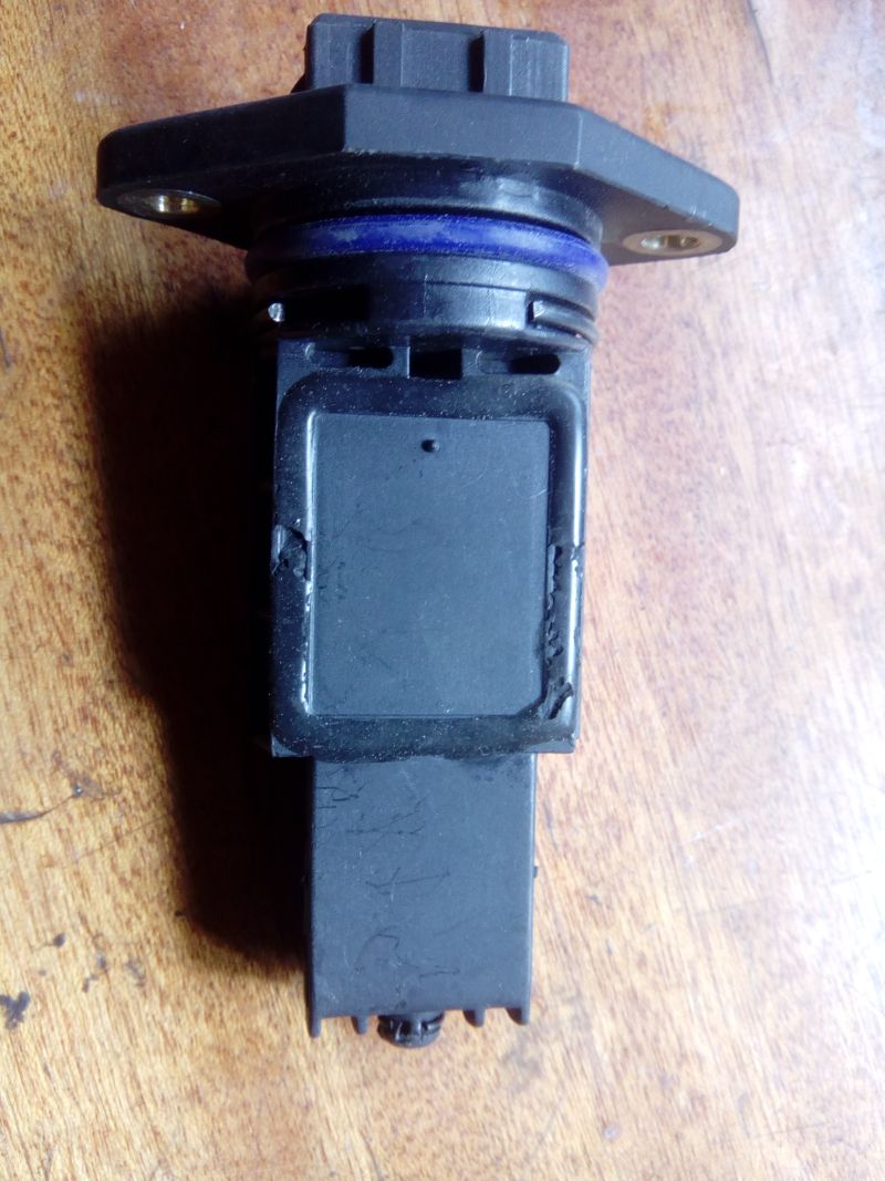

And this is chinese one, without any marking on it:
Use this, if you're bored and need some buttheart :)
